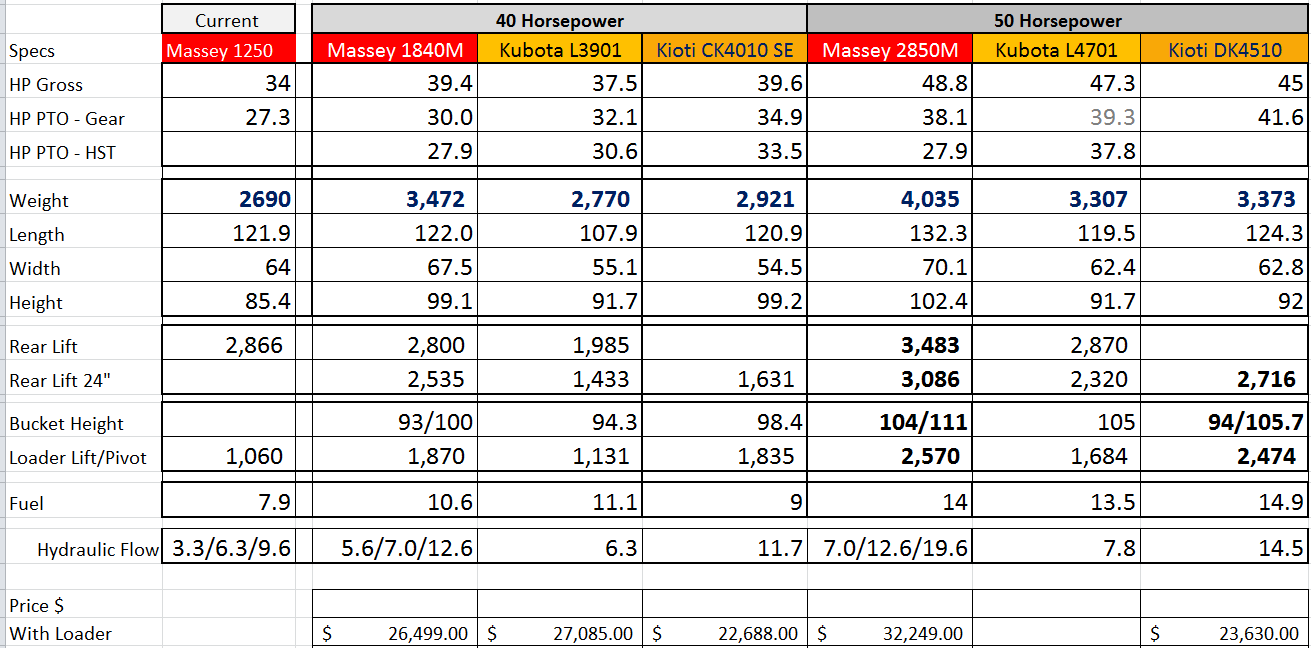

De nada. I have a giant spreadsheet of specs on about 45 35-60 HP machines from 9 manufacturers in various weight classes. I've got almost 20 acres of mostly pines to manage. I want the SS transmission, but these all have both as options. The hard part right now is finding one on the lot to test drive.
I would love it if you would share that spreadsheet...It can be so hard to compare machines without it
Kioti has a useful “compre models” function but, as far as I know, you can only compare kioti models, not kioti to another manufacturer...I usually do that with Tractordata
/ 45-50hp Help #86
Here is one I did earlier this year. It originally had more tractors but I dropped out the ones that didn't make the cut.
