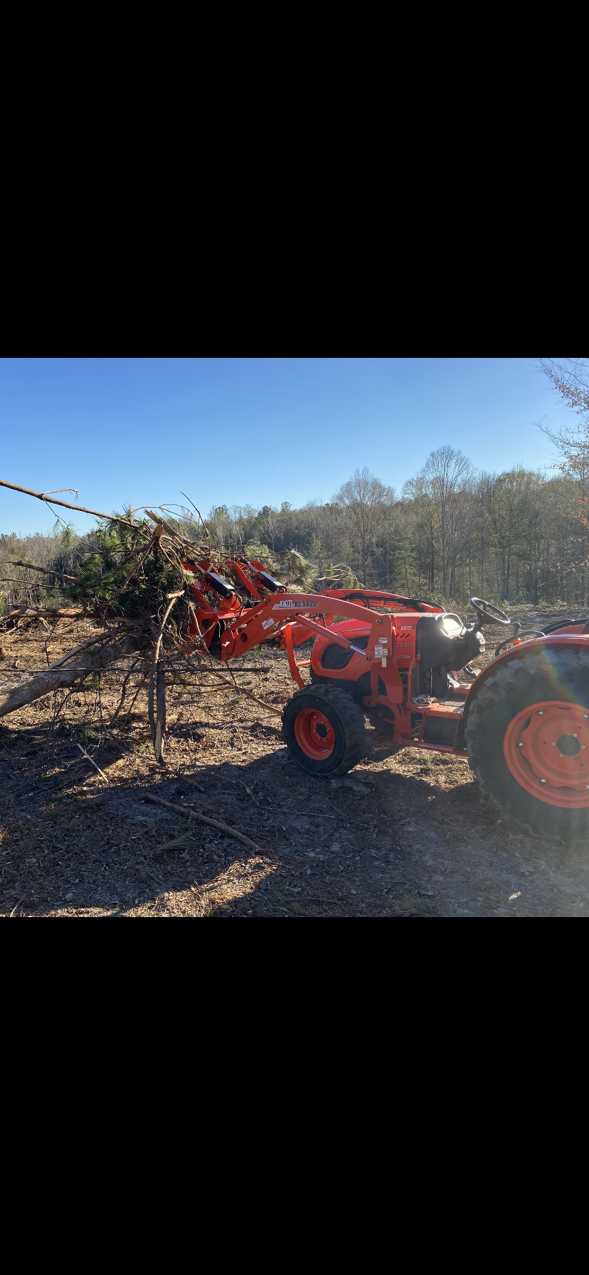

Cleaned up around 15 acres with my dk4510 and a grapple after it was clear cut. Made another pasture. Worked the little tractor like a borrowed government mule. There’s a pic of a mouthful of limbs.
