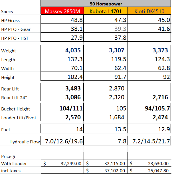

I was looking for about the same class of tractor earlier this year, eventually came down to Massey 2850M or Kioti DK4510/DK5010. The $10k difference in price tipped the scales toward the Kioti. I have been very satisfied with that decision so far. I had looked at the Kubota L4701 but the other two had better specs for what I was looking for and just seemed better built overall.

Does the DK 4510 come with hst?
/ 45-50hp Help #32
No it doesn’t. Kioti has a DK4210SE that is hst. 39 pto hp. NS4710 HST with 45 pto hp. Then they have the NX4510HST with 33 pto hp. Dk series is wntey level. Then it steps up to the se, ns, nx, then rs if you’re wanting a bigger tractor then another level. Not sure what it is.
I have the dk4510. I’m pleased with it. We run kubotas at work. I like the kioti better than the botas. Kioti has a great dealer where I’m from. I’m not trying to sell ya a kioti but for the money you get a lot more for a lot less.

Sorry, like I said, I don't want HST...the nearest equivalent to the DK4510 is the DK4710SE. The HST draws down PTO HP, so you want to go up, not down with the engine HP, even the 5310SE has less PTO HP than the 4510. The SE weighs about 150 pounds more. The 4510 and 4710SE have the same engine.
