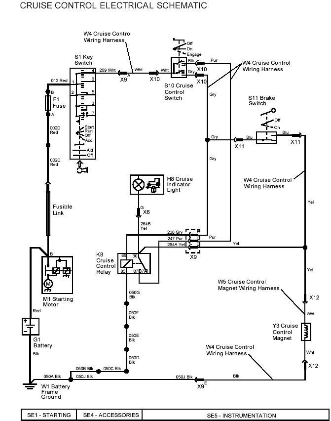

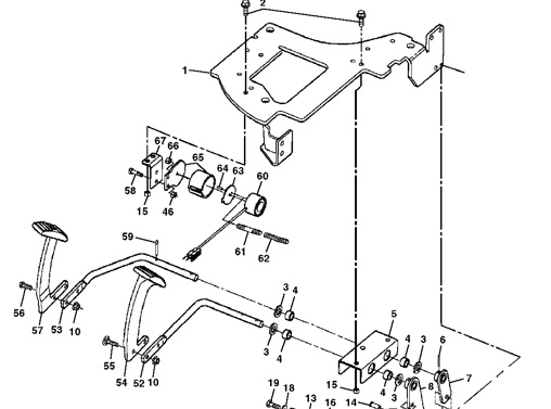

I'm having trouble with the 4400 cruise magnet (60). I've seen a couple posts with the same problem and not much follow-up solution. The magnet holds while the switch is depressed, and the magnet quickly lets go when the dash switch is released.
I've removed the cast pedal (54) and shined away some corrosion with an emery cloth. That didn't fix it. The magnet seems to be engaging squarely, and I backed out the retainer nut (66) to allow the magnet to slide further in its case (65) and make good contact with the pedal. Still didn't fix it.
What's my next trouble shooting step? Do I look for a relay? Do I grind the pedal to give the magnet better surface purchase? Do electromagnets magnets wear out? Do I need to buy parts?

If it works while the switch is depressed, then perhaps that would rule out battery or voltage issues. I suspect that there might be a relay somewhere that is supposed to "latch" when the cruise is engaged, and then stay engaged until the brake is applied or the switch pressed again?
So, if that is generally how it works, then the first place I would look is for the circuit that turns it off or a faulty relay.

Maybe get a meter on for a voltage check when the magnet holds and as it progresses to not holding anymore. That would at least check out what is going to the magnet.

Here are a couple tests.
Nice!
Thanks beenthere! I'll run these tests and hopefully it points me to a resolution. I just ordered the CD's as Kenny suggested. I didn't really know they had this level of support.

Here are a couple 3 more that might help track it down.

My magnet was working. JUST NOT HOLDING. I ground down the plate to allow smooth surface contact and that solved it.
/ 4400 Cruise Magnet #13
What plate did you grind down? Do you have a picture?
/ 4400 Cruise Magnet #14
The magnet grabs the forward pedal so likely that is the "plate" referred to here.
Edit:
There is a s/n break between early version forward pedal and later version forward pedal. (s/n 440290 change where the plate is not used, it appears). There was a "dtac" upgrade on my early 4300 but don't recall just why.. a tech came out and changed something to do with the magnet holding the pedal, and it has worked great since then (20 years ago).
