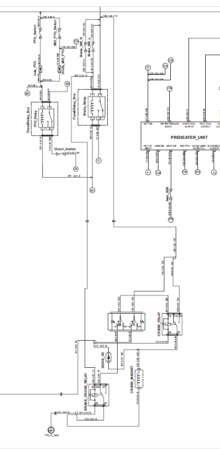

/ CK2610HST Cruise Control Install..Fail!? SOLVED
Power comes in from the upper left from the brake lamp fuse circuit. Orange wire leads to the Brake Cruise Relay and is energized when brake switch closes. That also puts power to the brake light relay and goes to ground closing the contacts to the brake lights.
Yellow/Green wire travels to Cruise Relay and Switch.
I get a little confused here as to which path current takes, but the Cruise Relay doesn't engage until the Brake Cruise Relay is energized.
I checked voltage to pins on relays and they are as shown.
I'm rusty on my wire diagram reading, so I may be missing something obvious.
Maybe a bad diode allowing reverse current flow?
Patrick 😡
