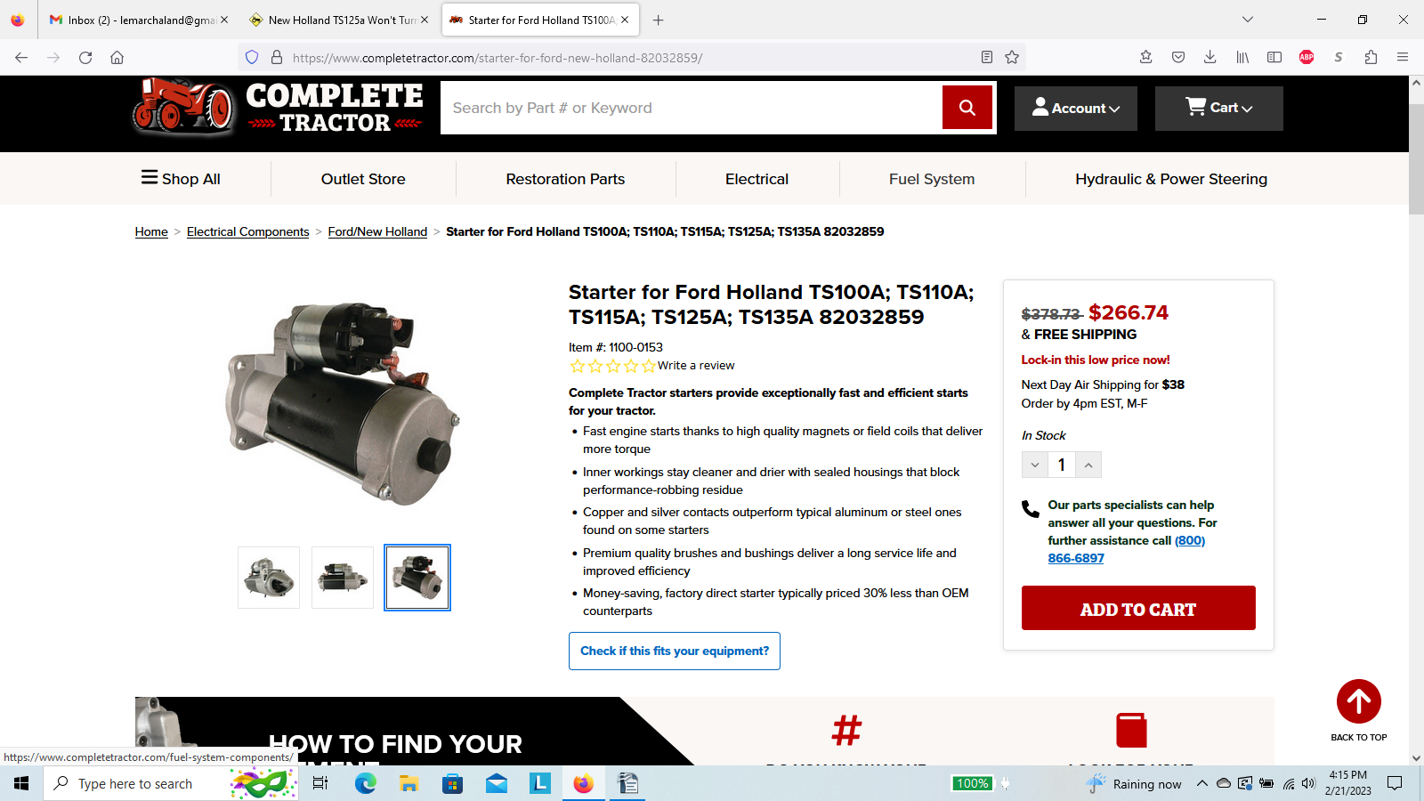

Is this your starter?
Have you carefully applied battery power from the large terminal on the solenoid to the small flag terminal?

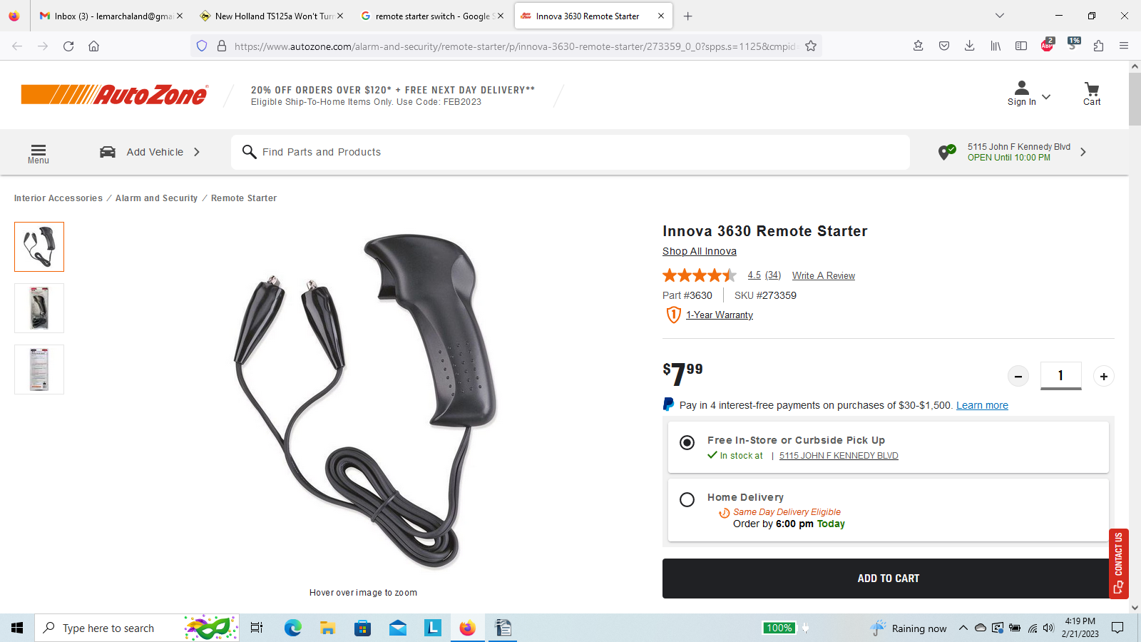

Preferably using a remote starter switch such as this;
Carefully as the tractor could move when started, any jumper wire would also work just not as easily.

That is my starter. I have " jumpered" it. The solenoid engages but doesn't spin the engine. I removed the starter and tried it on the bench. All seems to work fine on the bench. I'm wondering if the starter could just be weak.
