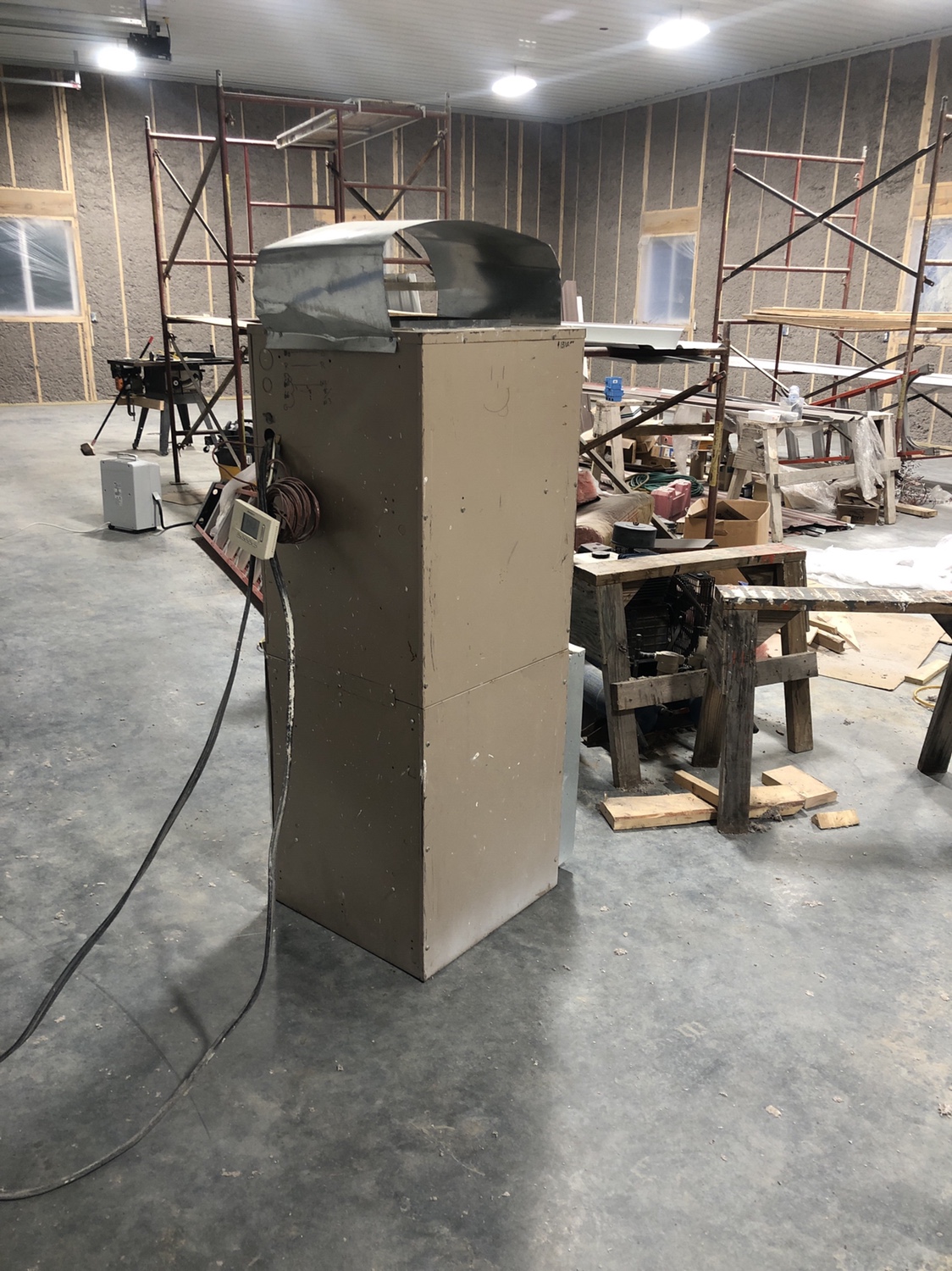

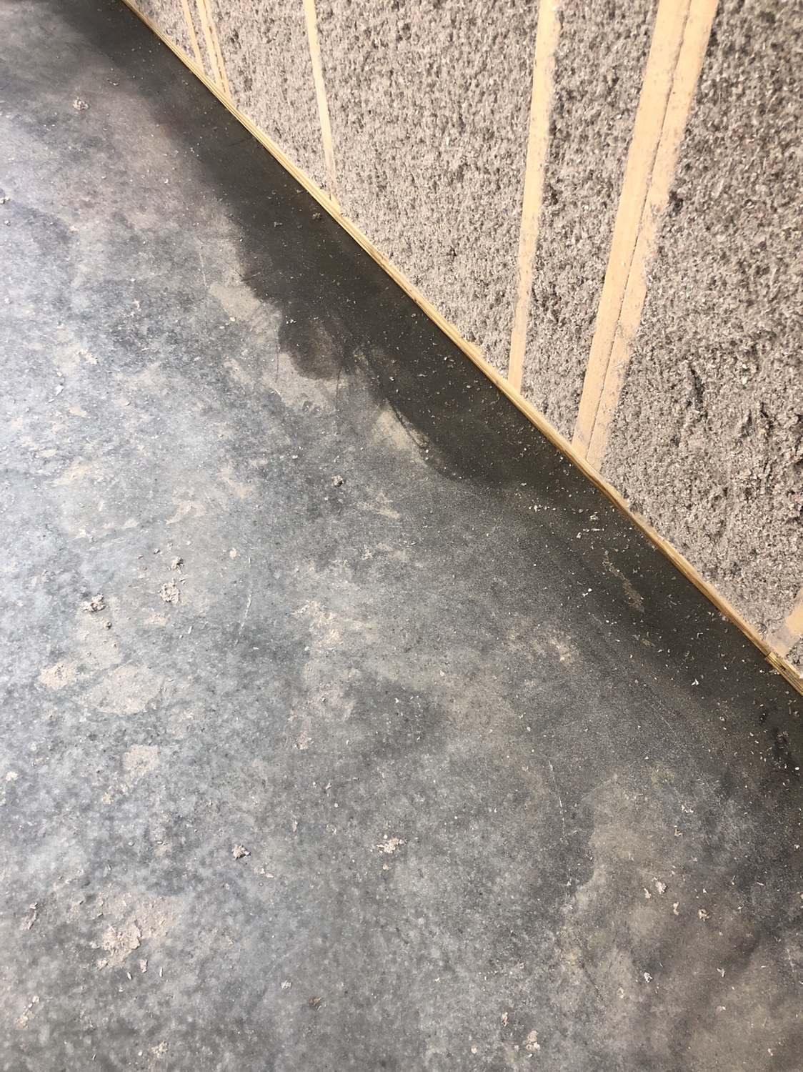

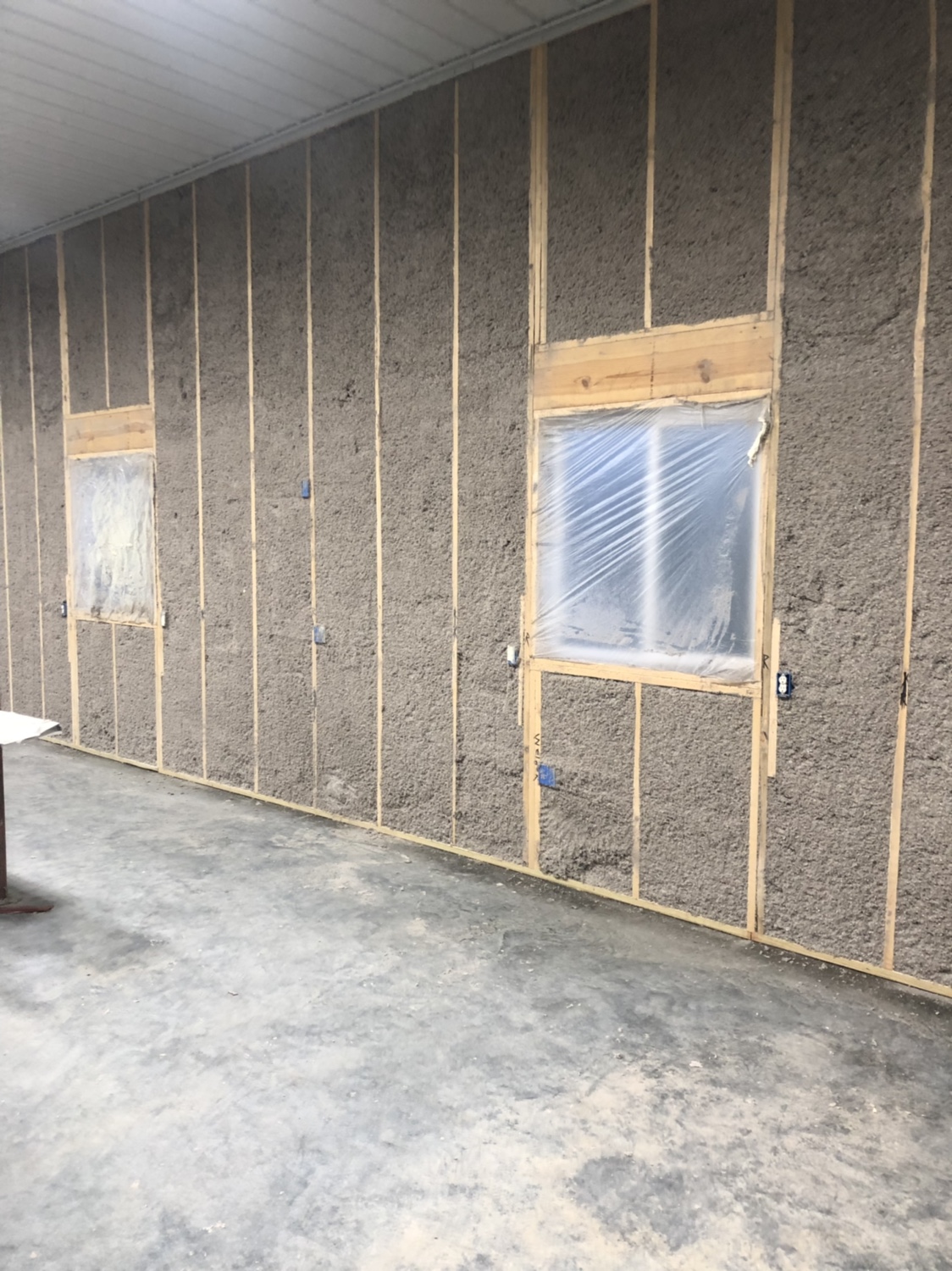

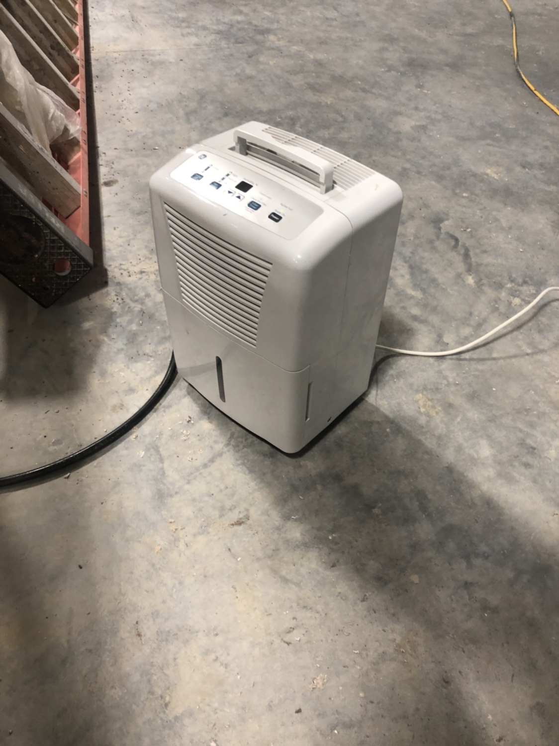

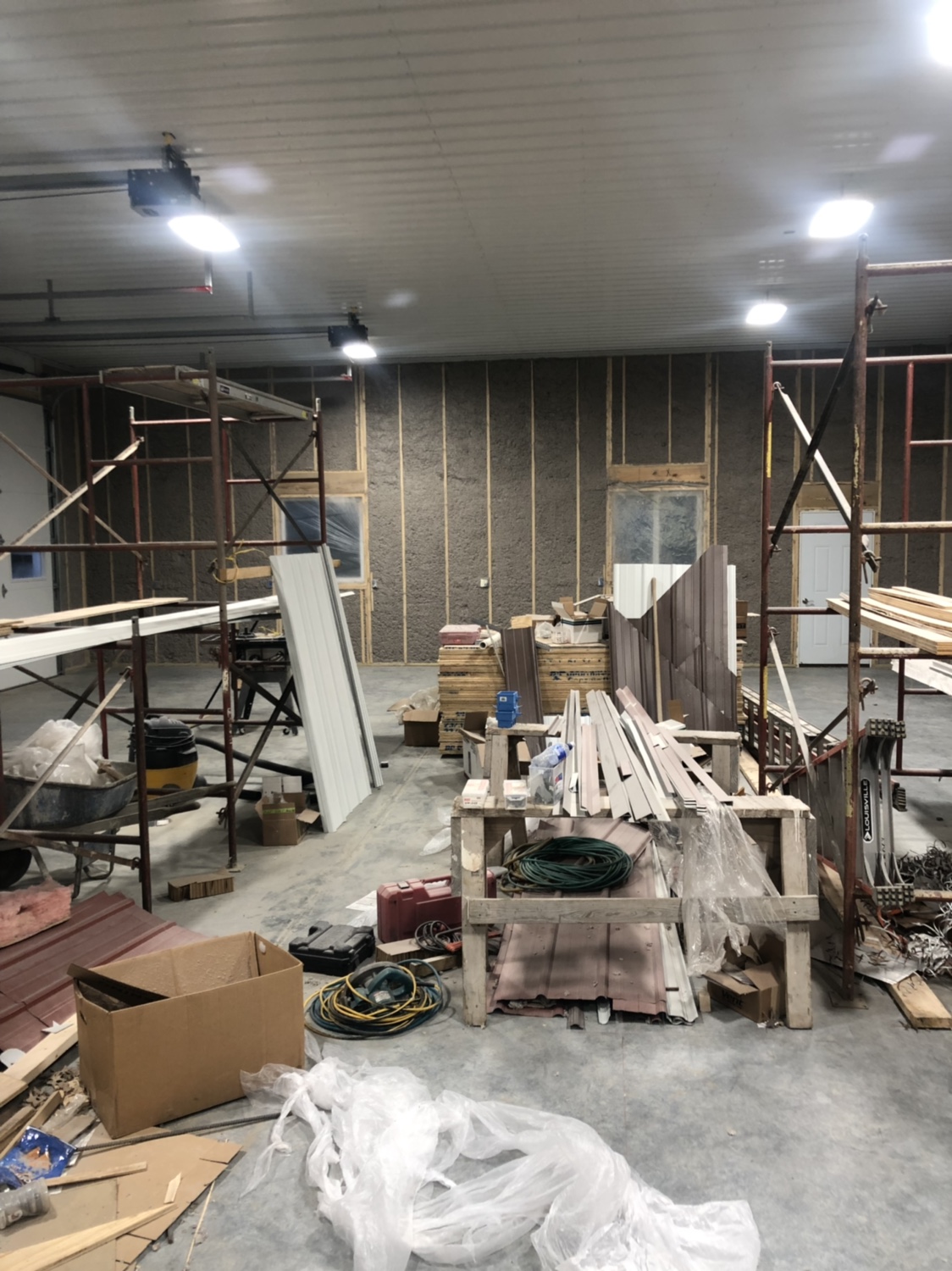

Walls and ceiling done! R38 blown in the ceiling. Builder has an old electric furnace and a dehumidifier running right now. Warm enough to stand and drink a beer in. Def lots of moisture in the air from the cellulose though. Water running off the garage door windows. Starts on the interior sheeting next week he said!
/ 40x60x14 Shop #166
By then things should be dried down enough. Just ride herd on the heat and dehumidifier. I think you need to be under 50%. But I'm no expert.
Glad it's moving along.

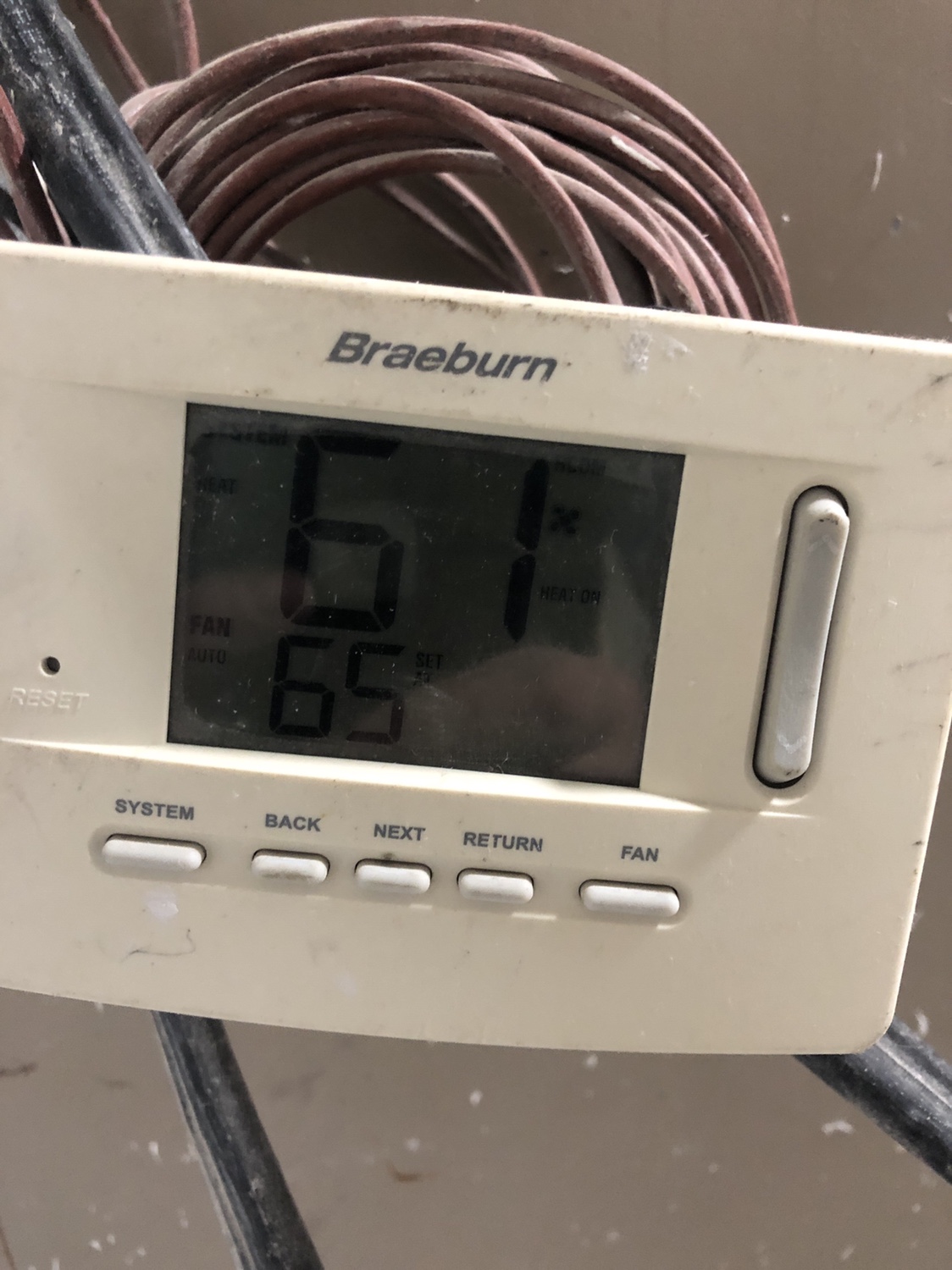

Just a little bit of moisture seeping out of the walls! It was 17 out this morning and the electric furnace that the builder put in was off at 65 when I checked it. I don’t think it’s going to take much to heat it at all!

Not much done on Monday, just a few sheets of plywood put up. Still holding at 65° and the furnace hasn’t been running the last two times I’ve been in there. Pretty good since it’s around 20° today.

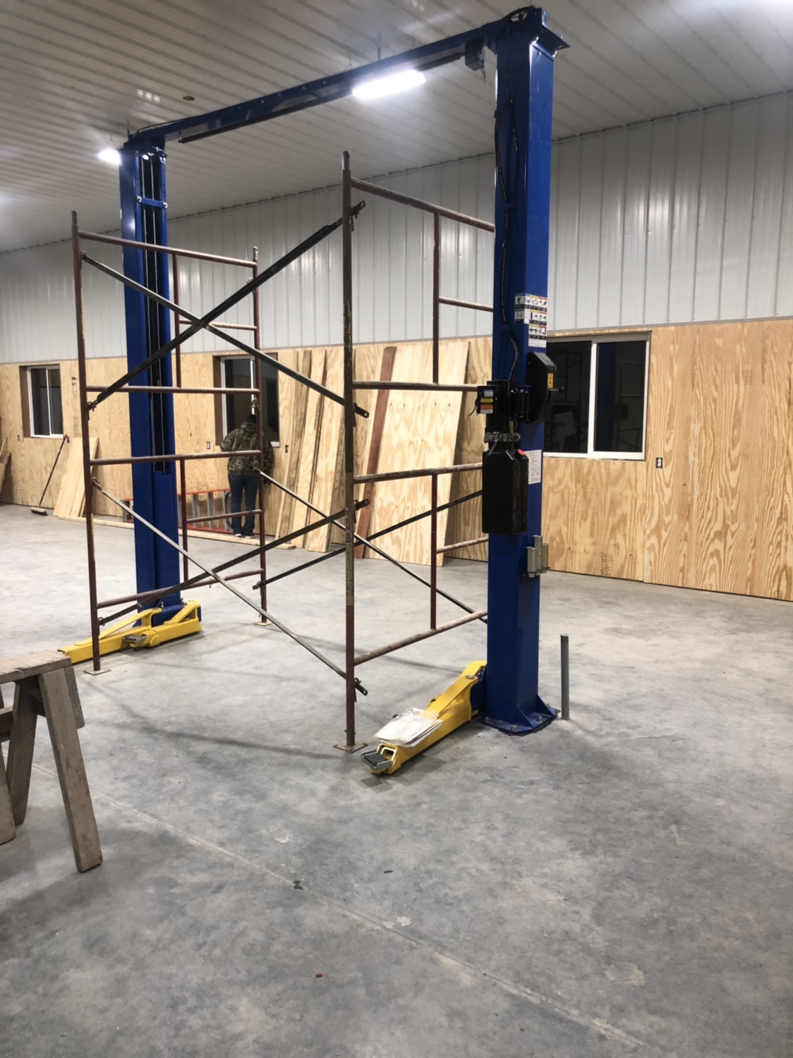

All four walls got plywood today! Ready to see some tin on the upper part, hopefully tomorrow.

Hoist installers just called and said that they are coming to install tomorrow morning! I’ll post up some pics tomorrow eve.
