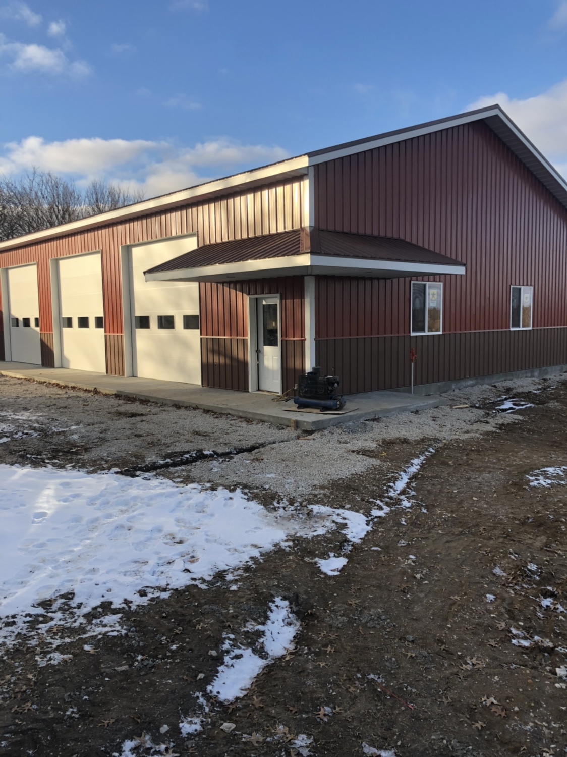

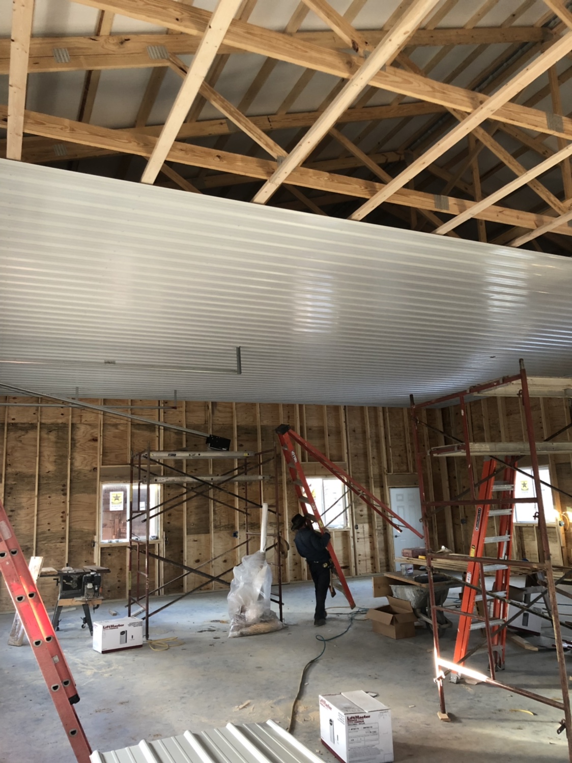

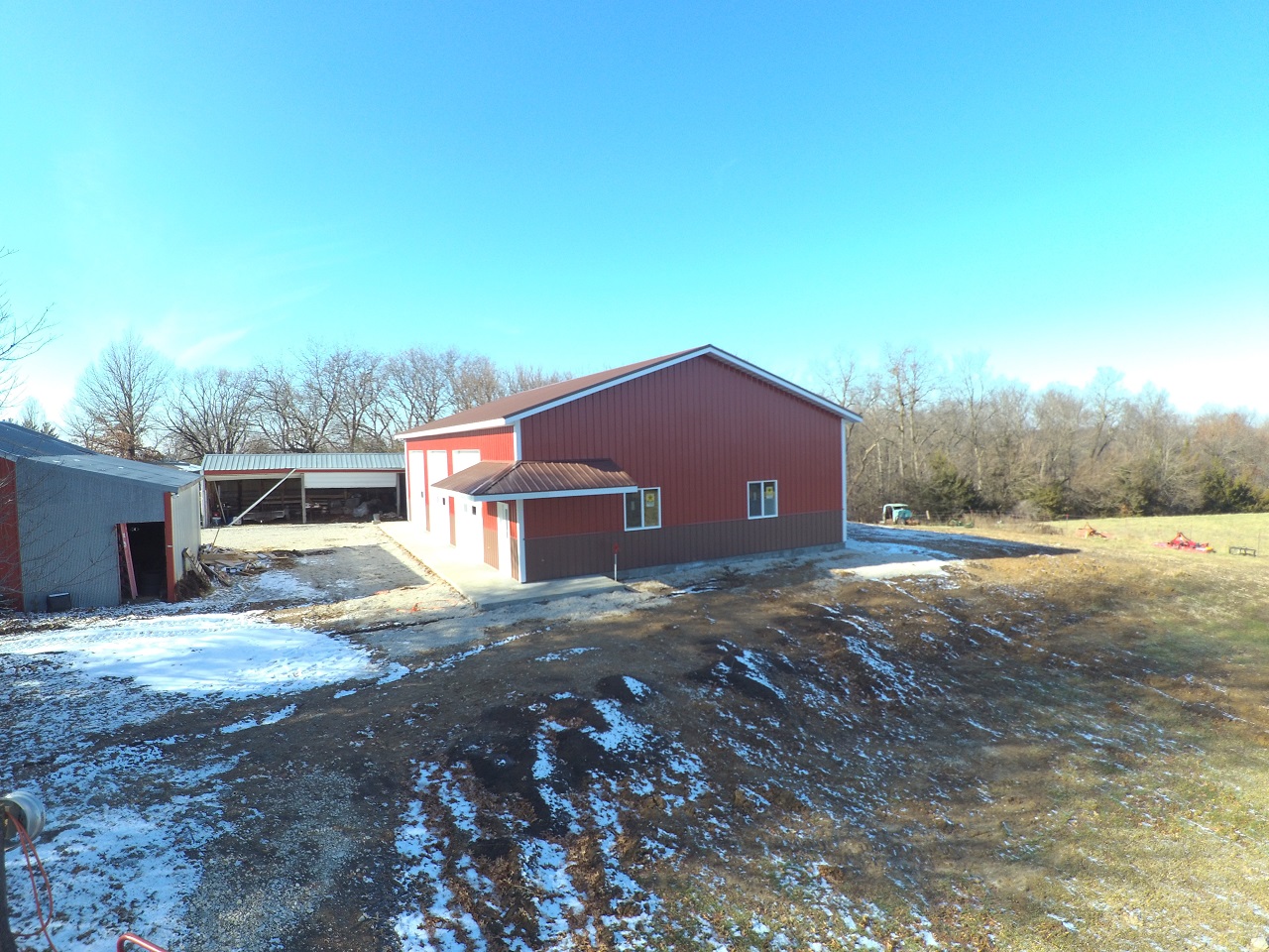

Started on the ceiling and finished up the tin work on the outside this week. Unfortunately, we have some issues to discuss with the builder. Found several spots where the drill slipped off screws and gouged the exterior tin. Also, if you look at the east wall from the house there are “bumps” all over it. Looks like maybe nails sticking out of the plywood? I’m not sure. The rest of it looks pretty good, but the wife made mention of the east wall, so that’s not good! Builder is supposed to be by after bit to discuss light locations on the inside, so I guess I will address those issues then. I’m less than thrilled about it!
/ 40x60x14 Shop #125

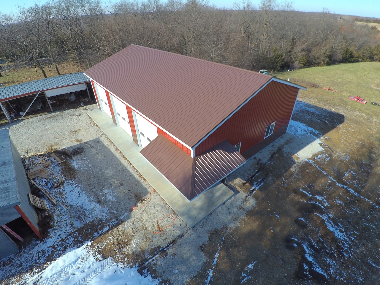

In the pics looks great. I like the white trim. At the corners looks better than red or brown. Also at the soffits and eaves.
I'll try to get over there and get some Drone shots tomorrow. Already have a dozen or more from previous visit.
/ 40x60x14 Shop #126
Why did you change the direction for the ceiling from the natural way of going across your trusses to adding purlins and going the other direction?
/ 40x60x14 Shop #127
I asked Jarid that same question
Neither of us know why. He's gonna ask the builder. They added 2x4s on 4ft centers so no structural gain. Actually lost a little since now the ceiling is suspended by a 2x4 laying flat rather than the 2x6 truss sill on edge.
I'm curious as to the answer. Not condemning the method, just curious.
I shot some Drone pics today so we'll try to get them posted. It's a very good looking building. The colors are country.
/ 40x60x14 Shop #128
Maybe the builder was worried about the ceiling sagging? My barn trusses are 4ft. on center with a metal ceiling and R40. My carpenter buddy told me not to worry about it. I was worried about sagging so I checked it with a laser before and after the insulation....there wasn’t any difference.
/ 40x60x14 Shop #129
The building trusses are running North/South 4ft apart.
2x4s laying flat were ran East/West 4ft apart.
The ceiling tin was then screwed to the 2x4s.
If you study the pic Jarid posted you can see this.

I see exactly what he did. The picture he posted looks like a rectangle, not a 4x4 square.

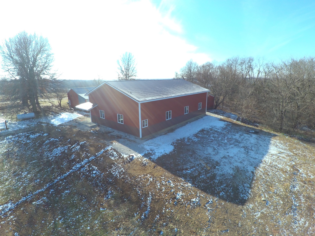

Hope Jarid don't mind, I'll post a couple Drone pics from today. Beautiful building. Very classy.

Maybe the builder was worried about the ceiling sagging? My barn trusses are 4ft. on center with a metal ceiling and R40. My carpenter buddy told me not to worry about it. I was worried about sagging so I checked it with a laser before and after the insulation....there wasn稚 any difference.
When I did my barn, I checked the requirements for the metal. It said supported every 4 feet, so I attached it to my trusses which have 4 foot spacing. My brothers barn has 8 foot truss spacing so he added 2x4s. Looking at the pictures, maybe the builder was conservative but maybe it was for appearance. You usually want the ribs running away from you when you enter the building. Any joints will then essentially disappear. If it runs crossways, the joints will be very obvious.

The 2x4 ceiling "strapping" look to be on 2' centers not 4' gaining some support if this is so. also makes a handy spot to stuff wire on "all the way across" runs from the panel. It's coming together nicely:thumbsup:
/ 40x60x14 Shop #139
The 2x4 ceiling "strapping" look to be on 2' centers not 4' gaining some support if this is so, they look a lot closer spaced than the trusses are. Also makes a handy spot to stuff wire on "all the way across" runs from the panel. It's coming together nicely:thumbsup:
/ 40x60x14 Shop #140
I thought they were 4ft but I did not measure. A quick glance at the screws would tell.
I wonder which is stronger, 2x4 flat every 2ft, or 2x6 on edge every 4ft?
