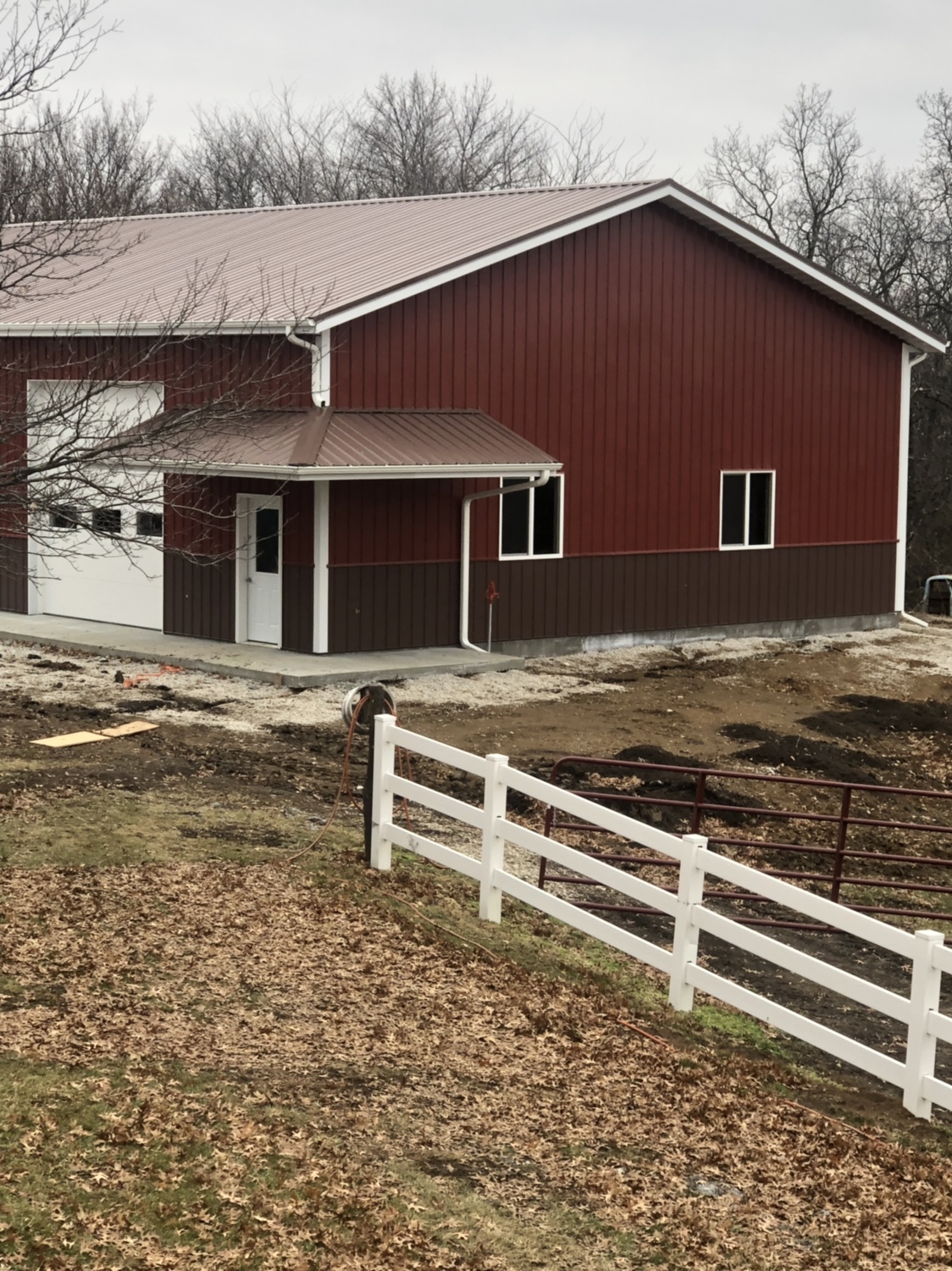

The builder just stopped by work to pay for an oil change he had done yesterday, and stopped in to discuss a few items with me. Supposedly the "bumps" in the tin have been remedied. I honestly haven't seen the building in the daylight for a few days so I have no idea! He said they pulled the tin and found some of the staples for the typar were causing the bumps. Apologized, for not being there to supervise, and assured me that it was good now. Hasn't replaced the tin that was scratched yet, but did say that it would be done. Supposed to hang five LED light fixtures today, and wants me to go check them out this evening. These fixtures are new to him and hes unsure of how the light is going to be. Just hanging them on the north side first, so that we can decide what to do about door interference on the south side. I think it is just something that we are going to have to deal with. He's concerned that with the doors up we won't have enough light on the south side. I think that it's just something that you have to deal with. I would rather have great light in the winter time with the doors down. Talked with him about the ceiling, and really it came down to that was his personal preference. He said initially they had talked about doing one solid 40ft panel, but decided to split it into two 20ft panels because they didn't think that they could make it look good spanning one piece 40ft. As far as the purlins, he just feels that it helps strengthen the building. He said he doesn't prefer to screw the tin directly to the trusses. Again, I think it's just what hes always done, so that's what he does. The more I look at it, the more I like it. As Eddie stated above, it just seems more inviting when you walk in the building. I may not have ever noticed had it not been mentioned. Told him I was going to enjoy a cold beverage in there this evening, and he suggested a couple so that I could really take the time to check out the light.

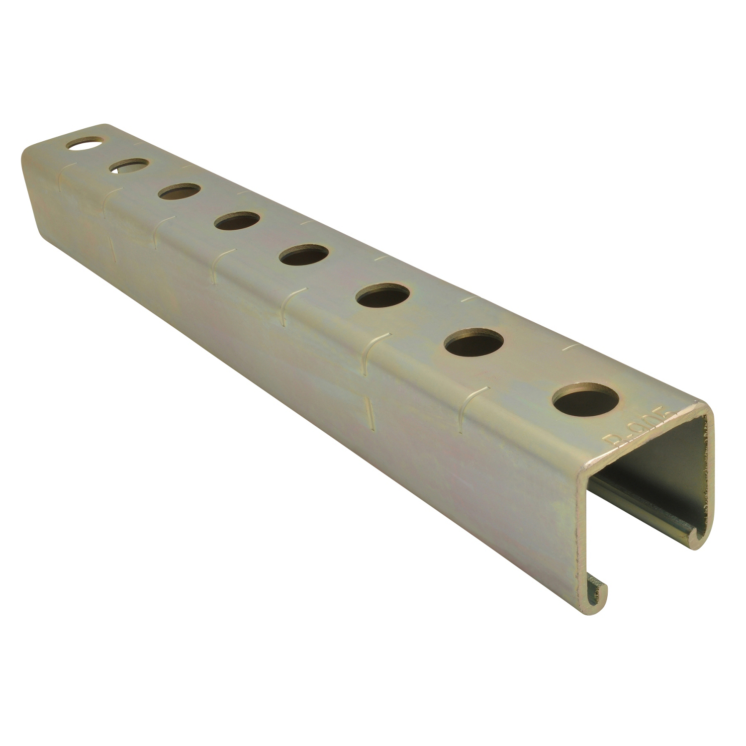

In one of my shops the O.H doors were fairly close to the ceiling, like no more than 2'. I mounted the lights on some Kindorf channel that spanned the 12' door while opened. It did lower the overall ceiling clearance some but was still above the door height. (16' ceiling and 12' doors)
The stuff is very rugged and they have many accessories for mounting, splicing and it is an electrical product that your supply house should have. IIirc I just dropped them down to the desired height with all thread through an added minor framing member between the trusses. It's a static load not subject to any other forces other than straight down so the all thread did the trick with a simple clean installation.

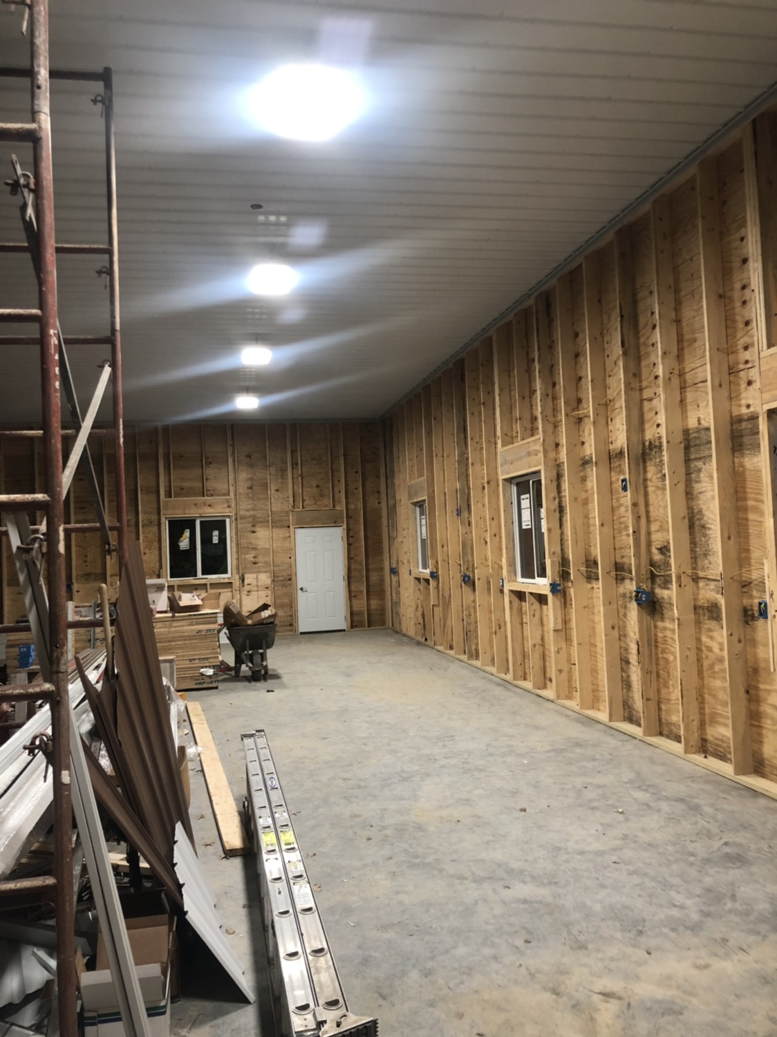

North side lights are bright! Me and the wife can’t agree on the lights on the south side. Typical!

Not much to add to the thread recently. I’ve been going to work early and coming home late so I’ve not had any pictures to take lately. We got guttering done last week. Also, got all the ceiling installed, and all the lighting. Installed 9 led light fixtures five on the north side and four on the south side. Tried to place the four on the south side to where they still shine good even with the doors up. All three garage door openers are wired up, and installed too. Supposed to get the walls spray foamed next week. Should have been done this week, but there was an issue with the equipment. Next Thurs I meet with the hoist installer so that he can inspect the building and write up a work order to get the hoist installed. Seems like a gimmick just to charge me a trip, I mean it’s a new building, what could be wrong with it!
