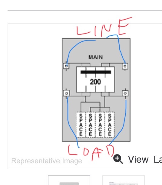

The main breaker in my panel is 4 pole 200A 240V. Don't have enough electrical knowledge to understand why.

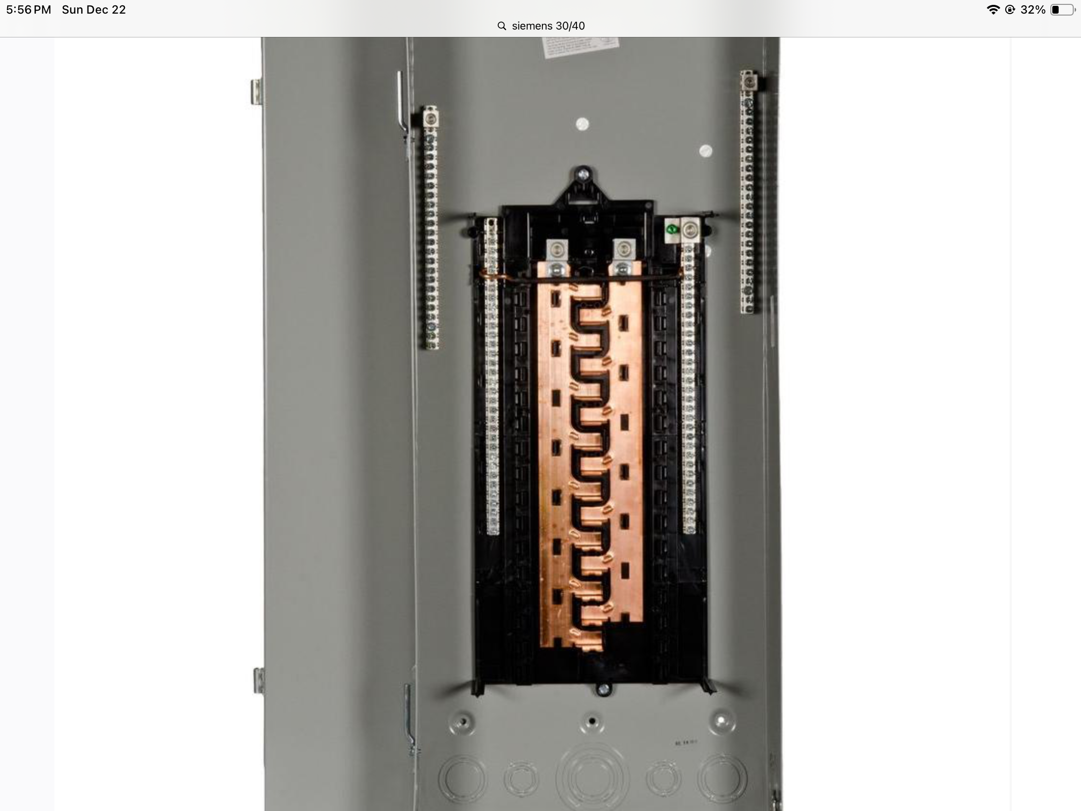

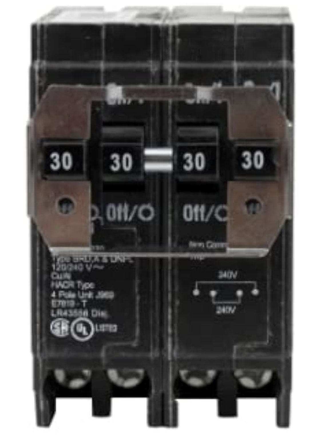

Those are called quad breakers. Most panels will allow you to remove 1 dual breaker and add this breaker. This will allow two separate 240 volt circuits.
But will generally only work on panels that have a notch in the bussbar.
For instance, a siemens 30/40 panel. Can either take a total of 30 full sized breakers, or the lower spaces can allow for these quad beakers (or twin breakers) to increase to 40 spaces.
Heres a siemens 30/40 panel. See the notches in the lower 5 posts of the copper bus bar.
Some panels use a 4 pole breaker, but its because each actual breaker was not able to carry the full load. Its just a cheaper way to make a panel. In other words, the left 2 breakers are one phase and the right 2 breakers are 1 phase. Has nothing to do with neutrals.
For example, this panel would feed 200amp through to a mobil home or house, while allowing 4 circuits at this panel.
