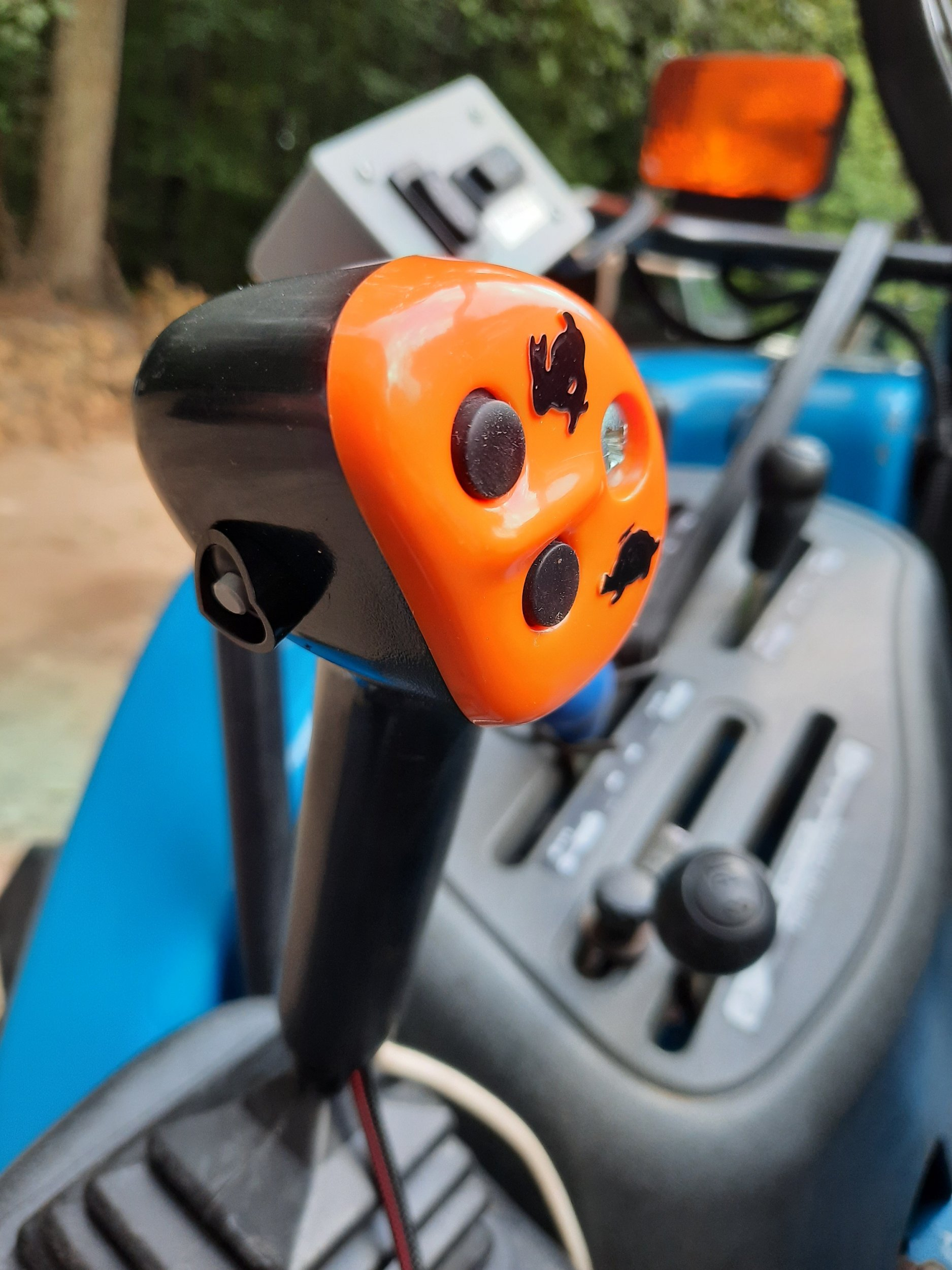

A diverter valve will also allow for flexibilty and control in speed or force, and the switch can be placed anywhere desired.

I wouldn't be satisfied with any setup that required me to move my hand to a different lever for any of the three functions.
A grapple becomes such a valued attachment that you'll use it a LOT.
I agree.... after having a grapple it is amazing hoe often you will use it, & although I contemplated used one of the rear remotes, I'm so happy I decided to go with a dedicated diverter valve.... I installed a diverter valve on the FEL over a true 3rd function because I like the idea that I can feather the grapple closed (more importantly the tree / post puller) & never take my hand off the FEL control.
I also added 2 additional rear remotes for a total of 3 now... The additional remotes & the diverter valve are two of the best upgrades / investments I have made to the tractor.

My $.02 is that a 3rd function is not an ideal solution for a grapple. The problem, at least for me, is the third function has no practical way to moderate the speed and force of the hydraulics that open and close the grapple. I had one installed on the last tractor I bought , used it for a day or two, added a flow limit valve which did not work, and went back to using the rear remote to operate the grapple so I could control it through the use of a real valve.

I can't answer for anyone else but being able to control the speed / force is a big help in picking up & stacking odd shaped items (say rocks, etc) when you want place something in a particular place. With the tree / post puller I couldn't imagine not being able to feather the jaws closed, otherwise it can go right through the small trees.
Again ours is a diverter valve & I install the switch right on the FEL control handle so no removing your hand back & forth.
