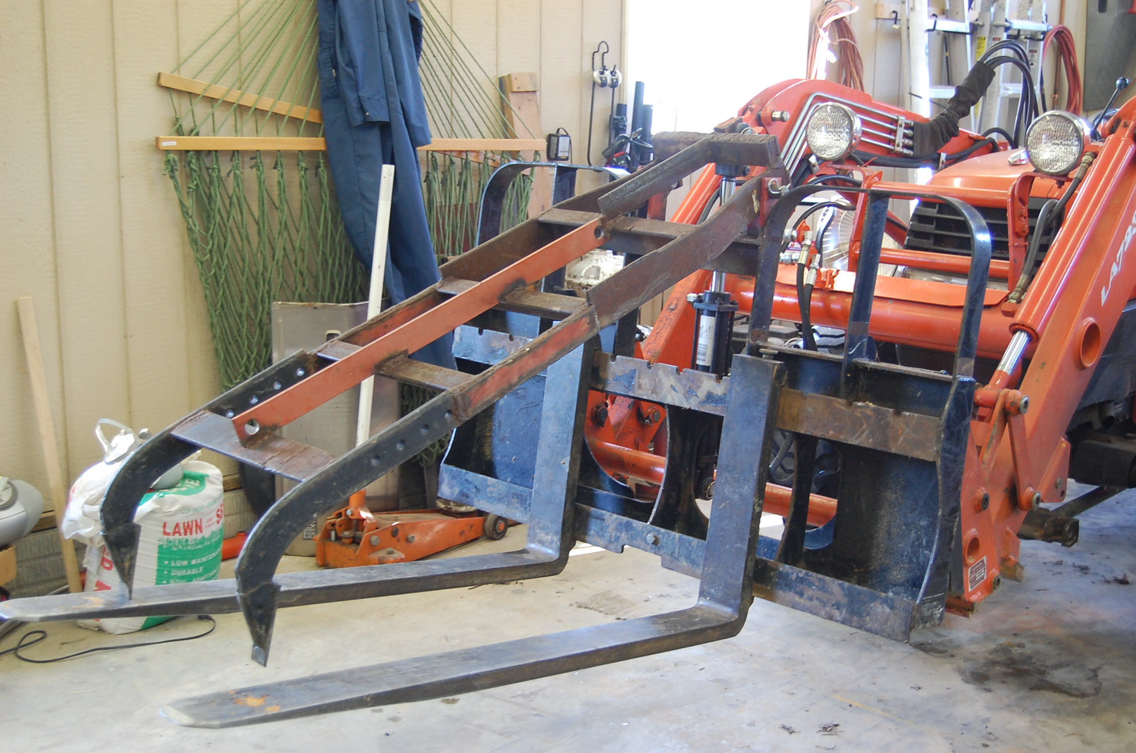

My grapple set up is home made using my pallet forks as the base. I use the grapple to help hold loads, some which are a bit fragile, like when I move assembled cabinets from the wood shop to a trailer for transport.
If I were using a commercial grapple I can see where it would be less of an issue but even when I'm grabbing logs to move into the dump trailer I like having the ability to slowly open the grapple so the log slides into the trailer instead of just dropping.
Here is a picture of version 1.0. prior to paint. It looks a bit different today as I found a couple of weak spots in my original effort that I had to remedy. I found anything with hydraulics tends to locate the weak spot pretty quickly.:unsure:
