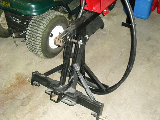

I had an old receiver hitch off of one of my trucks laying around, so I cut it up and turned it into a trailer hitch for the Kubota. I'm thinking with a little extra trussing, I can build a small subsoiler that will slip in the hitch. I basically plan on running electrical wire into the ground with the subsoiler, so it doesn't need to be too big, just to get the wire deep enough. Thoughts?
/ 3PT Trailer Hitch
#2
Forgot the pics, duh...

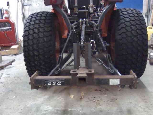

/ 3PT Trailer Hitch #3
I did the same thing with a hitch off a Ford Explorer. Works great. You are right though about the extra trussing for ground engagement. I pull shrubs with mine using a 3' chain and doing both a lift and pull at the same time and I am sure without the extra trussing I would have broken it.

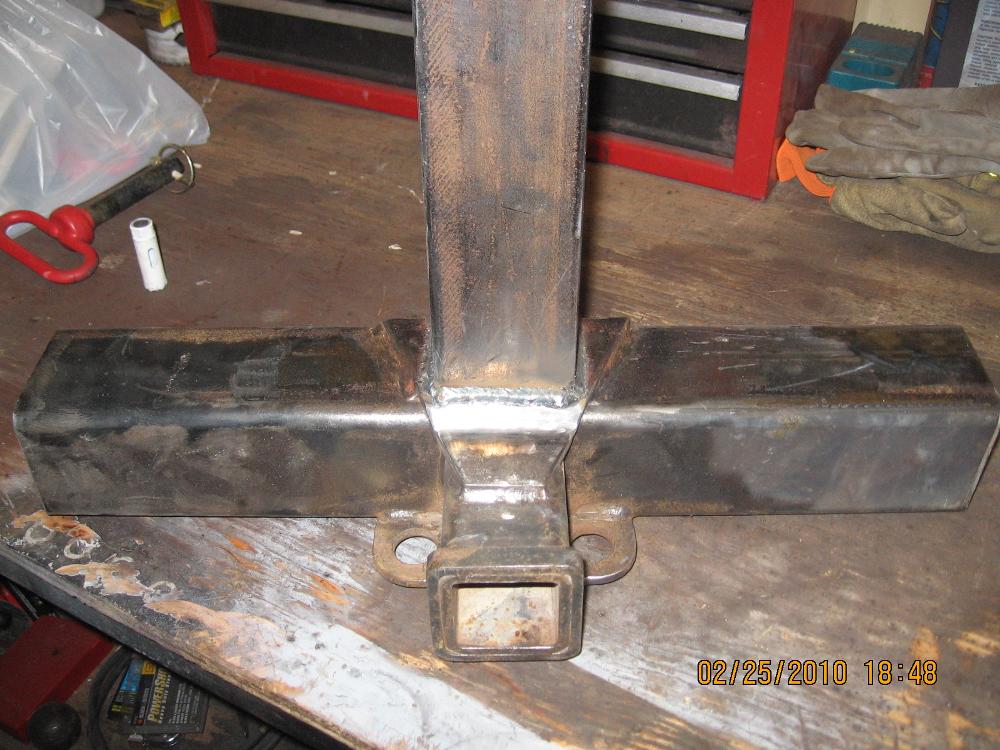

Here is some pictures of mine:

I like that Kenny, pretty much exactly what I was thinking. What did you use for your tooth, looks like one out of a BB?

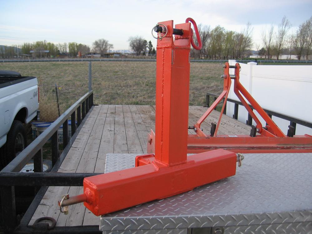

I also built mine out of a hitch from a 3/4 ton truck. I flipped it over to gain a little extra height with my last tractor. This tractor is just enough higher that I am thinking of flipping it back right side up. Maybe I'll paint it then too:D
Bingo:thumbsup: It's a replacement ripper tooth for a KK box blade from TSC.

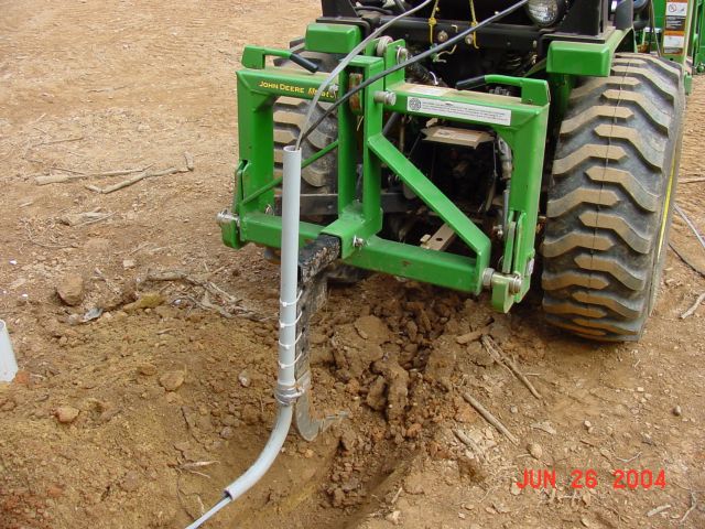

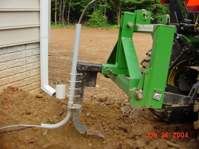

Nice. Tell me how effective the unit is in laying wire underground. How deep will it go? I have several hundred feet of runs I need to make, and this unit would save me a ton of time on the BH.
/ 3PT Trailer Hitch #11
It worked very well for me. Depth was about 12" to 14" or so...I made "dry" runs first to ensure the ground was softer and no obstructions such as large rocks or roots where in the way before loading the cable. There are quite a few other threads about those things-with some better ideas than I had used.
What do you want to bury?

Mainly just electrical, I on a generator at my property and have extension cords above ground running to all the trailers and such. I just want to clean things up and put everything underground. If it works out ok, I may try to run some half inch water line.
/ 3PT Trailer Hitch #13
I have seen a thread a while back when someone put down plastic conduit or waterpipe in the same way. He did 50 or so foot runs and then pulled the wire into the conduit with fishing tape. Same idea as KennyD with steel pipe connected to a subsoiler and the conduit layed down through that.
/ 3PT Trailer Hitch
#14
That would be nice, it would save some money on wire if I was able to buy the stuff that requires conduit.
