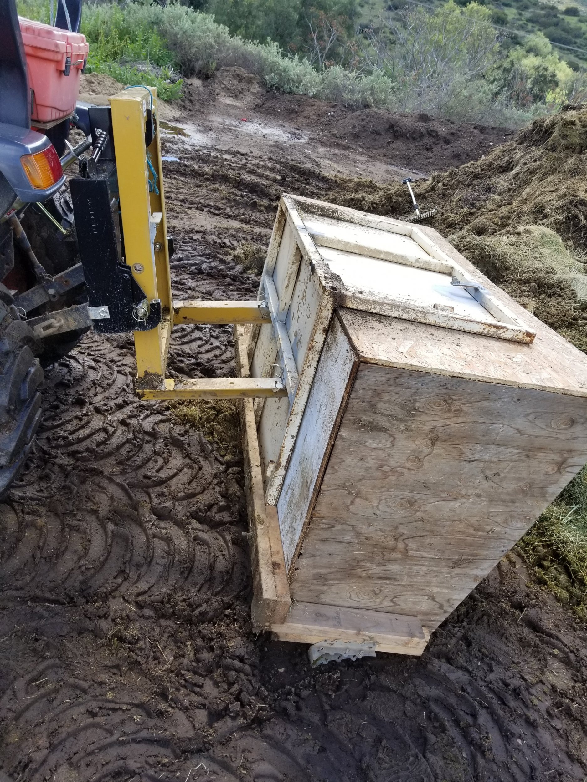

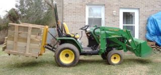

Just build one. I built mine from a TSC carryall frame. All total it cost about $200.

i find the dump bed on the hauler pretty attractive...seems to be pretty versitile. making one out of a carry-all did cross my mind but it wouldn't dump...
/ 3pt hitch hauler #4
You could lower it to the point where the top link pin is free. Remove the pin then lift your 3ph. It will dump. Not as convenient. But it might work for you.
/ 3pt hitch hauler #5
You can dump it manullly to a point, but if you have a hydraulic toplink (which I do not have) it is a lot easier...
/ 3pt hitch hauler
yeah i don't have a hydraulic top link either.. 1 of the reasons for this would be for hauling wood. i gave thought to the carry-all with plywood or something building a box.. but most only had a 1000lb capacity.. this thing has a 2500lb capacity plus the dump.. and its a 6x4 box.. even without dumping.. i'd bring it up full and set it down on a stand.. and take it off..
idk.. i will probably get one.. i just wish somebody here had some alternatives or experience with this..

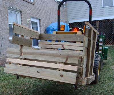

Here's mine on a TSC Carryall. Just built over a pallet on the bottom forks. The back opens up either half or all the way.

I made my TSC carry-all a hand-dumper.
