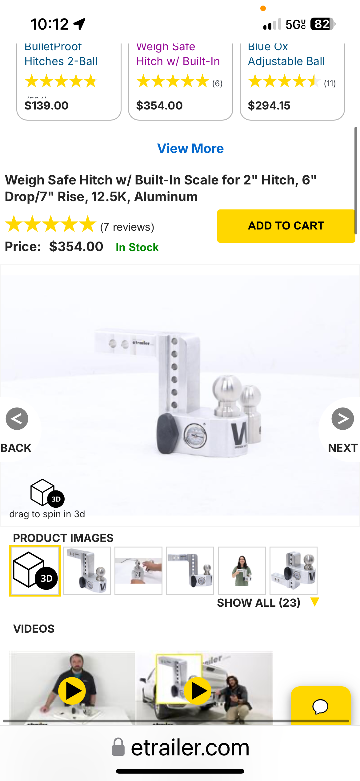

I've seen the mechanical ones. They're too expensive and bulky for casual towing. Still surprised that there's no electronic solution for this.
Too expensive and complicated for what it's worth. If someone is green enough to need something like that, they should be limiting themselves to small loads in general or seek hands on instruction from someone with more experience.
   / Surprised that there are no trailer hitches with tongue weight indicators #33
I have seen them for $30 and up
