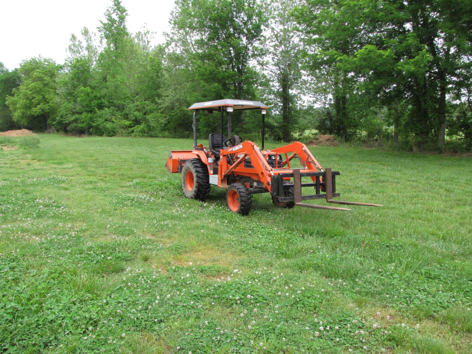

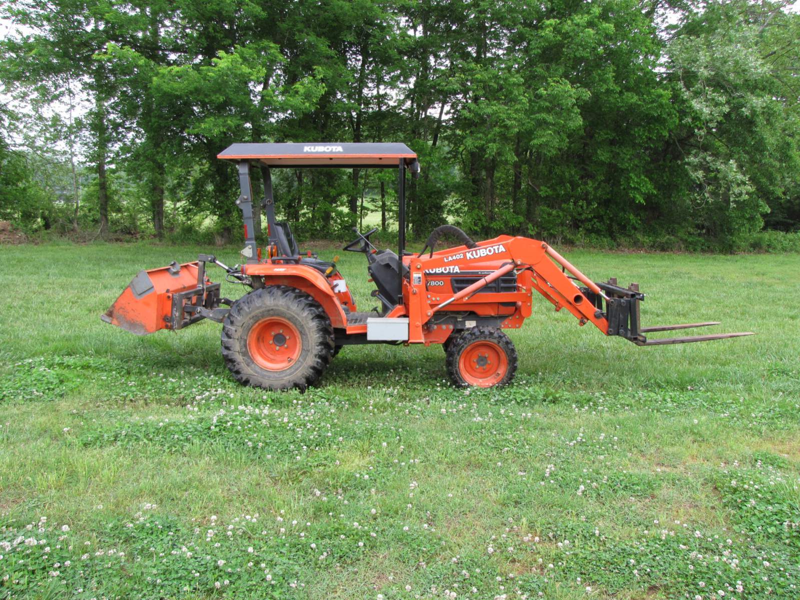

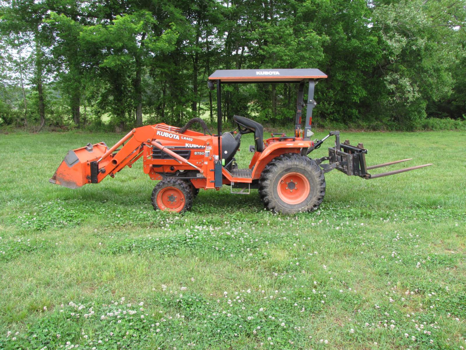

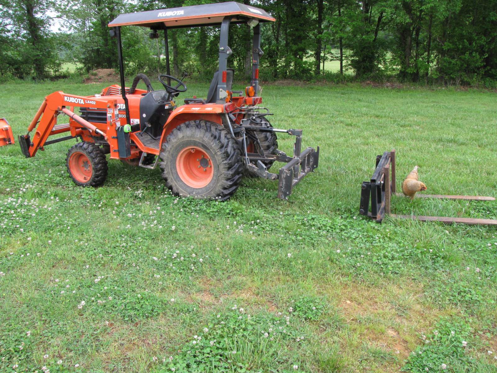

Made this last week. Worked great with the forks, but when I tried to pick up some gravel with the bucket on the back I bent the 1/2" strap for the lower pins. I was thinking I would need a little more room when it came to hooking up so I when 4" long on them. I was wrong because the frame is all open, also they should of been 3/4" stock and only need 2" from the frame.
Had to get stright and weld in a helper bracket to the inside, hope that does it. Shouldn't be needing it for grading anyways. Made it for moving my fire wood on skids.

Careful there, don't try lifting that poultry without proper ballast on the other end.;)
Looks good, though. I have thought about something like that, but I think that what I really need is a set of three point forks so I can move two pallets at once.
