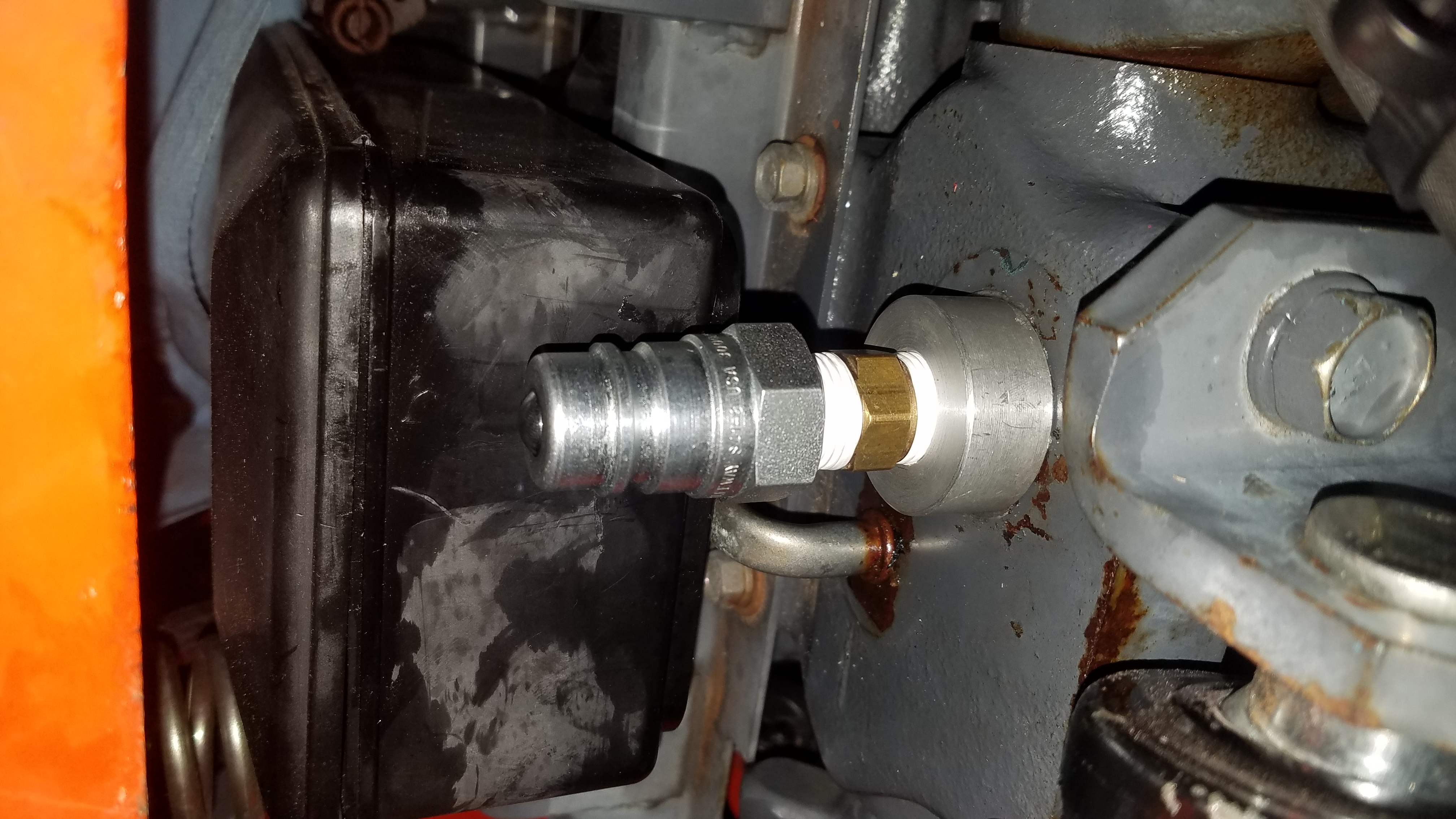

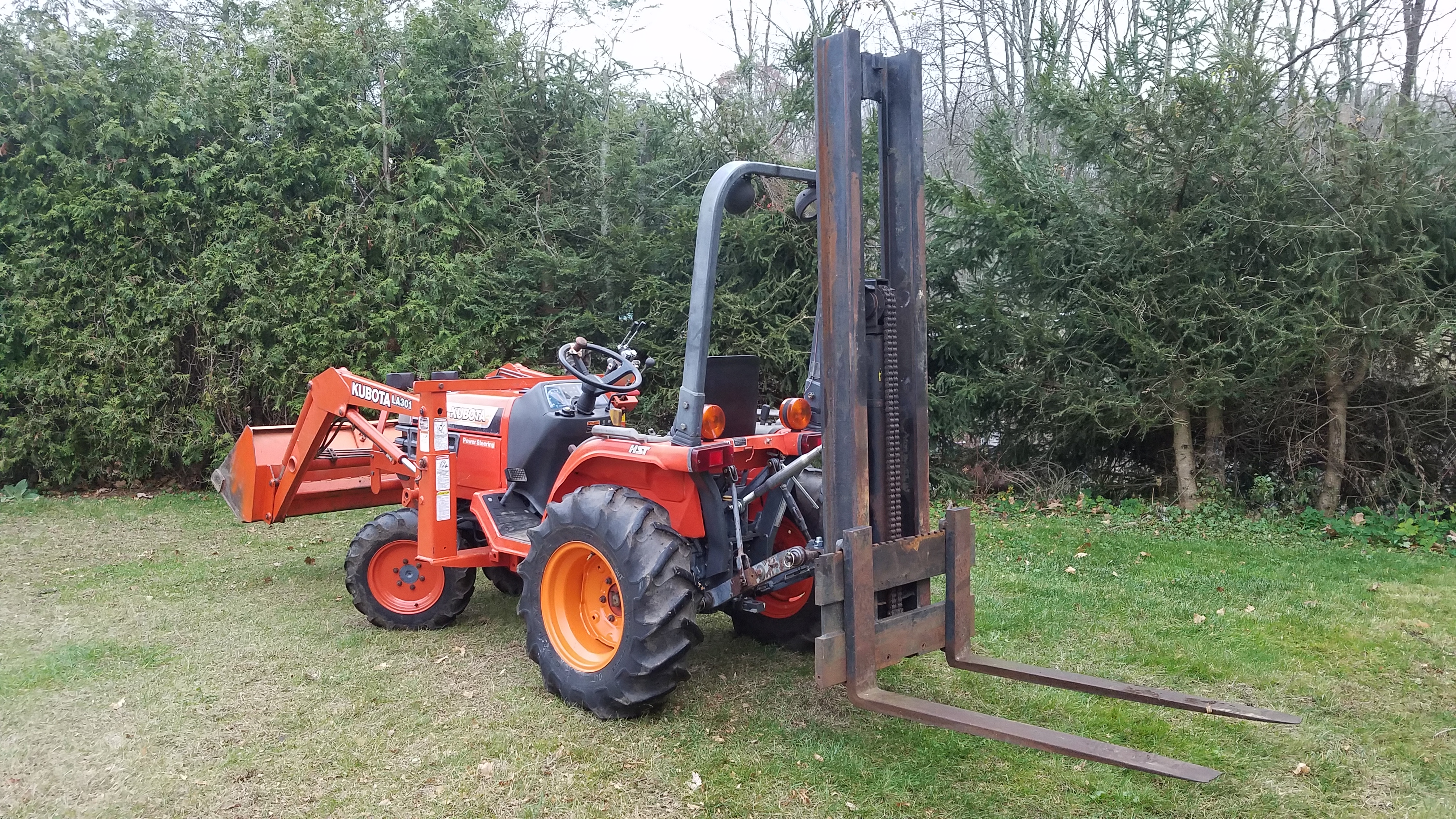

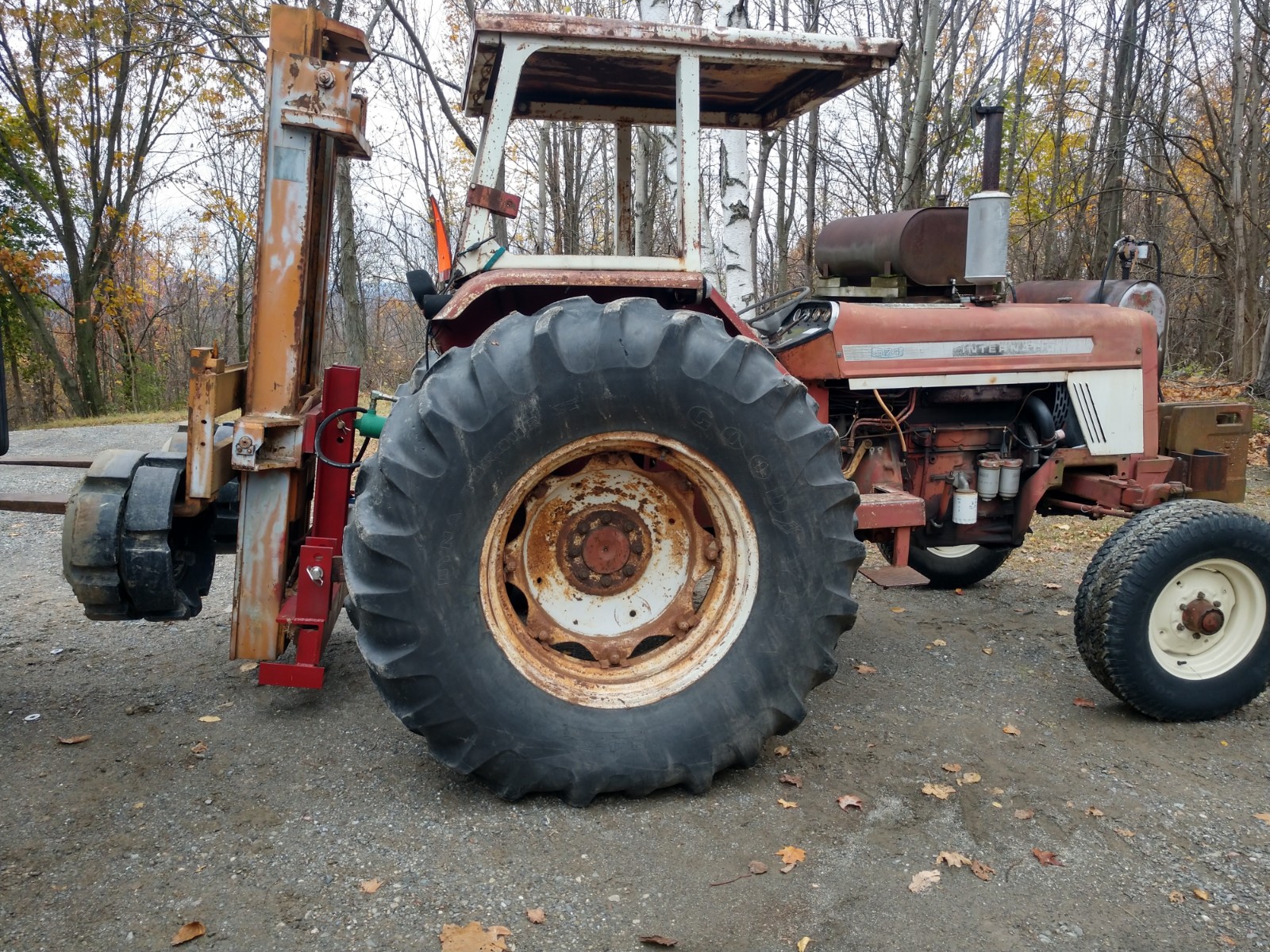

I've wanted to build this for years, but never found the right parts forklift. That was until a few weeks ago.
It's a little on the heavy side weighing in at 500lb empty, but I plan on doing some weight reduction in the coming weeks.
The forks offer a 6ft lift height, not including the lift of the 3pt itself.

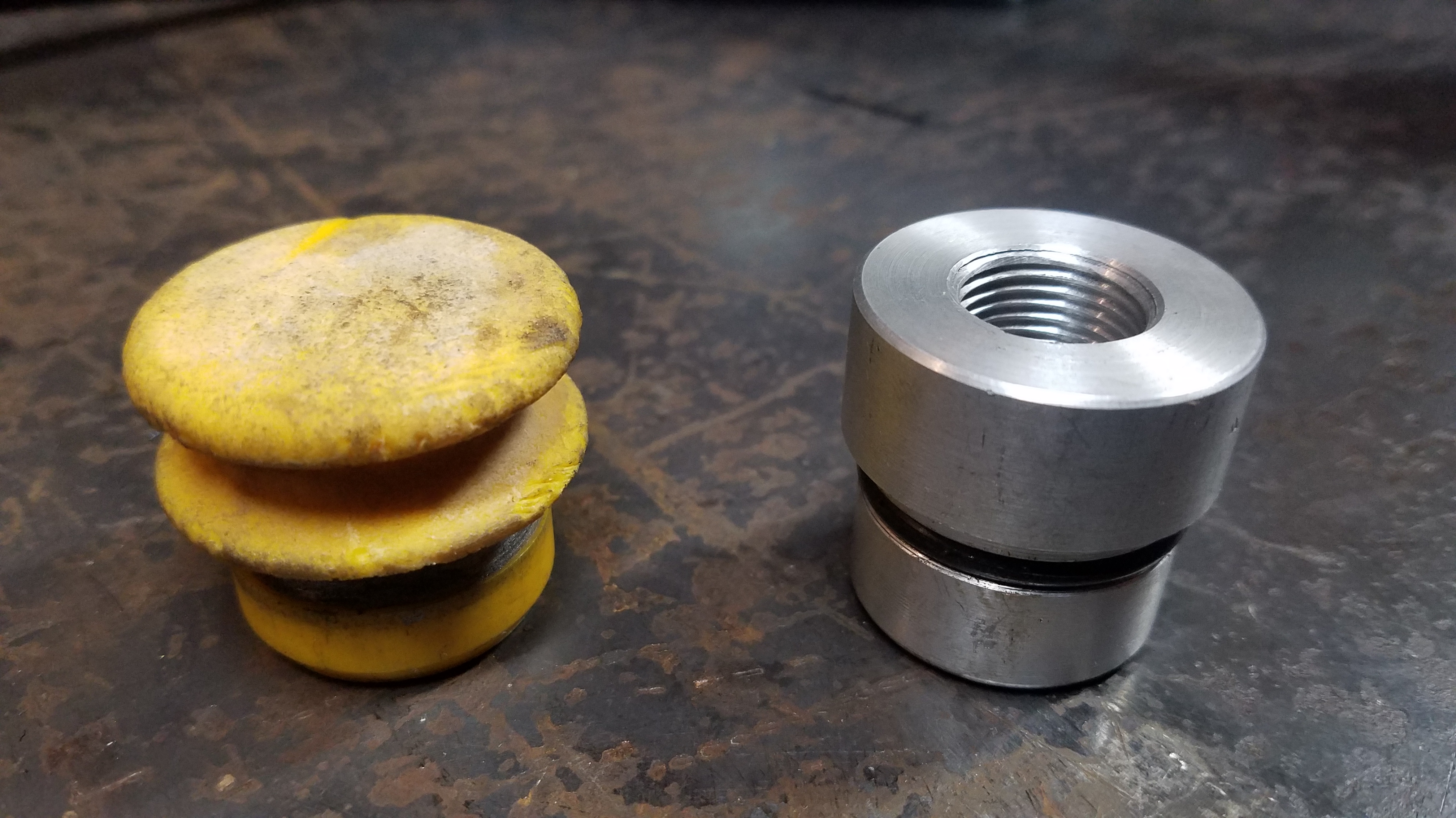

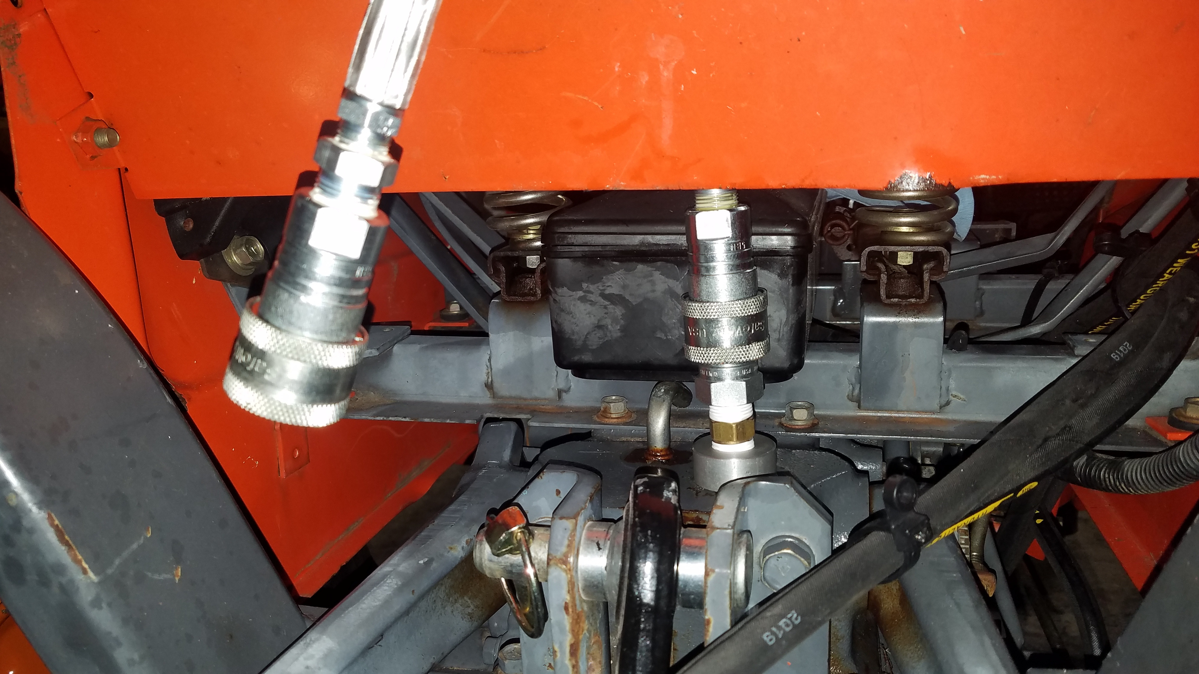

The forklift cylinder is a single action and my aux circuit is dual action so I plumbed the return line into transmission tank with a spare QD allowing the pressure to dump when lowering.

Nice. Congratulations.

How much hydraulic pressure do you have available to the fork lift cylinder and what diameter is the lift cylinder?

Not very much because a forklift uses big cylinders and the leverage disadvantage is only 2-1. A tractor operating pressure would be plenty.

That's a rugged looking unit. You will find a lot of uses for it.

I was just trying to calculate how much down pressure (total weight exerted on 3pt from lifting with forks + fork unit) on the 3pt if tractor pressure was put to a large cylinder. Add that number to the weight of the lift @ 500lbs. The final lift potential might be much more than what is considered safe for the tractor of this size.:2cents:

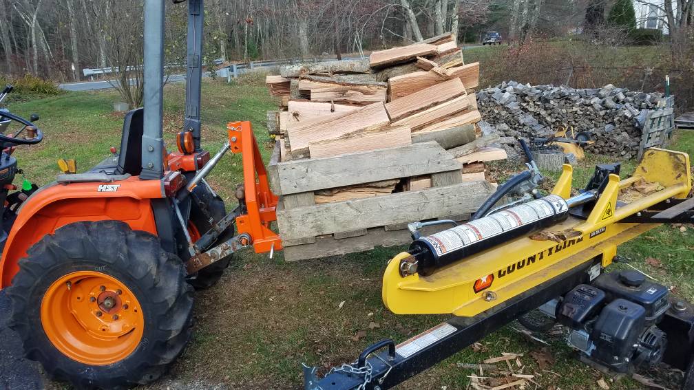

An hydraulic top link is very nice in this application as it allows you to tilt the mast.
That's a very common setup here for the orchard farms to move plastic pallet boxes full of fruit around.
   / 3pt Fork Lift #9
What are you planning on lifting with it? What are your 3pt arms rated at? My kubota is only rated at 1300lbs at the bar, less at 24".

It seems like that big single acting cylinder would need a lot of oil to lift to full height. Is that going to cause problems for your tractor??
