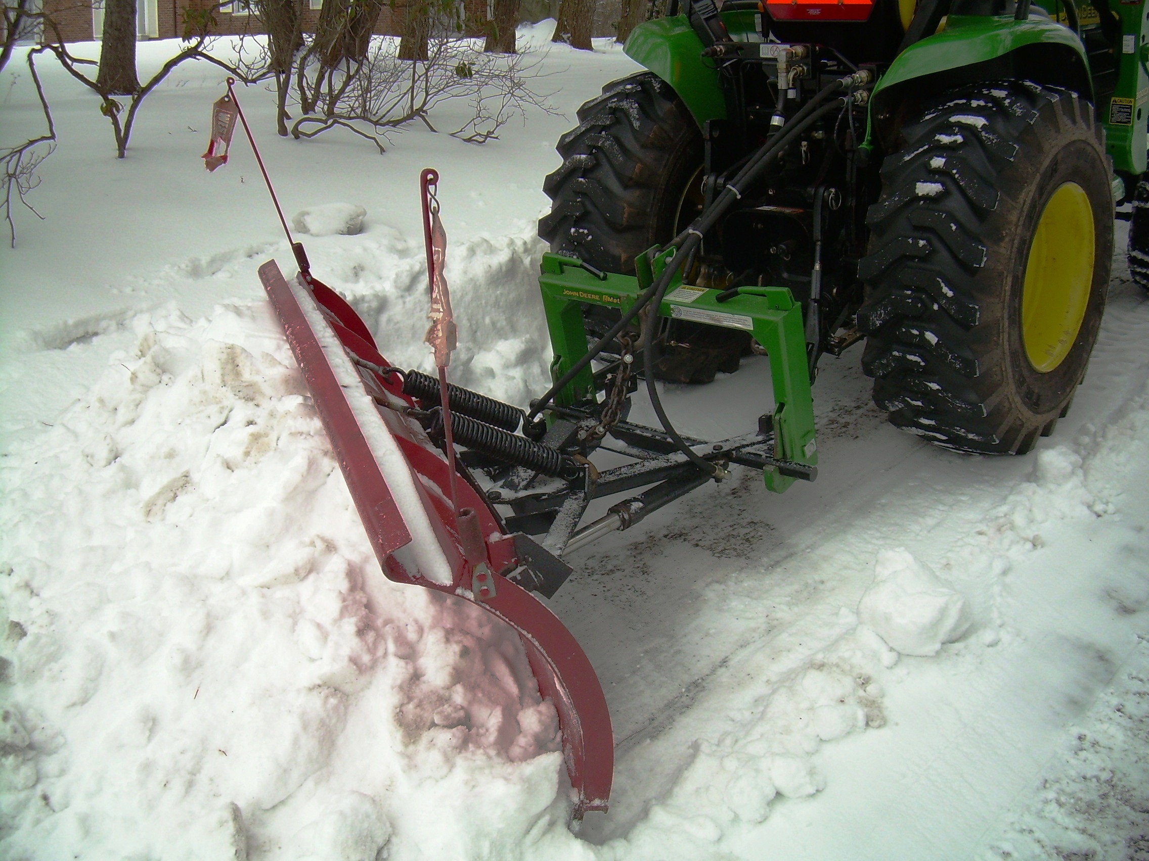

I did ever so slightly bend mine on my 4310, but that was from beating them with a rear snow plow pushing backwards, ramming snow banks. I straightened them and added a 3/4x1 inch bar under the factory bend and hole area, so that added 50% of the stock arm.

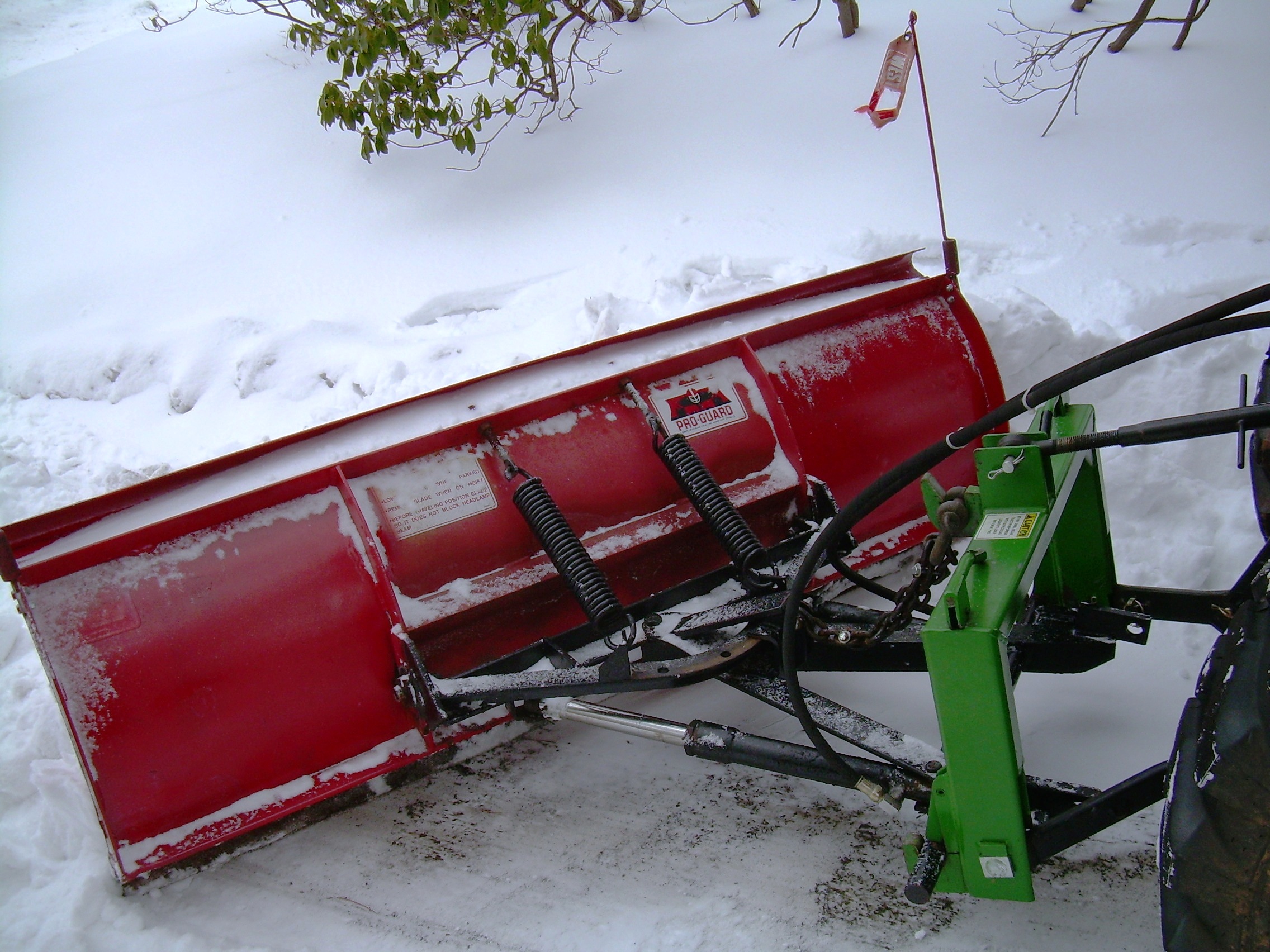

Just a follow up here. This weekend I got a little rough with my skidding winch and made a mess of my 3pt. This was with the telescoping links which are the only reasonably priced units out there. I ended up bending the RH draft link up like a pretzel, BUT it did not break or even give the appearance of beginning to crack. The fork for the lift link broke, but that is because it received a heck of a spreading force.
I recently had the LH lift link split on me so I replaced it with the much heavier later unit and am now replacing the RH unit with the later one.
I should add that this recent issue is purely me being too rough on things. The failure of the original draft arm I chalk up to cheap crappy steel. The failure of the lift link I chalk up to undersized spindly design. Looks like this has all been corrected in the later models...

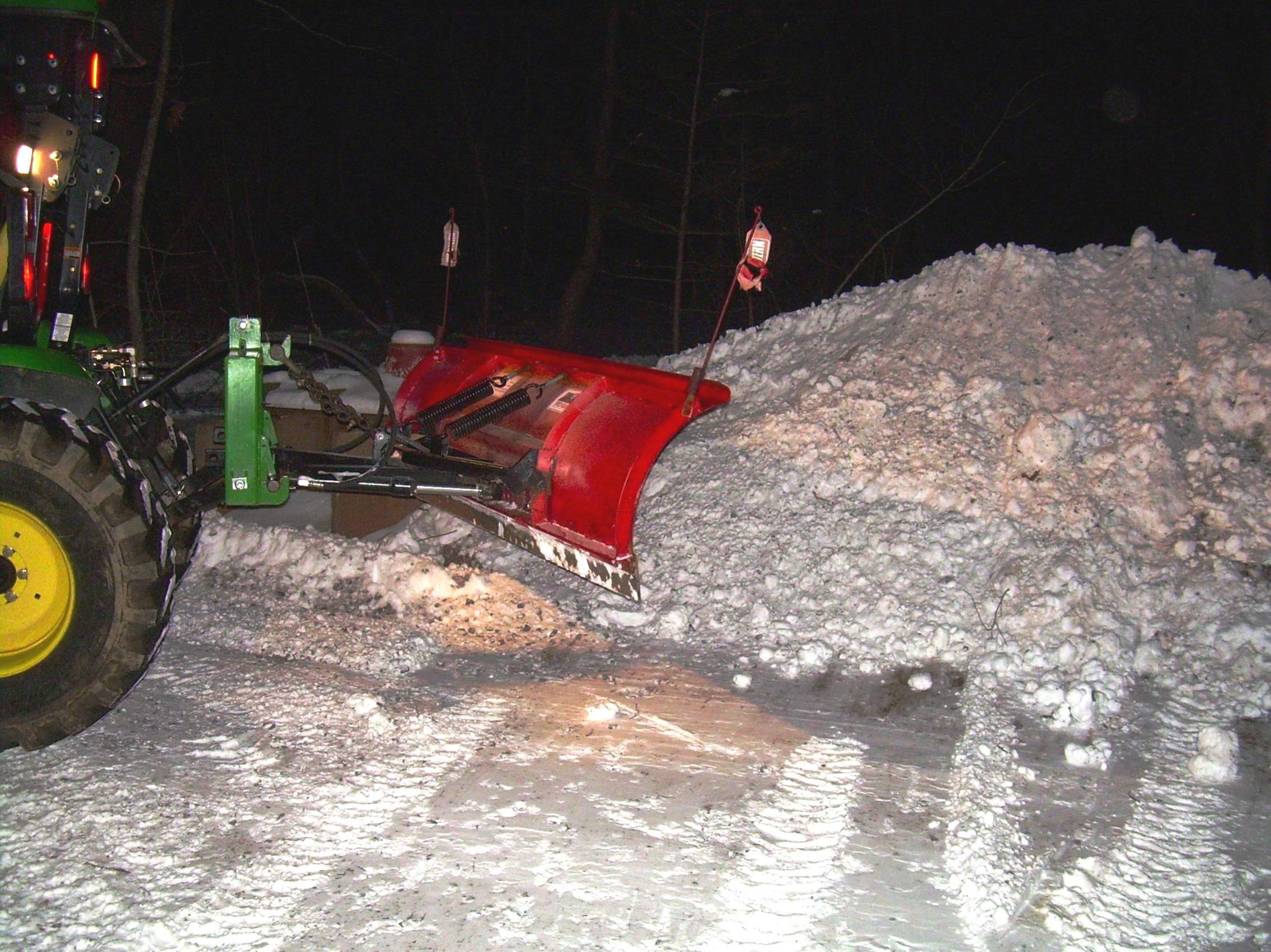

I did bend mine, but that was from ramming snow banks in reverse with a modded truck plow mounted to imatch.
Most would say not an intended use for 3 pt :eek:
