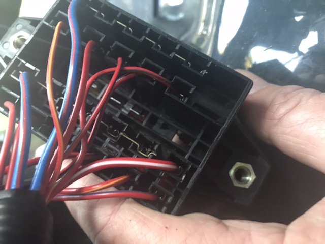

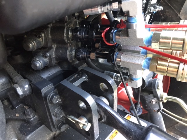

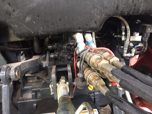

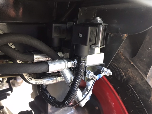

I don't know the part numbers because I just went to my local hydraulic supply place. I got two normally closed valves with two ports on them and two continuous duty coils. I used the trailer connection bracket because I won't ever need to plug in a trailer. I drilled 2 1/4" holes and used 1/4"-20 all thread to make bolts. I cut 4 11ga steel straps 1"x2" and put one on each side of both valves.
I ran a wire from the spare fuse slot in my fuse panel back to two switches I mounted in the cab. Then 2 wires from the switches back to the coils. I tied the two coils together with a ground wire and then took the ground to one of the bolts I made.
I installed tees on my remote disconnects and used 1/4" hose to tie the two ports for each spool together. In my case, I needed 2-15 and 2-17" hoses to clear the TPH.
When I want float, I flip the switch. Just remember not to engage your remotes with the float engaged. Hope that helps. :thumbsup:

Cougsfan makes a great point! My BushHog brand rotary cutter and finish mower float. I never use the float with my hydraulic top link. I added float because of my ditch bank flail. It allows the head of the mower to follow the contour of the ground.
Adding float to my Branson cost me less than $200 and took a few hours of work.

The hydraulic valve idea looks great so l will do that soon as I find the valve. Looked at 2 hydraulic stores today and they don't carry electric units so I might end up ordering something.
I need to be able to pickup the mower to mow hill banks and transport. The mower has a built in flex head but it's easier to just put in the hydraulic. Then I could also add a second electric unit for a 3rd function. Grapple or a tilt on the blade.
