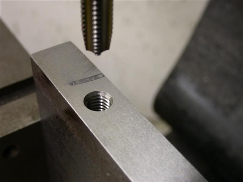

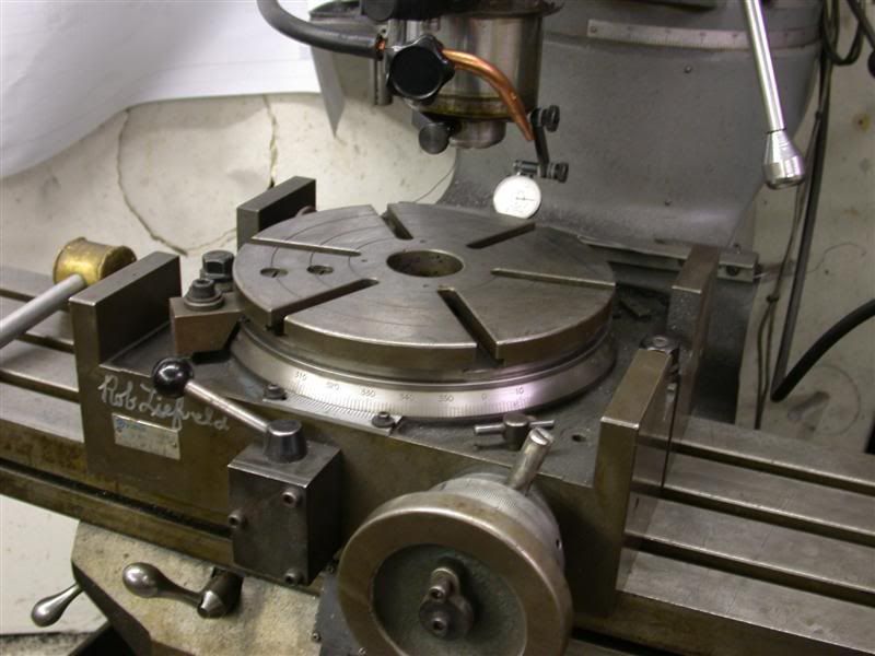

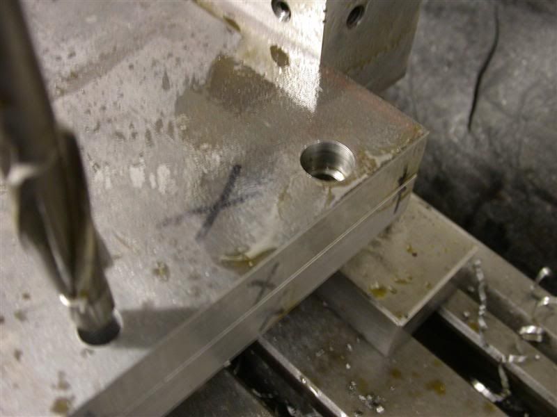

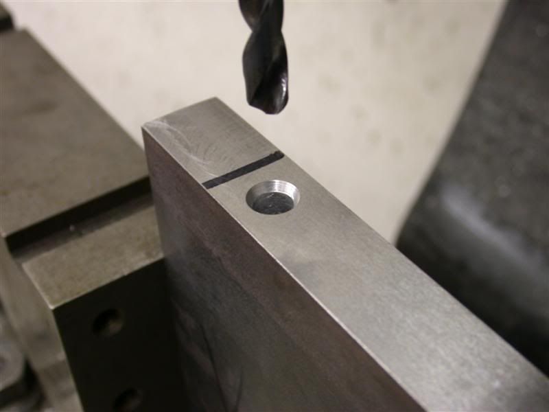

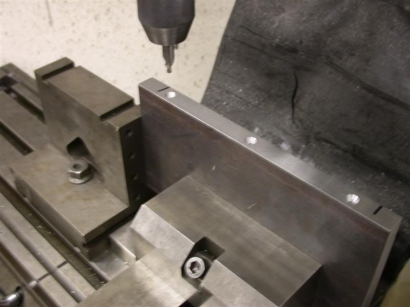

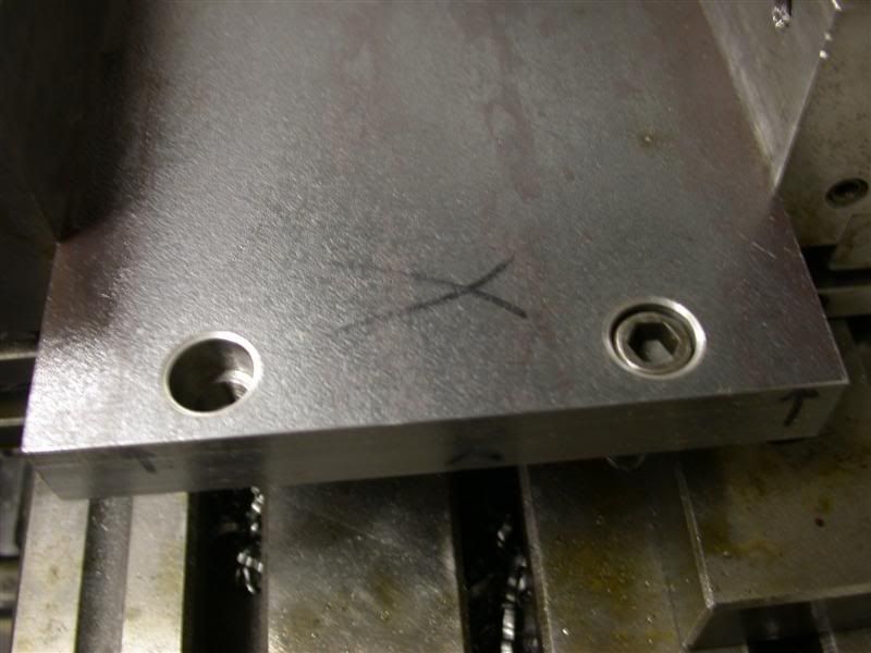

I got the side plates tapped 1/2-13 for the bolts that will hold the hydraulic cylinder on. This is a bottom tap and the holes are shallow so I started them by power tapping in the mill for a couple threads only. Then finished off by hand with a tap handle and a tap guide to keep it on location. The tap guide is spring loaded and keeps pressure on the end of the tap to keep it straight.

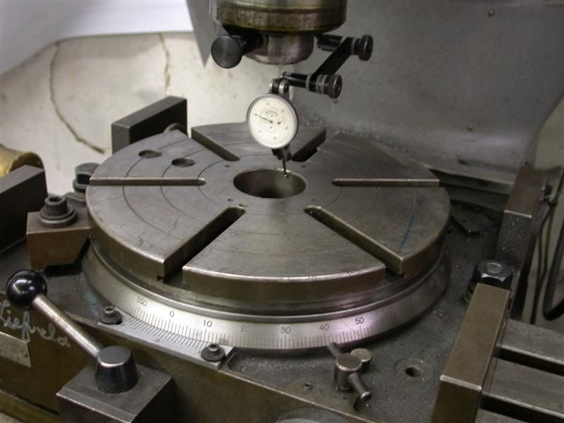

Next, I set up the bottom plate so I could rotary table out the counter bores for the bushing that hold the thrust bearings. I had to add 2 more holes to both top and bottom plates because I had no way to clamp the large plates to my 12" rotary table. ??? So I tapped them 1/4 NPT for additional fill and drain holes.
Here you can see how the plate hangs out over the rotary table. This is what we call a "knuckle buster" set-up, where when you rotate the handle, you get to smash your hands on the plate.
/ 360* Rotating Back Blade Project #49
A couple more shots beginning the rotary table work for the counter bores.
I will switch cutters when I near the diameters (on all the RT work) to establish a nice flat bottom and cut the OD within .010" of finished size. Then I will re-indicate the original bored hole to be sure it is on center of the quill, and use the boring head to finish the OD right on size. I am shooting for a light press fit for the collar. Then I will TIG (heliarc) weld it permanently.
I'll have to do this to both sides of the top and bottom plates for collars and oil seals and also to the side plates for the worm collars and seals. I'll post more when I wake up.
