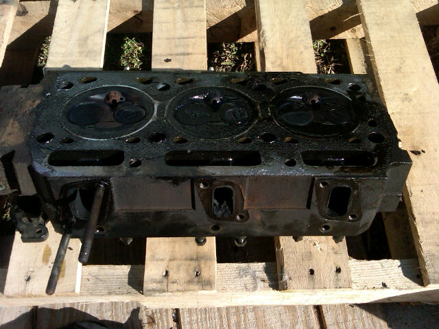

No they only come out the top so you need to pull the head. The gasket is not re-useable either just so I get that info out ahead of time.
Keep me in the loop every step and I guarantee it will run perfect if you listen to me I will be more than happy to keep helping. It has to have even compression on all 3 to run right and you are almost there.
/ 336D injectors #62
You don't have room unless you remove the Crank Shaft. And if you do that Most likely your replacing all the Main and Rod Bearings which I would replace, Seals Etc. Major PITA. You know how and what it takes to redo the Head the only other thing is having to remove the oil pan which is already off if you done the leak down test. "Don't Reuse the "Gasket" If it was mine and I had to Pull the Head. ALL the Cylinders would have had New Rings and be good for Yrs. But that may just be me.;)

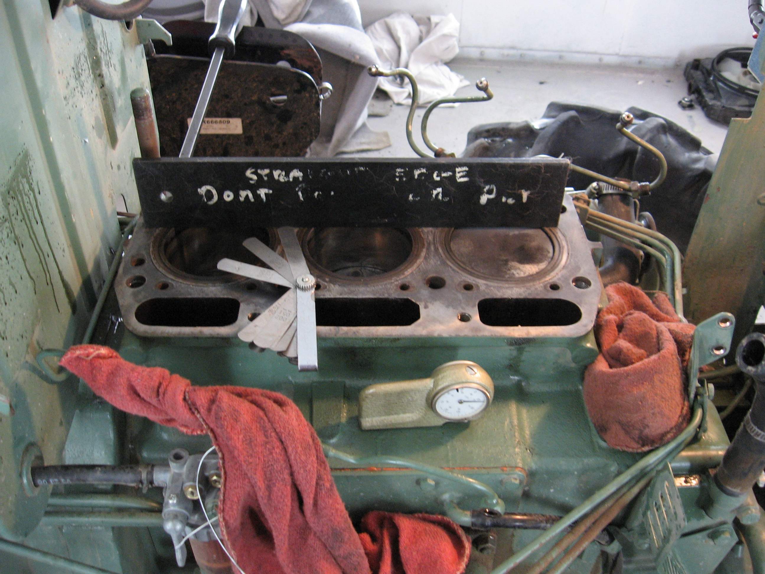

Have the head loose and ready to lift off. the oil is draining so will try to remove the oil pan cover tomorrow.

edit: To add to what Bruce pointed out Vern when you have the head off and can turn it with a socket on the crank bolt please turn each piston to TDC.
Use a dial indicator if possible (you can eye ball it too not as accurate) and measure the piston top to liner distance as best you can may take a straight edge across the liner and a feeler gage between it and the pistons.
A difference of say .050-.100" would make a lot of difference in compression a few thousanths may not. fwtw better take the extra steps now than wish you had later imo.

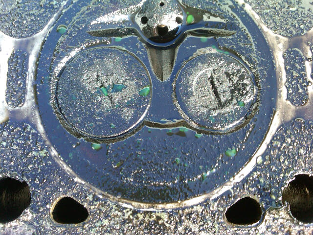

From the look of the combustion chamber for #2 it has had water in there. That will surely bend a rod.
/ 336D injectors #75
If there was water in there it cannot be compressed and something would have to give, a rod is a possiblity.
