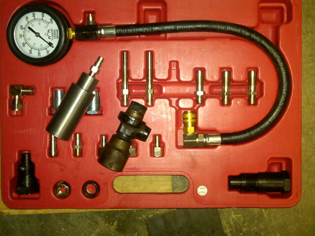

Picked this up at Harbor Freight today - 29.95, I do not like buying there but what little I will use this figured it would be fine.
Drilled and threaded a pc of 1 1/4 round stock, its a couple .100 smaller than the injector so turned a small shoulder to fit into the insulation washer to keep it centered. Raining here yet so will try it out tomorrow.

Well that is a dead ringer for the Hoye gage good find Vern! :laughing: :thumbsup: Nice job on the adapter btw! :)

I bought the HF diesel compression test kit with the fewest adapters. I thought I would tap the top of a junk injector to put in a 1/4" fitting, to make an adapter. (It would also need its internals removed). Has anyone done this?
/ 336D injectors #29
Man thats an awesome idea! Between Vern and his lathe skills and this injector idea you guys have the Yanmar compression test made easy! :thumbsup:
