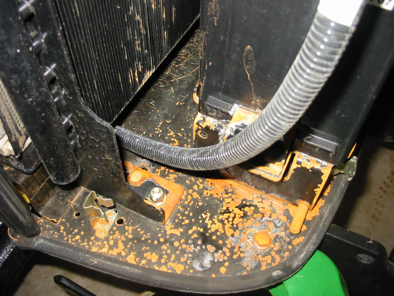

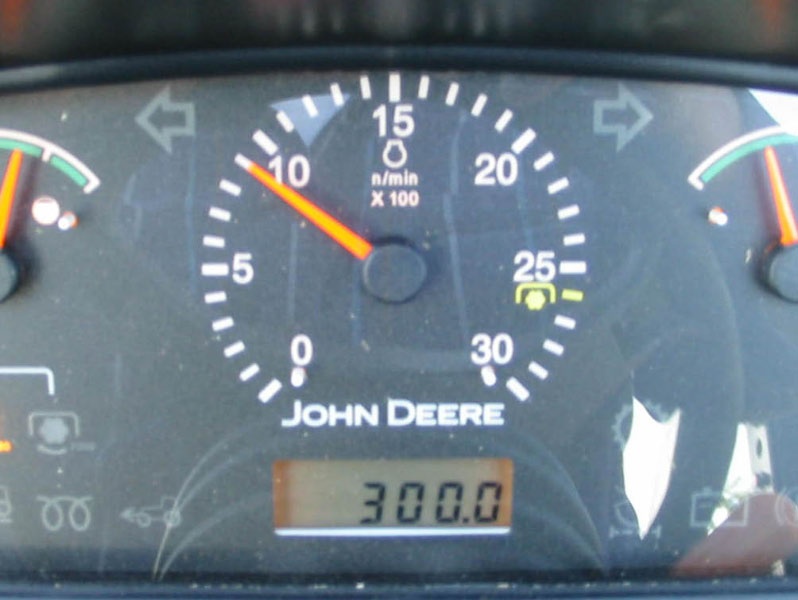

I have owned this tractor now for a little over two years. For me, this is a record. Here is what I took deliver of on 8/18/07:
3320 Hydro, Turf Tires
300 CX W/ 61" HD Bucket
72" MMM
3rd SCV
Remote lines for angle blade on loader
Cool brush guard
Auto cruise
Telescoping lower links
Rear work light
Total price $25,000.00, with 6% MI tax that's $26,500.00 OTD.
I did a 200 hour review on this tractor on 10/16/08 that can be found here.
Honestly, there is not much new to tell. The last year and approximately 100 hours have been nearly as uneventful as the first 200 hours. The tractor continues to perform beautifully. The only things I have done since my 200 hour report were to change the oil, oil filter, and the battery. More on the battery later.
Observations regarding this machine for anyone considering its purchase:
1. So far it continues to give the impression of a solid, high quality tractor
2. The smooth, linear nature of the E-hydro never gets old
3. The auto style cruise control is well worth the extra $85.00 or so
4. I like the telescoping lower links
5. I like the way the loader goes off and on
6. Even though the MMM goes off and on in under 7 minutes, I don't like doing it anymore
7. The turf tires get great traction on snow
8. The "light switch" nature of the electrically operated PTO seems fine on all implements except the brush hog- it bangs real hard when engaging
9. I don't miss the clutch, except for #8
10. The break pedals on the left side make much more sense than having them on the right (next to the hydro pedals) ala Kubota
11. This thing starts better in the middle of winter than a gas engine- no block heater needed

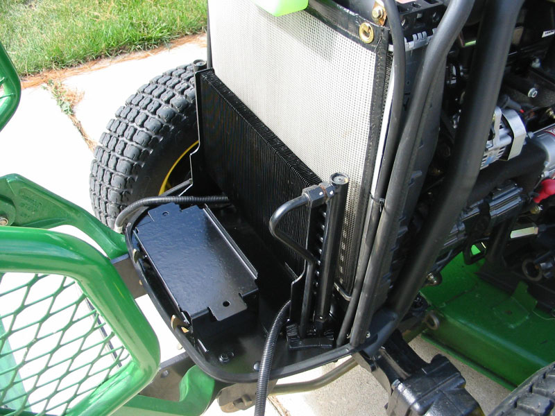

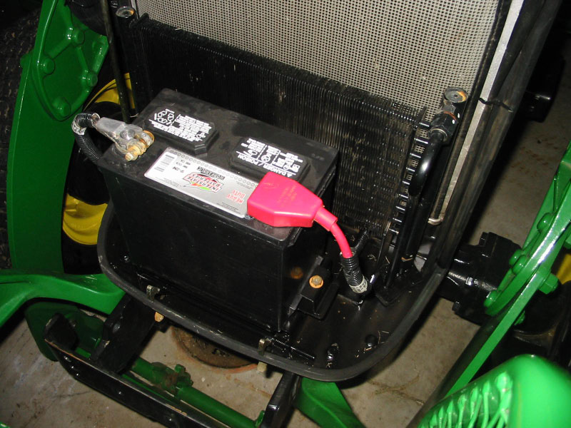

The only real problem I had was with the battery. It never failed electrically, but it leaked all over the place. I knew this was a common failure, and resolved to keep a close eye on it. But alas, I went about 6 months without opening the hood. Below is was I found. The fix was pretty straight forward: Remove the battery, treat with baking soda and a scotch bright pad, paint with satin black rustoleum, replace battery with Interstate unit for $72.00.
Overall, I have to say that I really like this tractor and seem to have finally found just the right porage.

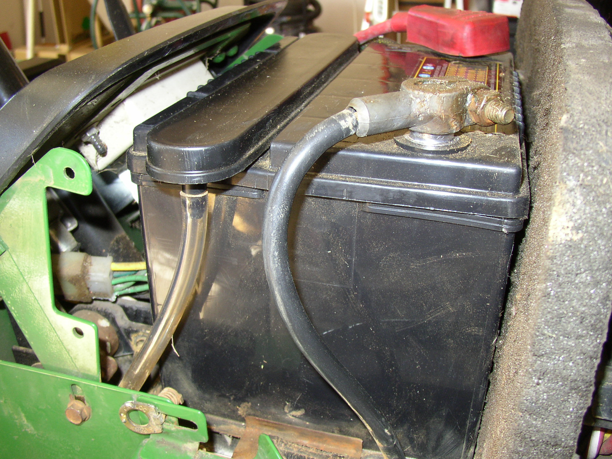

Like many of us I also have experienced the battery corrosion problem. I have done a lot of clean up in the past with my behind-the-dash battery location. The vent caps tend to weep acid in small amounts with the tilt angles and bouncing tractors have to sustain. I really minimized the problem by venting those caps away from the tractor with one common cap and a tube to below the tractor.

JD,
Where did you get that fancy cap? Do you think it would fit my new battery?
Thanks!
KB
/ 3320 300 hour review #4
My John Deere batteries always come with that tossed in the box. Sometimes the parts guy tries to throw it away when he hands me the battery. Since the battery already has the standard caps on it I expect he wonders why it is even there. I suppose there is some application for it that requires remote venting. I have never looked for them separately, but I would check the auto parts shops that sell batteries, or even stop by John Deere to maybe get one free before the parts guy throws it out. My battery is a TY6192.
