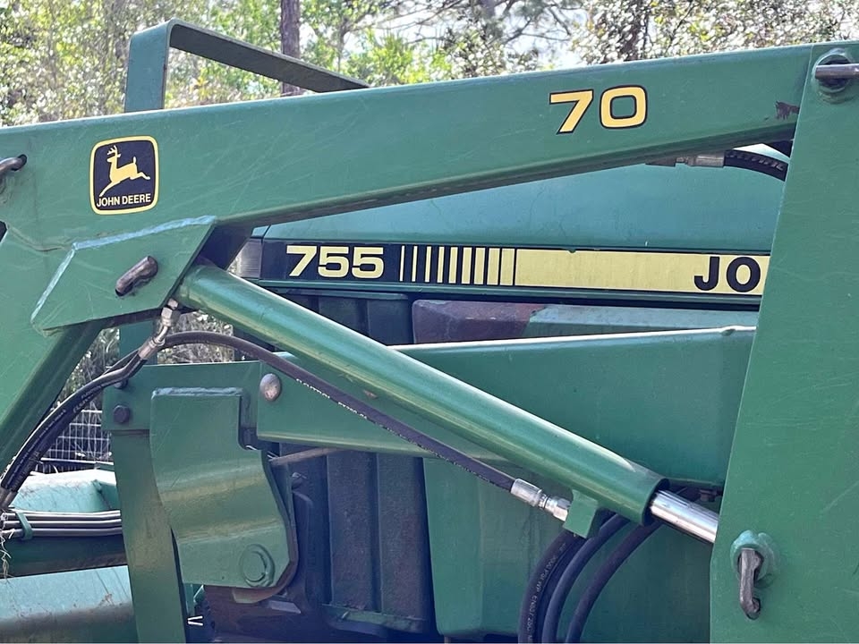

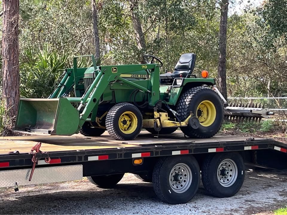

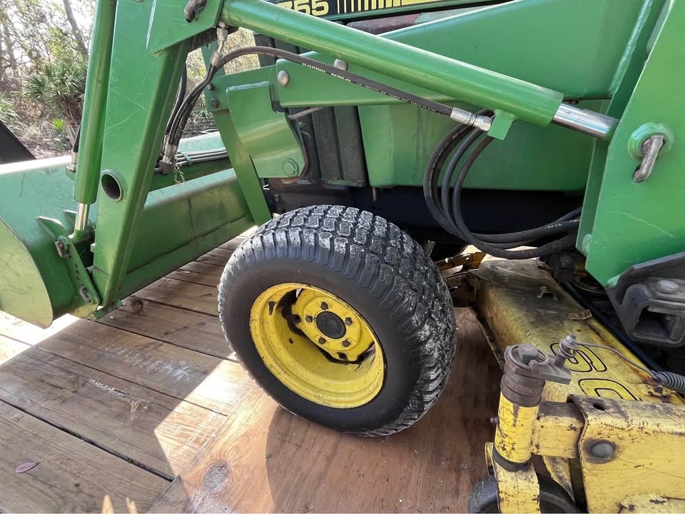

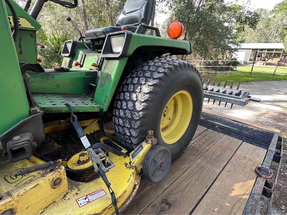

Gonna jump in here. Looking at a 755 w/FEL and 60" deck.
700hrs and looks very clean.
Will not mow much just to move stuff around and bush hog some.
4' bush hogs are rated at 25hp so how about the 755 rated at 15pto?
I've seen lot's of videos of guys running the heck out of bush hogs and even tillers, which I can't even imagine.
I've looked everywhere for a cash tractor and still can't afford anything worth a darn.
This one is 7k and may fit my needs. All new hoses last yr.
Who uses bush hog and what size and any trouble?

No direct experience with the 755, but I ran a 4' Woods M4 brush cutter behind my old Deere 855 MFWD, for mowing trails, and that worked great. The 855 was rated 23 hp engine / 19 hp PTO, if I recall correctly.
Even the 855 was a little light in the nose when I'd remove the loader, so it'd want to pop wheelies going up hill with that small but heavy 4' brush cutter. Wasn't a huge problem, I kept the brush cutter low (or down) when going up hills, to avoid the issue.
Note that the belly mower lift is the 3-point control, but you can lock the mower in the up position, using the height control wheel, when you need to use the 3-point without removing the belly mower deck.

Never seen one using that. The 4' rotary cutter will be fine on a 755. I use a 5' on my 855. Yes, keep the loader on (and the belly mower) for counterweight. At $7k, that looks like a good deal.
