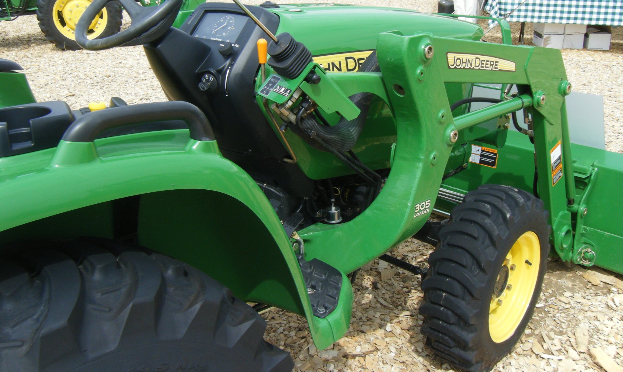

I dont understand why it is non-removable. Maybe not quickly removable. I had an older tractor that didn't have a quick-tach system to remove the loader frame but it was just 4 pins (2 for the loader arms and 2 for the hydraulic rams). I then put in 4 quick disconnects in the hoses. I had an old swingset that my father built that we parked it under wrapped a chain around the loader frame to hold it in place. We then pulled the 4 pins and disconnected the hoses and backed away. It initially took about 20 minutes to do this but after a couple times I can unhook it in about 7-10 minutes and hook it back up in about 10-15 minutes. For a couple times a year it wasnt bad. I would want to do it every week though.
As opposed to pins, this loader is bolted at the base of each mast. It would be a royal pain, and even a greater pain to re-mount.
/ 3032E non-removable loader #13
I was really talking about the whole frame coming off just the front part. Pulling the 4 pins and adding quick disconnects. This is how I did it on my old 8n loader frame.
I see what you are saying as far as the frame on your 8N. On the 3032E, I don't know that there are actually pins in those locations. I know there are grease zerks in those areas, but I don't know that the frame can be disconnected there.
Thanks for the idea.
/ 3032E non-removable loader #19
I suspect you'll find a 24MM nut on the side opposite the grease zerk. If the nut is removed the pin / zerk can be removed. The head of the zerk is slightly offset from the "pin" so the shaft does not spin, so effectively it can only be inserted in one position.
/ 3032E non-removable loader #20
