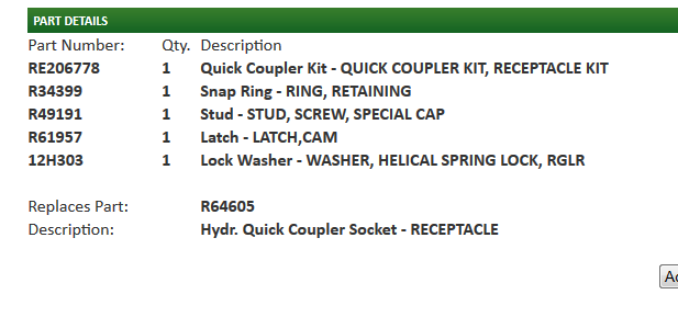

So how much fun is it to remove the JD coupler cartridges and install the Pioneer type? This tractor has one 20 series coupler body and one 10 series body. Is the procedure pretty much the same for both types?

What is the part number? You can find it in jdparts.com.
/ 3020 SCV coupler conversion #5
I'm not aware of a conversion for 10 series couplers or 20 series couplers on pre- side console tractors ( up to 1969).

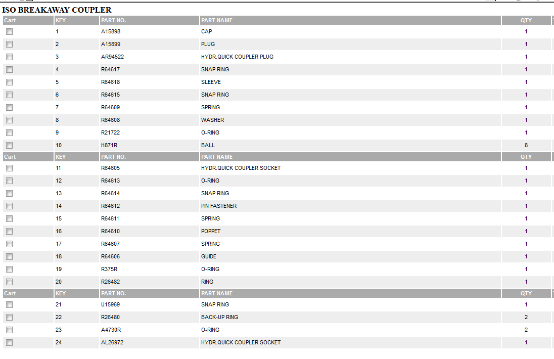

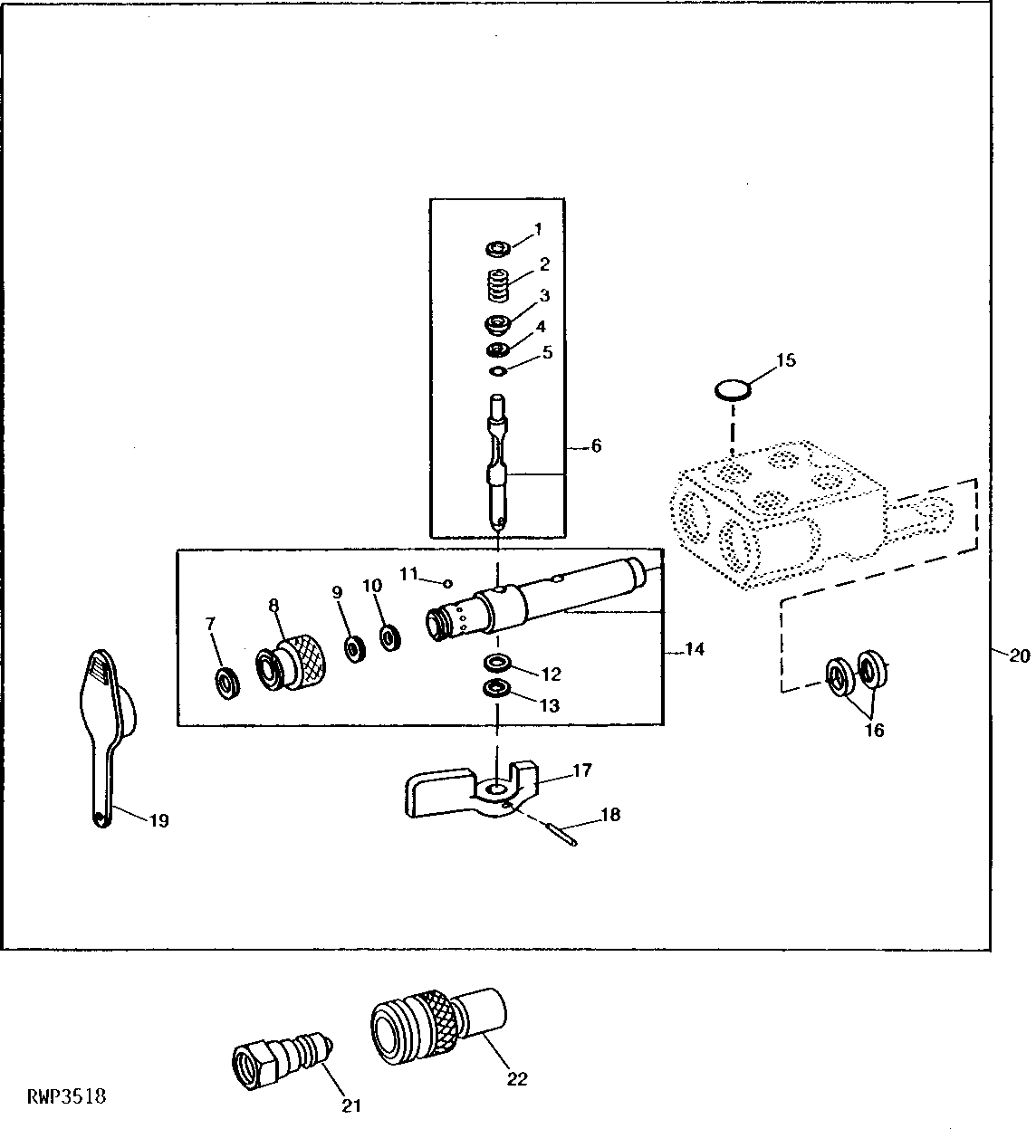

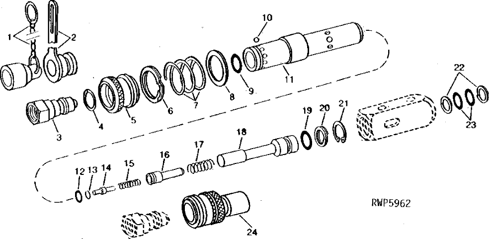

/ 3020 SCV coupler conversion #6
There are ISO kits for both 10 & 20 rear breakaway couplers. This is the part number for kit for 20 series RE206778 Quick Coupler Kit - QUICK COUPLER KIT, RECEPTACLE KIT 146.70 USD. Kit part number for 10 series is the same plus some other extra parts. IMHO the spiral back up washers(parts key 20) are a PITA to install correctly.

The man said he has the kits. I'm just wondering what does it entail to put them in?
/ 3020 SCV coupler conversion #8
IMHO all that's required for kit installation is mechanical ability & PATIENCE.

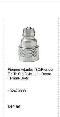

Aren't there adapters you can install (just like a hose end) then an ISO hose end connects? At TSC maybe?
/ 3020 SCV coupler conversion #12
Zebrafive
You mean similar to these.
/ 3020 SCV coupler conversion #13
YES! Accomplish the same thing at much lower cost

Already suggested that. The man wants the cartridges changed.
/ 3020 SCV coupler conversion #15
Often the change to ISO coupler barrels is driven by the reality that the original cone style couplers are worn out and leaking.
