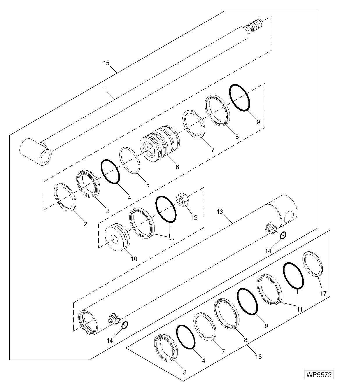

I have rebuilt mine which are similar, and talked many others here on TBN through it. It is not rocket science.
The seal kit is part number AH176274, and list's for $29.69 on jdparts.com. Below is a breakdown of the cylinder:
KennyD, thank you, that is fantastic.
