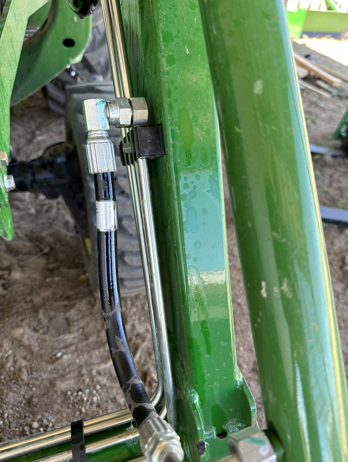

pulling up some rocks and the lower fitting on the curl cylinder's hose started spurting fluid where the hose end threads onto the hydraulic line. I someone post a picture of a damaged o-ring which they claimed to be a typical culprit. Is this a common issue when pushing the loader to the edge of its limits?
can I replace just the o-ring or does the entire hose need to be replaced?
is there a heavy duty version that I can install so this won't happen a 2nd time? ran across a 5800psi hose on amazon that was well reviewed-anyone try one of these?
the culprit is the fitting near the top of this picture.

Have you tried just tightening it up, making sure it isn't loose.
   / 3038e / 300 loader line sprung a leak-better fix?
not initially, but I checked it and it's loose because the o-ring blew out. hope it didn't send pieces of rubber into the system.
