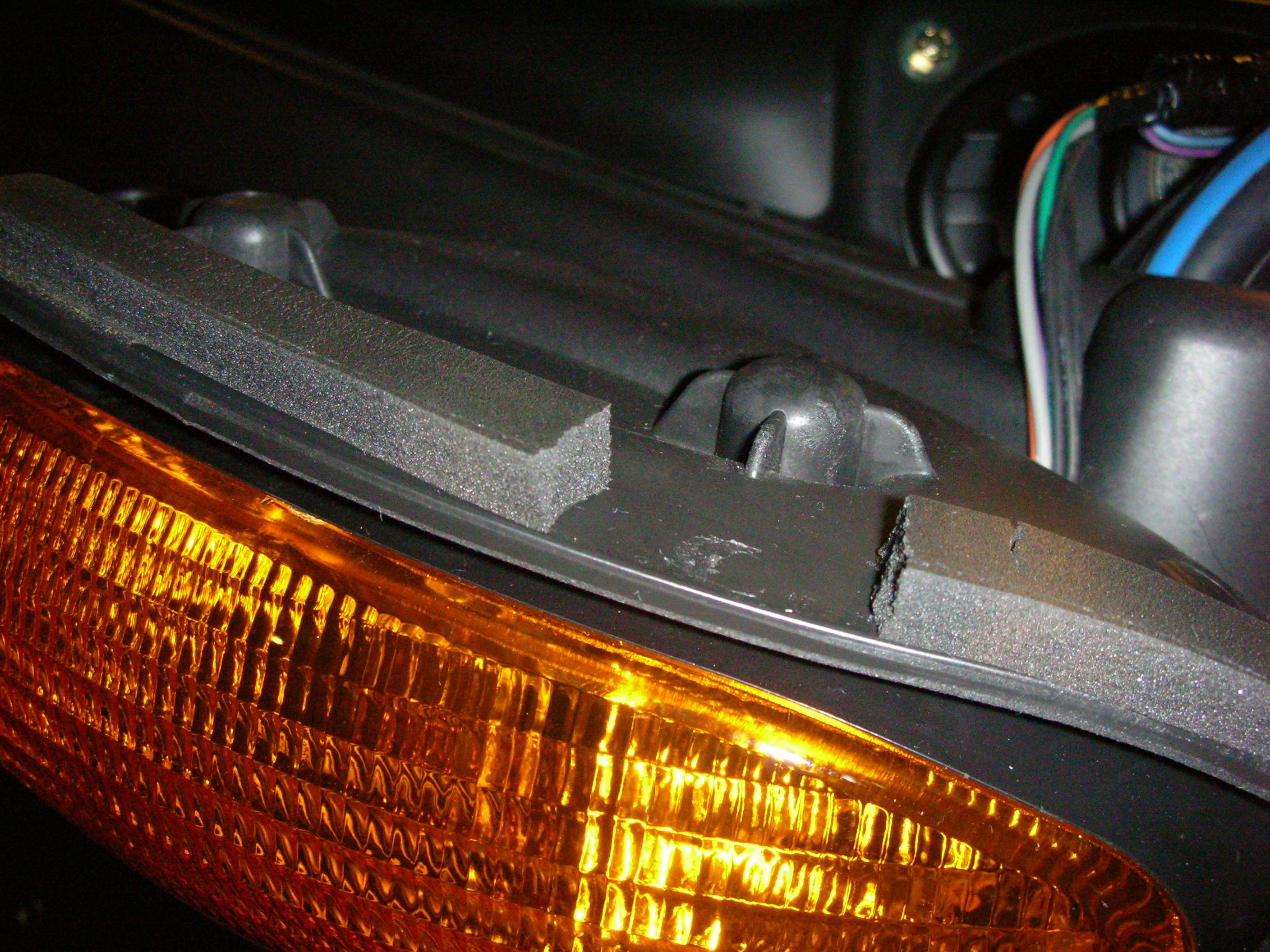

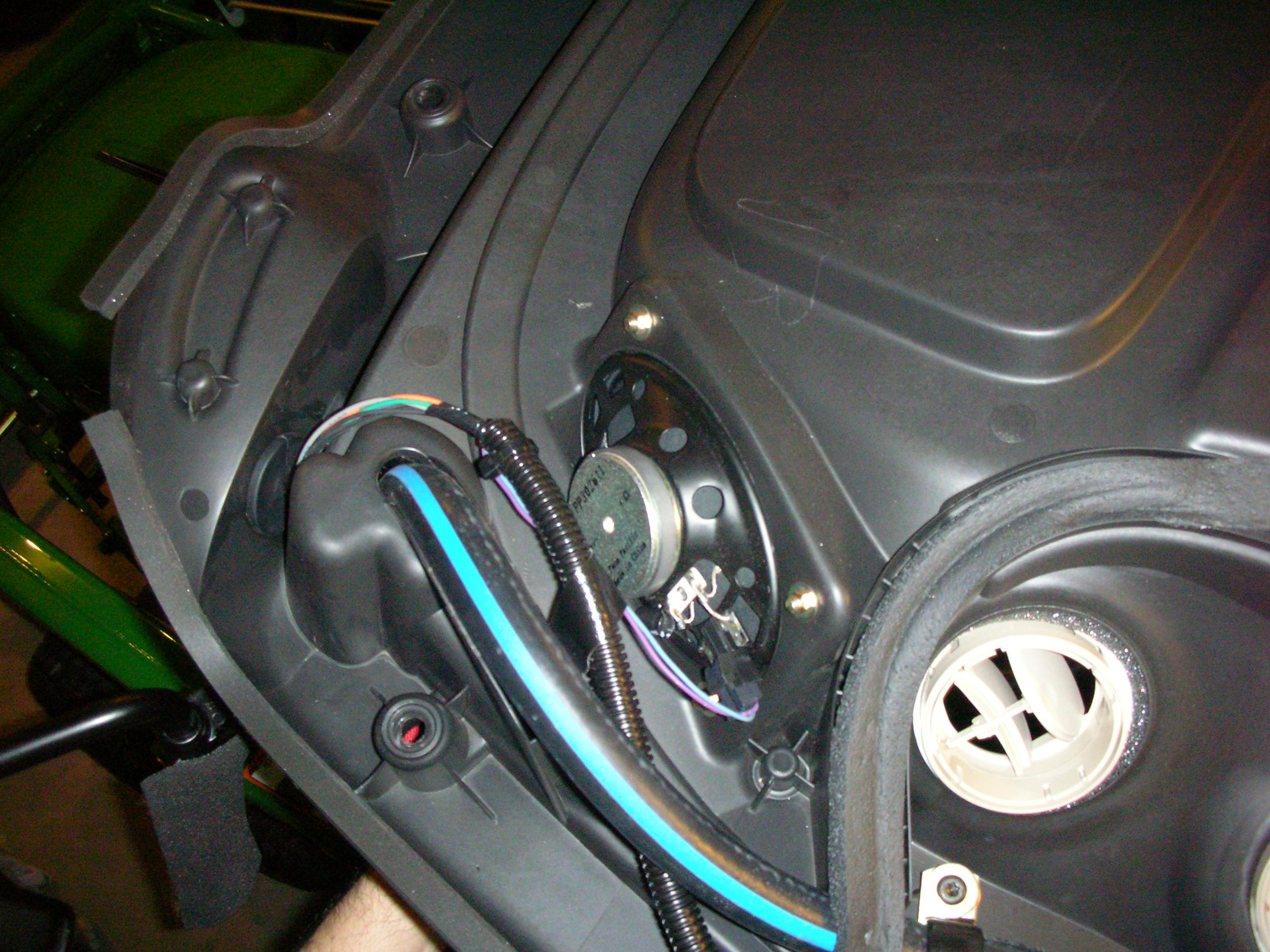

It was about 88 degrees here today and very humid. I use my 3720 cab to bring some straw out to the garden, when I got there it was so nice and cold I didn't want to get out. One down side of having the cab! The things that I have notice affecting my ac performance are dirty cab filter and dirty condenser. I clean my cab filter probably every 10 hrs or so and the condenser and radiator get cleaned whenever I wash/hose down the tractor. I use an air compressor to clean the cab air filter and a garden hose to clean the condenser. I'm always amazed how much dirt is in the cab filter. It's maintenance that I found must be done to keep the ac working properly. Also when I did my radio install and had the roof off I fix a lot of tears and cracks in roof top seal. I was socked at how many there were! I had read previous threads that stated this was an issue that affected ac performance. Something to check anyway.

Only thing I haven't done to my 3720 cab is to remove the roof and check for air leaks. Will do it one of these days when the weather is right, eg, 70-80 degrees. I do clean the filters and screens frequently as you mentioned. I guess I'm just plain spoiled by comparing with the heat and A/C in my larger orange tractor (M8200). Don't get me wrong, I do really like the JD 3720 for what I mostly use it for -- mowing 5 acres lawn, mowing hay fields, and blowing snow off 3000 foot driveway --- just a little disappointed with the anemic heat and A/C system.

Did you check the roof for gaps in the insulation? My 3520 get cold with AC on and hot will Heat on, and it works very well sofar.

Get it checked by another dealer...when I got my tractor this spring I had them install the Radio Mount Kit & CD Player...when the popped the top they found the gasket to be torn and such...they warrantied it and installed a new gasket all the way around. The tech also told me if I needed to pop the top for any reason, if there was ANY Gaps, to put another gasket in as the roof to cab seal is imperative in having it blow hot or cold.
I can say even on the hottest/muggiest day this year, I've had to crank down the "Coolness" because it was getting cold in the cab....There is something wrong with your unit forsure.. "Best they can do" is obviously nothing...

I will guarantee that you have gaps in your roof seal. This is a well know problem and if your dealer can't run a DTAC and recognize the symptoms then you need a new dealer. After the fix was made on mine the A/C will make you put a jacket on in 90 degree weather.
I agree. In fact when my dealer has had the roof off mine he put a new foam seal on the edge. I think he said there is a service bulletin on this. If it is sealed tight it is very cool inside. Great to mow in the 80 to 90 degree heat.
