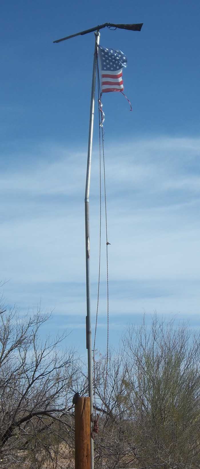

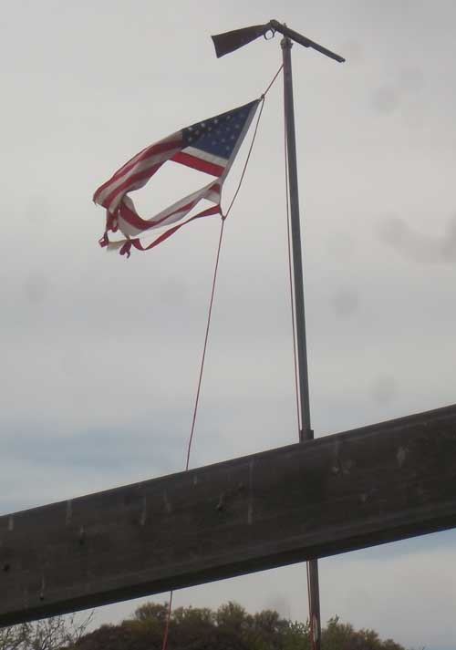

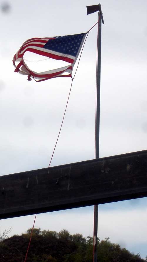

Might of had some wind here. Near new 600# rope & bent the sheet metal rifle stock. Pole it's self doing fine.
Rope will be replaced with a small steel cable.

Yeah, there might have been some breeze there...
Regarding you use of cable for the halyard... I would be hesitant to do that if the pulley in the truck is plastic. My pulley was nothing to be proud of, and the *last* thing you want to do is have to replace the truck.
I've switched to a rope with a very thin cable inside of it.

Hi, Where did you get that rope??
The pulley is either alum. or steel, can't remember for sure. Need to lay the pole down again & straighten the stock. Will put a reinforcing strap on it.
May even replace the flag. :laughing:

I can't find the email, but I usually order from this place.
Flagpole Warehouse: ,Nylon Wire Center Halyard,
I went up to 3/8" after having so many problems with the 5/16" nylon halyard fraying and wearing out quickly.
The toughest part about using the wire core rope, is knotting it. A square knot simply won't work. I found this helpful video demonstrating a proper knot for this application:

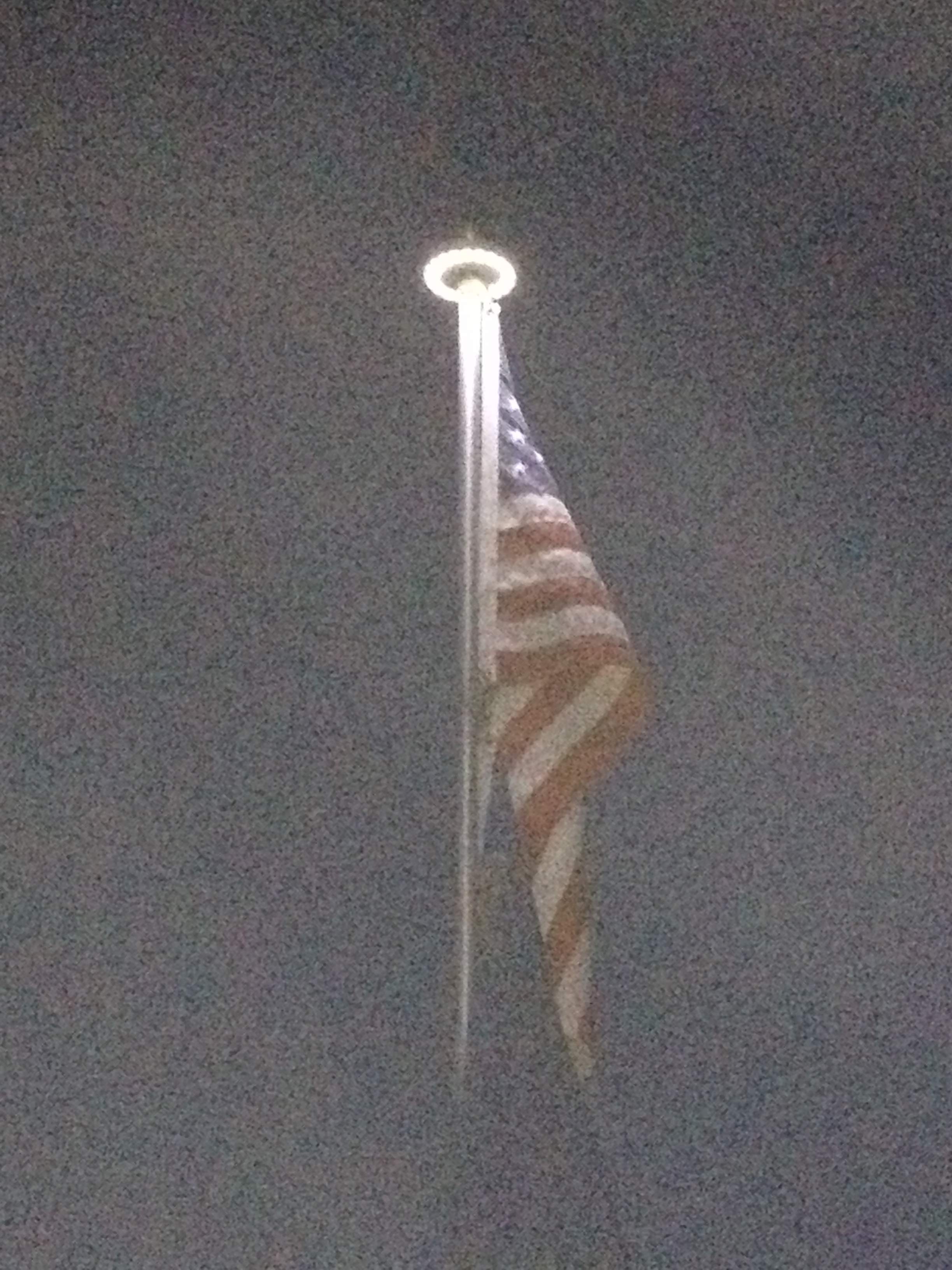

Have thought about solar lights. Looked at that one, don't think it would last, sun here eats plastic much too fast to be practical. And it would increase my already high wind load. A ground based unit would be better & easy to replace. Or when possible run some 110 current out there. Actually want to run 220V so it can be used of most anything.

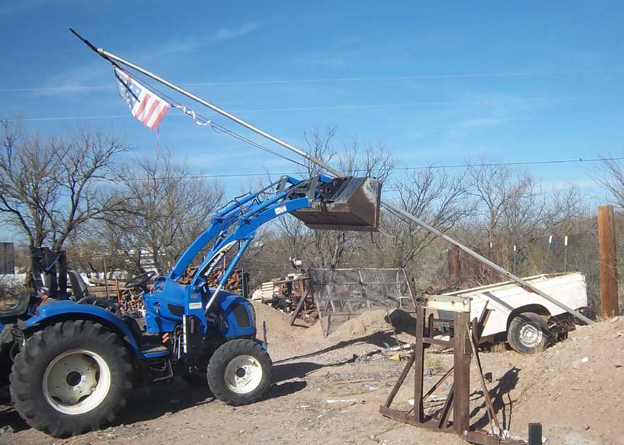

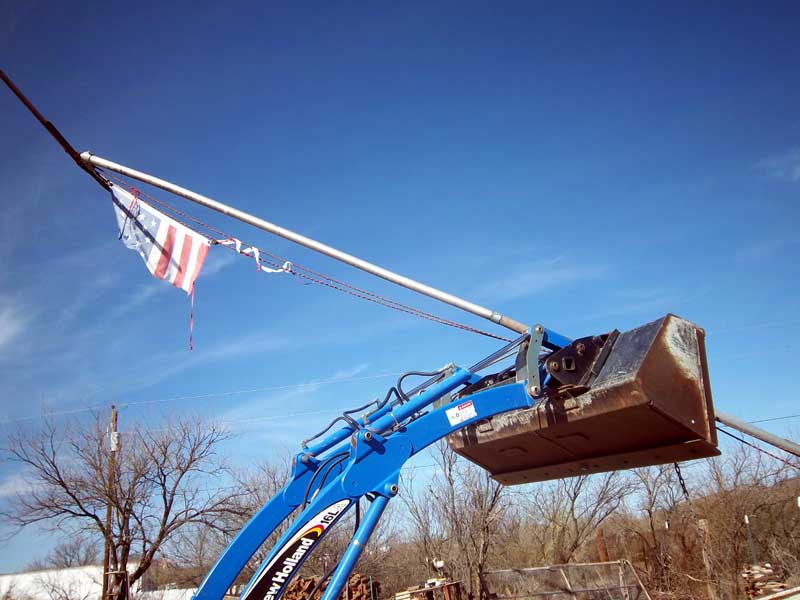

In the back ground of the picture is an old chop saw used for wood cutting. Pain in the back side lowering or raising the pole.
