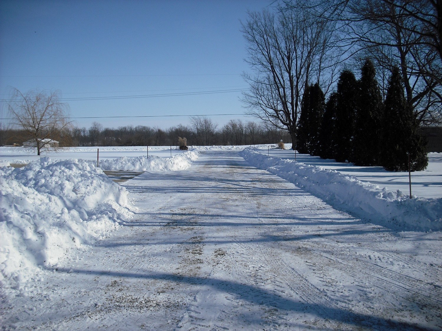

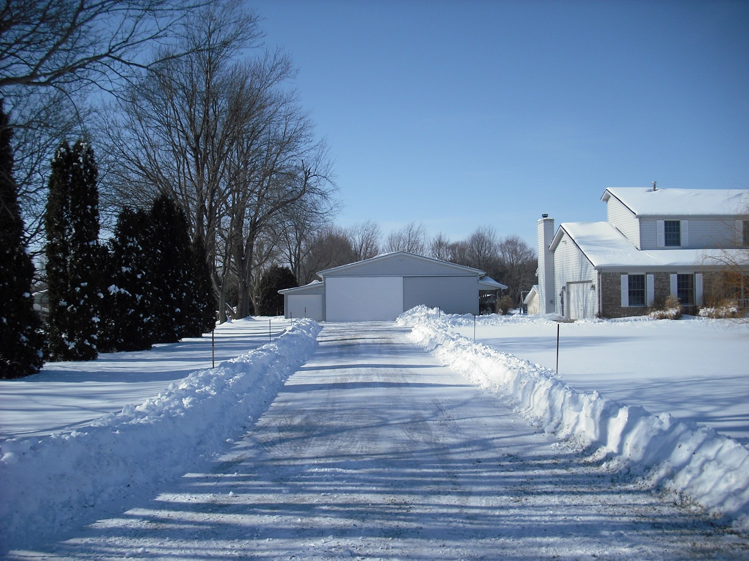

I use a 7' Woods HD blade for snow removal the last 5 years in Northern Indiana and it works great. I am pulling it with my Jinma 284, 4x4 tractor. It has a FEL and weighs 5,200# with me and the blade on it so its a heavy little beast.
Only thing I use the FEL for as far a snow goes is to push back the piles.
Here is a couple a pix's after a 14" dump a few weeks back.

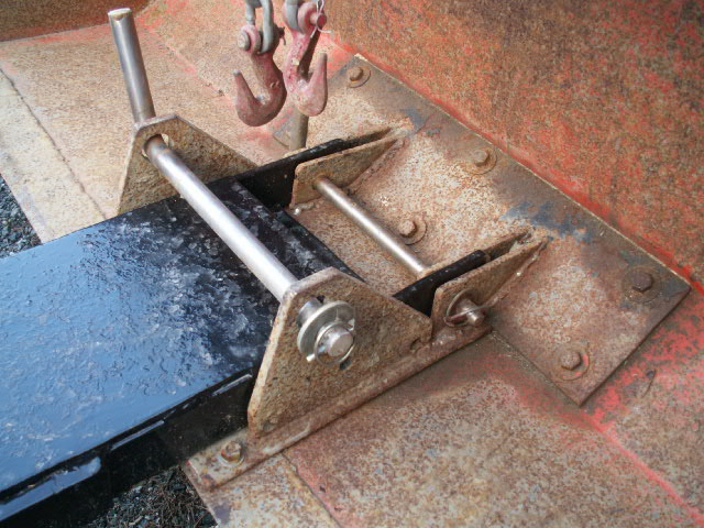

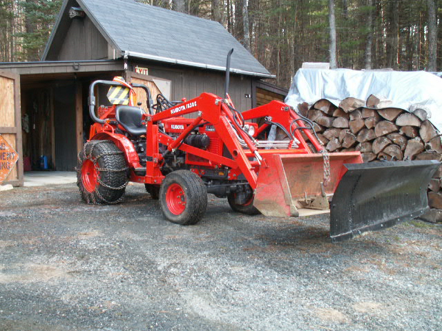

I kinda use the same setup as Radioman.
BB to pull snow from buildings also extend blade to right side sort of winging back the snow banks.
Front plow attach to bucket for quick plowing,than quick pin pull allow to use bucket.
Visit farm auctions etc. they have good second/third hand plow setup at low cost.
Been useing my setup for 13 plus years never had problem.

Loaded tires?

Loaded tires?
Wedge
Yes, just the rears with Windshield Washer Fluid Adds about 340#. The tractor alone weighs 3,800#, the loader is about 800#, the blade is 400#, and me at 165#.

Pretty slick bit of engineering there, Thomas. I'd like to see the wood stove that you plunk those half rounds into, too!
I'd have to hire the neighbor kids to come over and load the stove...
