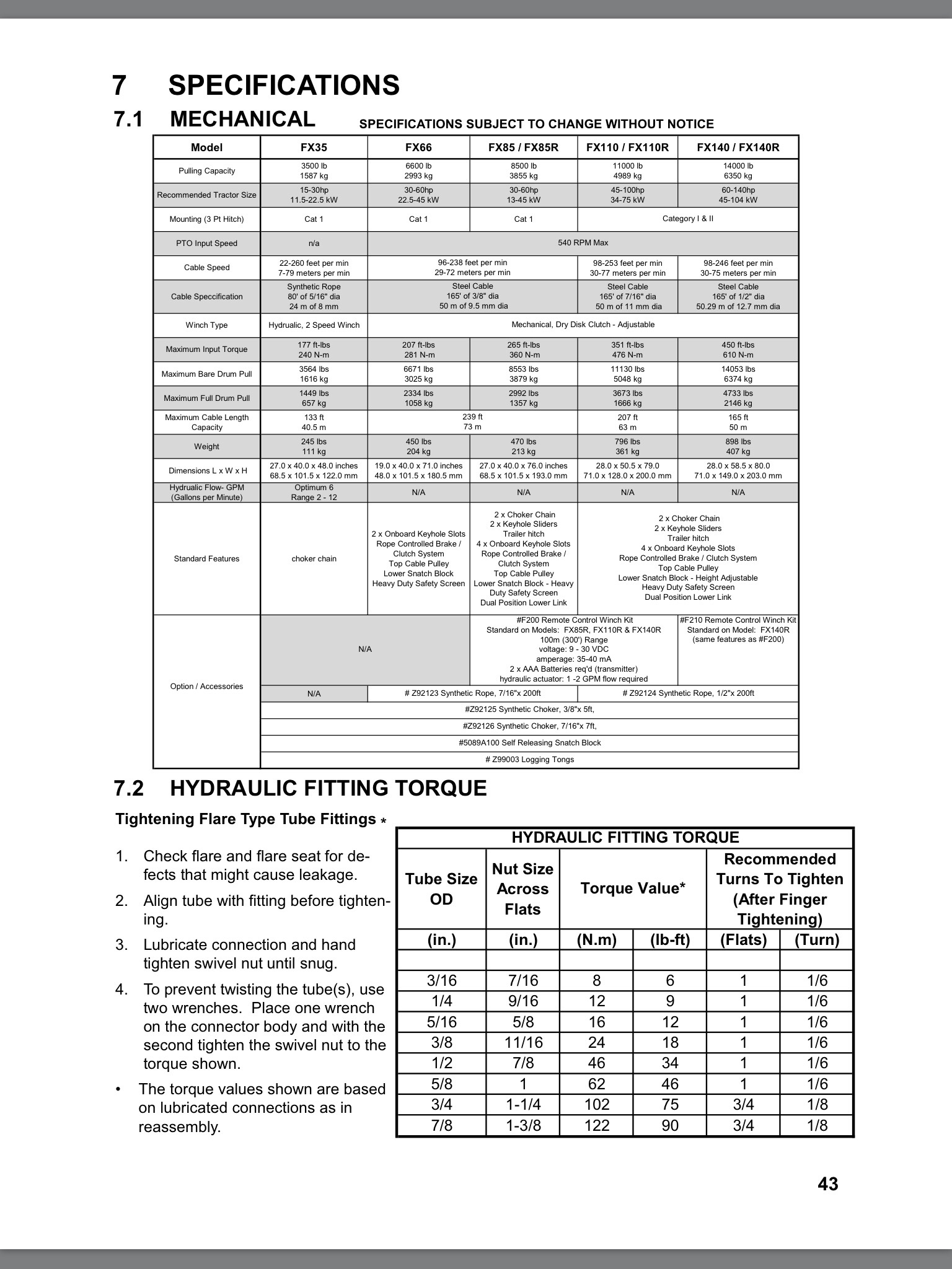

The Wallenstein winches are rated at the bare drum pull, my FX140 will pull 14053 on a bare drum but drops to 4733 on a full drum. It's a fantastic tool and would buy another if anything ever happened to the one I have. Here's a page from the manual showing bare and full pulling rates for the different models.
Awesome data deerherd! Thanks for posting that.
Rob, it appears that Wallenstein no longer rates their pulling capacity of their winches by the "full drum" number. If your model is rated this way, that's great, but since they no longer do it that way, it's not relevant to new shoppers. Also if interest is that apparently they changed their overall pulling power deerherd's got the biggest one they make, but his is still rated at something like 10,000# less line pull than what your manual states. So.. I guess they don't make them like they used to. Either that, or there is a typo somewhere... As you said, though: it doesn't matter. They're great tools to have around.
I see that...
The one thing that will change the pulling power that hasn't been mentioned is, the size of the empty drum. (diameter AND width) That could be part of the different readings between all of these winches.
Personally, I like the FX series of Wallenstein winches better than the new series, and knowing what I know now, IF I was in need of a new winch for what "I" do, I'd probably look for an NOS FX model first, as the new series hasn't been out all that long...
I looked at most of the other brands before I bought my winch and I'm glad I bought the winch that I did... Wallenstein build a GREAT well designed winch...
