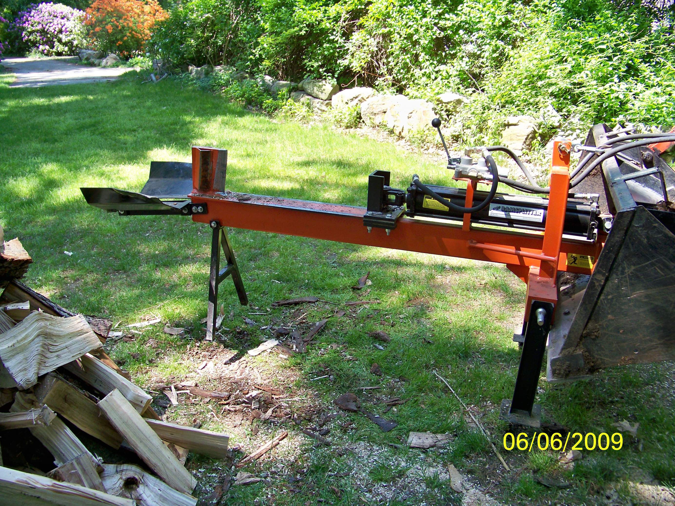

I have a 3 PT with my B21 run off the BH connection (two hyd pumps) splitter from Doug at Ramsplitter with a outboard tray after the head that catches the big pieces - I rest the large chunks on that while spliiting.
It works well - the GPM will dictate the speed of the ram mostly - I wouldnt be so concerned about the tonnage.
Here's an older pic of my setup - mounted on the FEL so I can use my BH with Thumb to lift and cut the logs then swap lines and cut. I cut about a half cord then split it.
Also that front Y leg is held in with a pin so remove that using the FEL drop it to the ground for the big oak pieces.

Thanks JJ for the "tonnage/size" info. I would agree using the ports already there for the splitter - just put some disconnects and you have a nice setup. Do you have a thumb on the hoe? That would make for a nice setup..
When I got my splitter I had them upgrade to the 4" cylinder 2" shaft and it splits everything I have encountered so far.
The only drawback the larger the cylinder it takes more GPM so is slower to fill. I run my B21 at 13-1400 RPM and its quick enough for me to put it in return mode, then get another log in the splitter before it retracts all the way.
So "slow" doesnt overwork me and still get a decent output.
