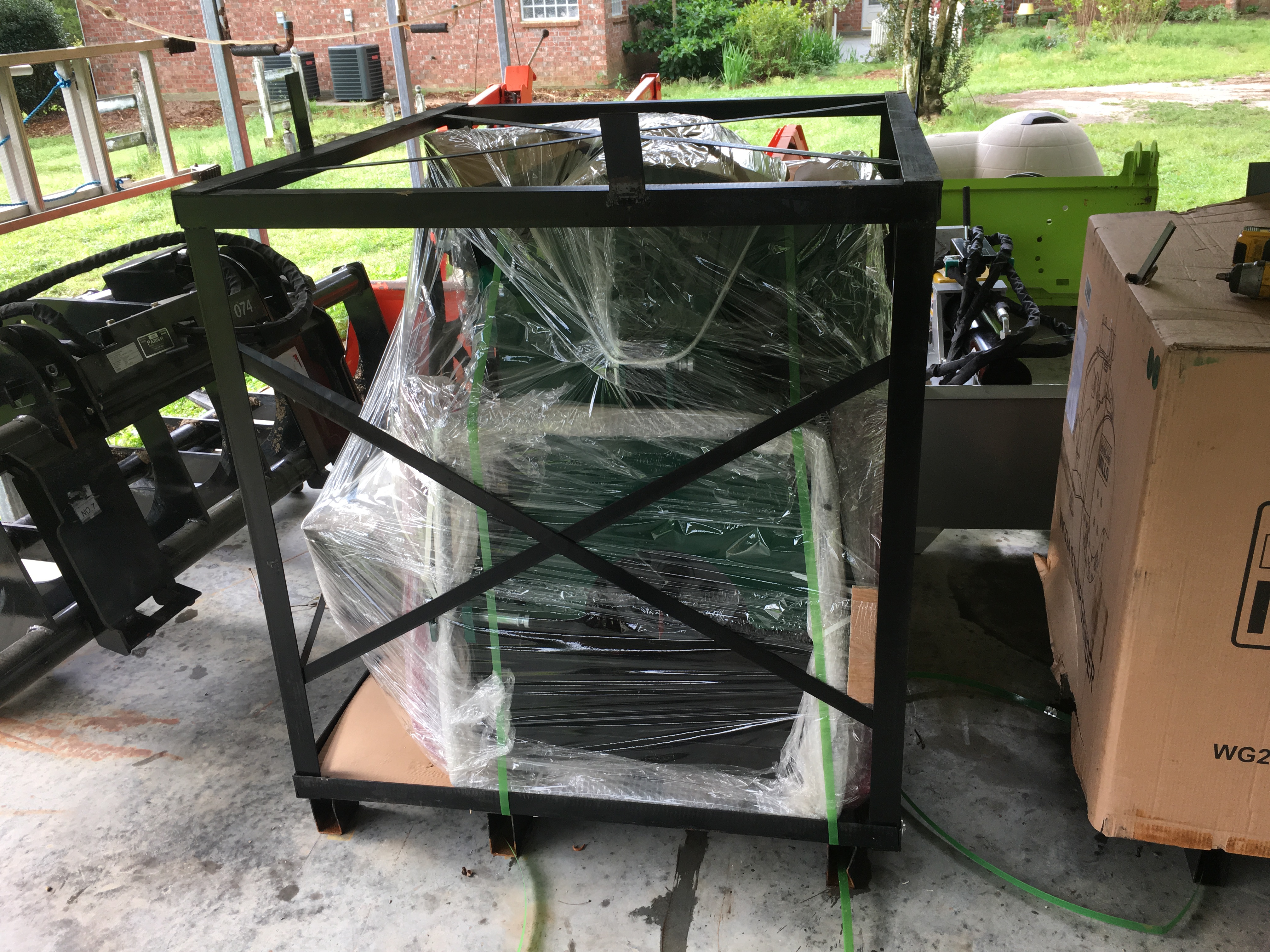

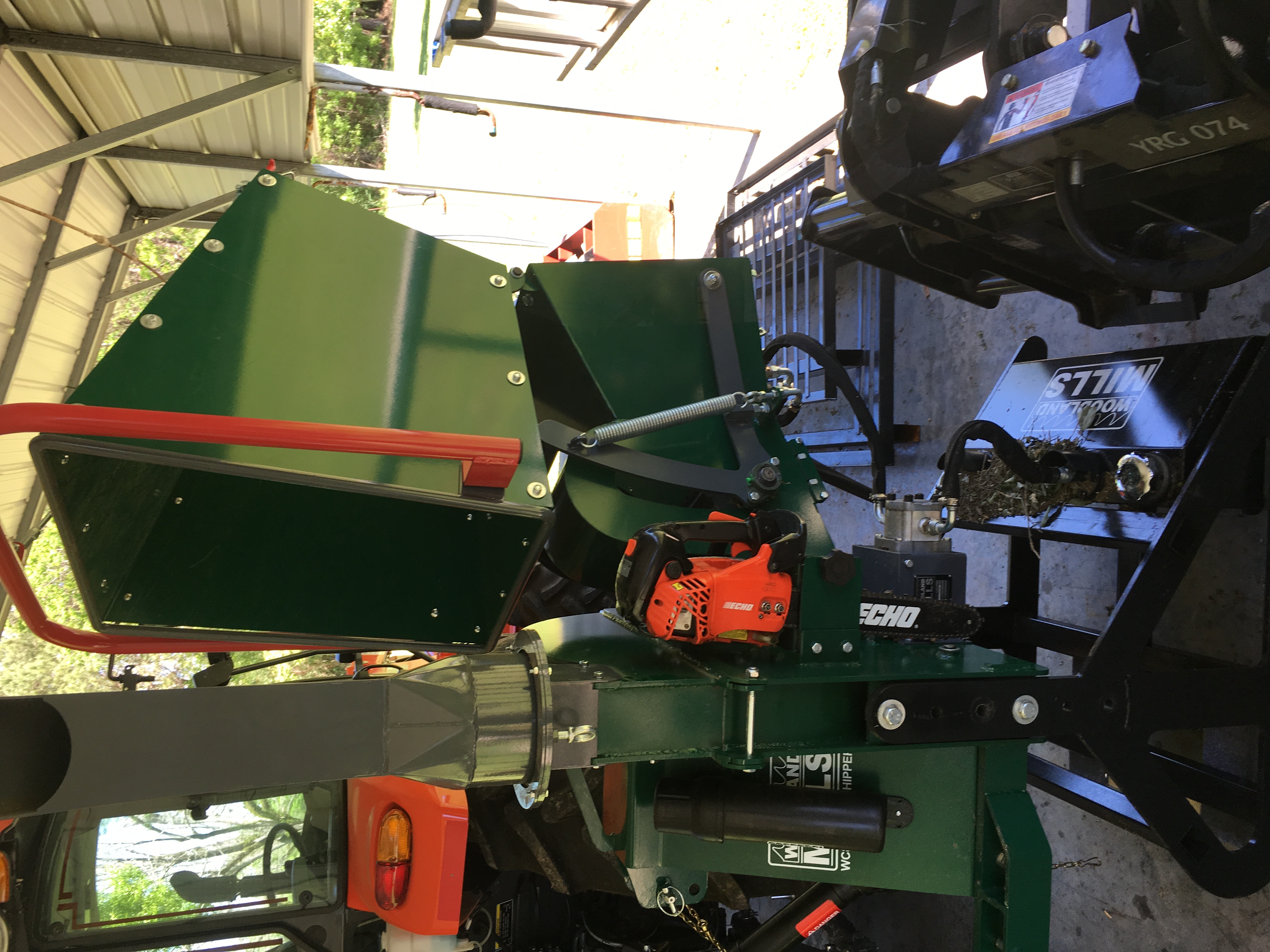

Yes the shipping frame is an nice surprise, the WG24 grinder comes with a nice smaller one too. I wonder why they talked you into the smaller unit? The WC88 has a slip clutch PTO shaft instead of shear pins. I also thought the Woodland Mills looked to be a better designed and built unit although their are great reviews on it and the Woodmaxx units. The one bolt, clam shell opening for clearing or blade service is nice. The Woodland Mills detailed video on youtube is what sold me. I live on the Gulf Coast and received my chipper and stump grinder exactly one week after ordering. The order process was nice and easy and they transferred me to the tech department to discuss some questions I had prior to ordering. Great company to deal with IMO rather picky opinion. Both the chipper and stump Grinder come with nifty chainsaw mounts also which are really handy.
