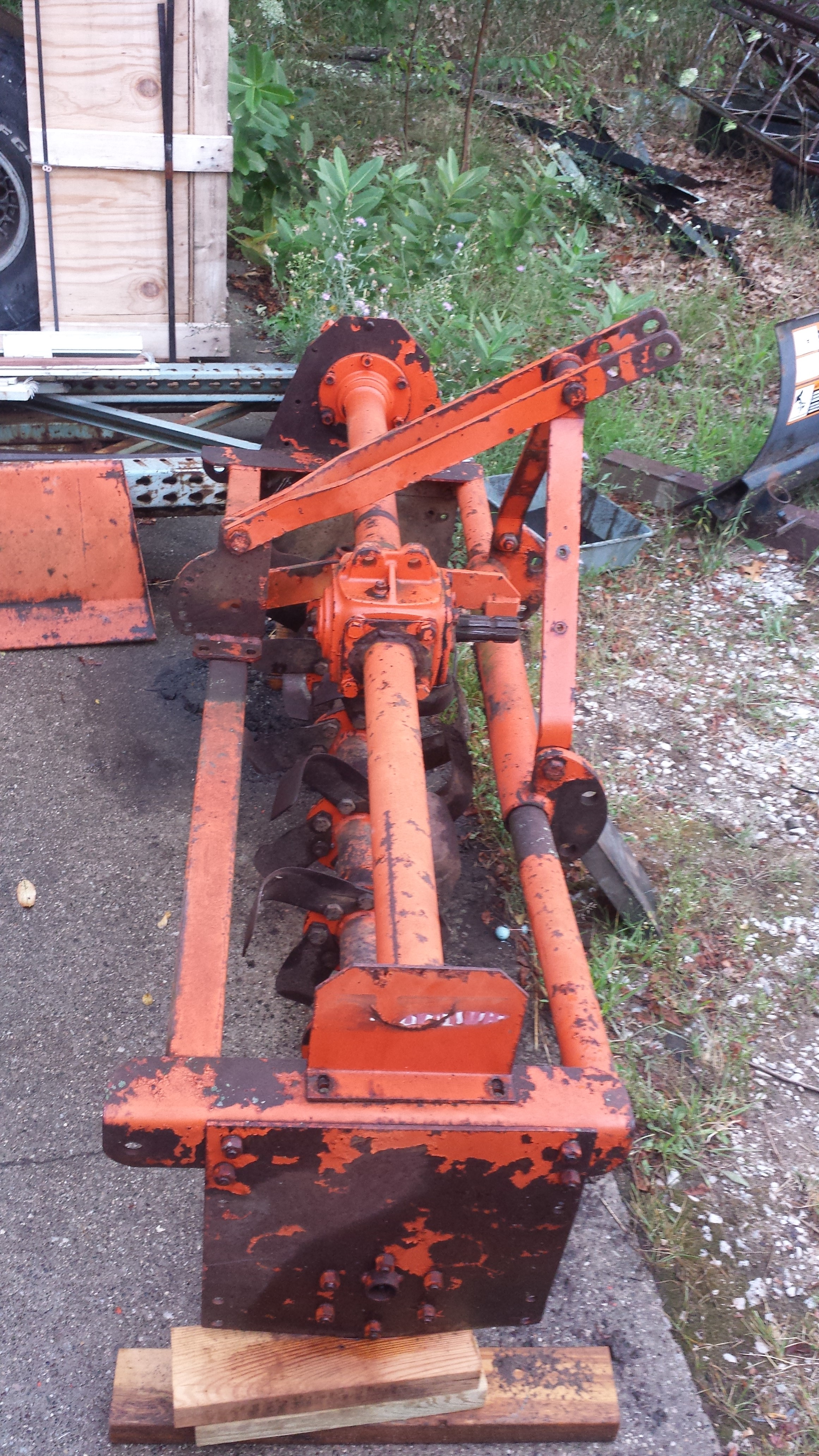

I picked up an old 3 point rototiller a while back and have not been able to identify the make. Of course, I was not smart enough to take pictures of it before I started tearing it down to "refurbish" it, so I don't have any pictures of the entire unit handy. Here is a short list of facts I do know:
1. It appears that it was originally orange in color
2. It has a Comer gearbox, made in Italy
3. Chain drive
4. 55" working width
5. 4 tines per flange, 7 flanges
6. the back gate is positioned by a curved bar instead of a chain

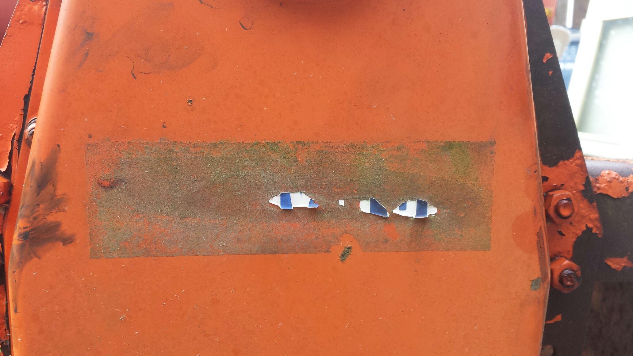

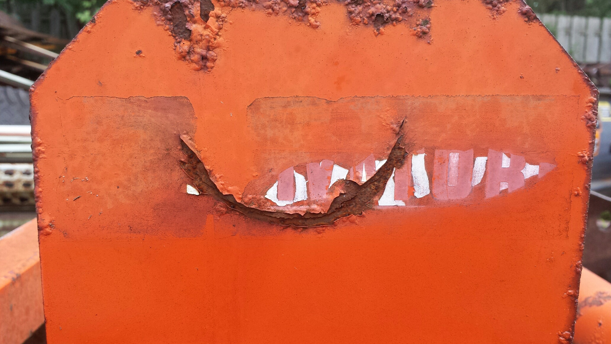

Besides the gearbox, noted above, there are no readable markings on the unit. Below are 2 pictures of what remained of 2 decals:
I'm hoping somebody recognizes the decal remnants if nothing else...

Think it's a Muratori? They are still in business, if it is.
/ 3 Point Rototiller ID Help #3
I think the decal says "rotovator". Think Howard brands their tillers like that. Rotovator is an alternate name for rototiller though I think so it might be more generic.

Why not take some pictures of the rest? I can see anything looking at a flat orange plate

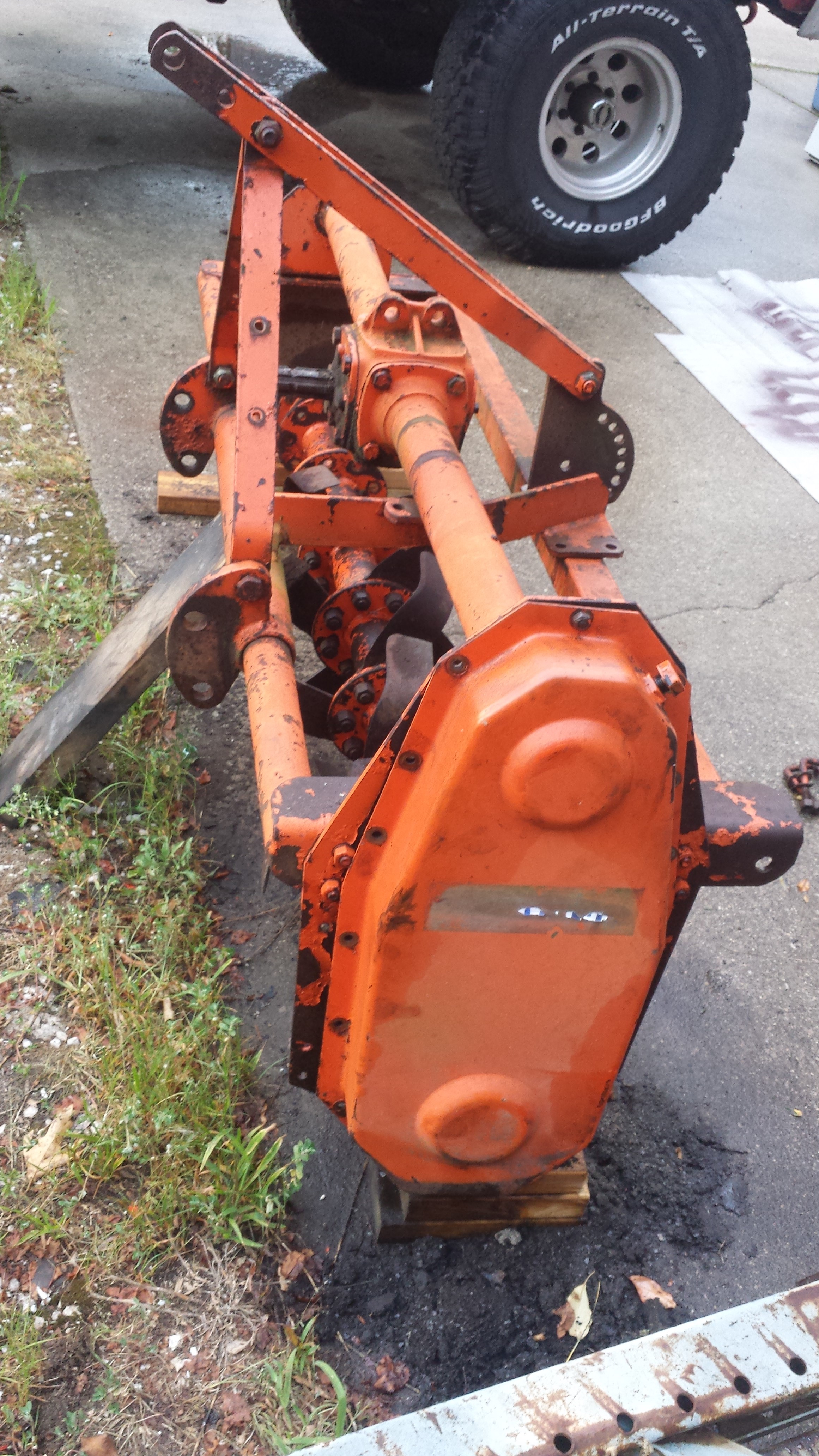

Well, mainly because it's partially disassembled at the moment. Here are a few others showing more:
I agree that the decal likely says VATOR, but it doesn't appear to be an O in front of the V.

I'm voting for Muratori, based on color and style of chaindrive cover. I had good success getting documentation for Muratori MA125, try contacting:
