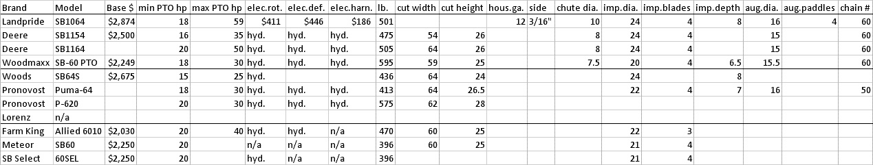

Looking to get a rear snowblower. Intend to buy with manual chute rotation and deflector, but aiming for a model for which I can buy bolt-on hydraulic or electric actuators down the road. What are the favored brands? What brands to avoid? Any particular features to seek out (impeller diameter, chain size, weight, etc.)?
My tractor (Deere 855) is 24 hp (19 PTO hp) with a 54" rear wheel width, so I'm looking around 60". Many of the blowers over 54" wide recommend more than 20 PTO HP to run them, which has me anticipating disappointment.
So far, I've checked out Land Pride, Deere Frontier, Woodmaxx, Woods, Pronovost (Puma), Lorenz, and Buhler (Farm King / Meteor). I've seen prices from under $2k to over $4k, weights from 400 - 650 lb., impeller diameters from 20" to 24", chute diameters from 7" to 10", and every other variation of impeller depth, auger diameter, etc.. It's enough to make one's head spin.

I owned a JD 750 with about the same PTO HP as yours with a 60" snowblower and never had any problems or disappointed with it over a 15 year span. It was an Inland SA-60" with a 20" impeller (20" is a best estimate guess) and was purchased used. Even during the years when the Nor'easters dropped 24" back to back it worked without issue. It had manual rotation and deflector. I never adjusted the deflector and it didn't take too much effort to reach back and rotate the chute. The distance it tossed snow was impressive.
Don't over think this... You can always adjust travel speed to compensate for lack of HP.

I run a 50" with 13 PTO HP. The key to making this arrangement work is the the hydrostatic tranny. You can adjust your speed to a rate that the blower can handle.
Careful on the weight. My Buhler is close to my max TPH lift. Once a year it gets loaded up with wet snow to a point that seems to weight about one pound more than my max lift. :)

On my 25 hp Kubota I am running a 60" dual stage snowblower that I picked up used for 200 dollars and it handles it fine. My tractor is just gear shift with 2 reverse speeds and no live pto but it handles the snow fine. I have never had the tractor bog down once from putting too much snow through it. I would not hesitate one bit going with a 60" if I were you. If the snow is real heavy make your first pass in low gear and then just make 3/4 or 1/2 width passes thereafter.
I would think an actuator could easily be added to just about any chute on a snowblower with a little ingenuity especially an electric one.

I don't know if your tractor is hydrostatic or gear. Hydro allows an infinite speed selection to make it quite effective to match ground speed to pto load. I doubt you would be under powered with hydro or gear.
As to changing manual chute to powered, the chute rotation is more important than the cover plate on top of the chute. Rotation is fairly easy to add and can be done in a number of ways. There are a number of threads about it. I used a power window motor for mine.

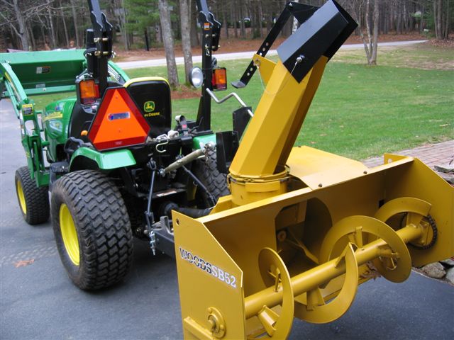

Not bad ideas, bandit... but it's already home in the garage, as of last night! Your mention of beige got me looking at some photos, as I only ever knew Woods as orange, and Landpride as the ones making beige implements.

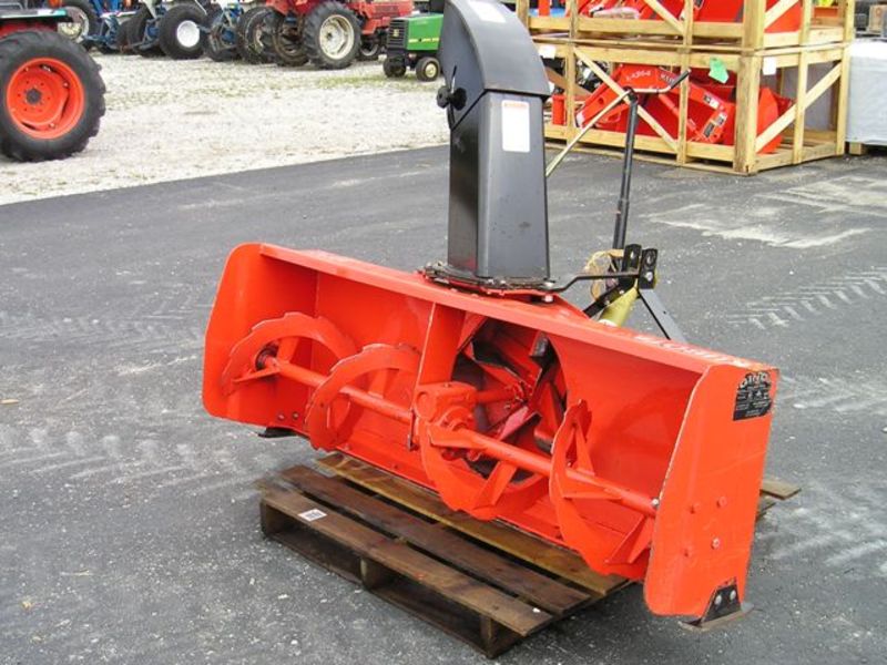

Here's what all the Woods stuff I see today looks like:
However, I find photos on the internet that are more yellow:
Kubota:
I'll have to take a closer look at mine when I get home tonight, but I think it's the more Orange of the two Woods colors shown above.
