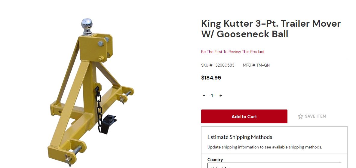

I REALLY like my King Kutter trailer mover. I would challenge anyone to find one heavier built. They make 2 models; this is the heavier one. It has clevis style hook-up (stronger) for the lower arms and comes with a chain and adjustable connector to attach to your drawbar to prevent upward movement. It also has a spot for trailer breakaway chains to connect to. I have a ball mount with a hook welded on it that I use on this trailer mover and I have pulled trees and everything using it. Highly recommend.
I might go this route. Rural King sells these with their name on it and I have a Rural King not far away.
The clevis-stype hook-up is I think to make it quick-hitch compatible? I'm actually not a fan of that since I don't have a quick-hitch; I've found on heavier implements it makes attaching more difficult. But on this, not a big deal since there's no weight to it and the whole thing can just be picked up.
Thanks for the review. :)

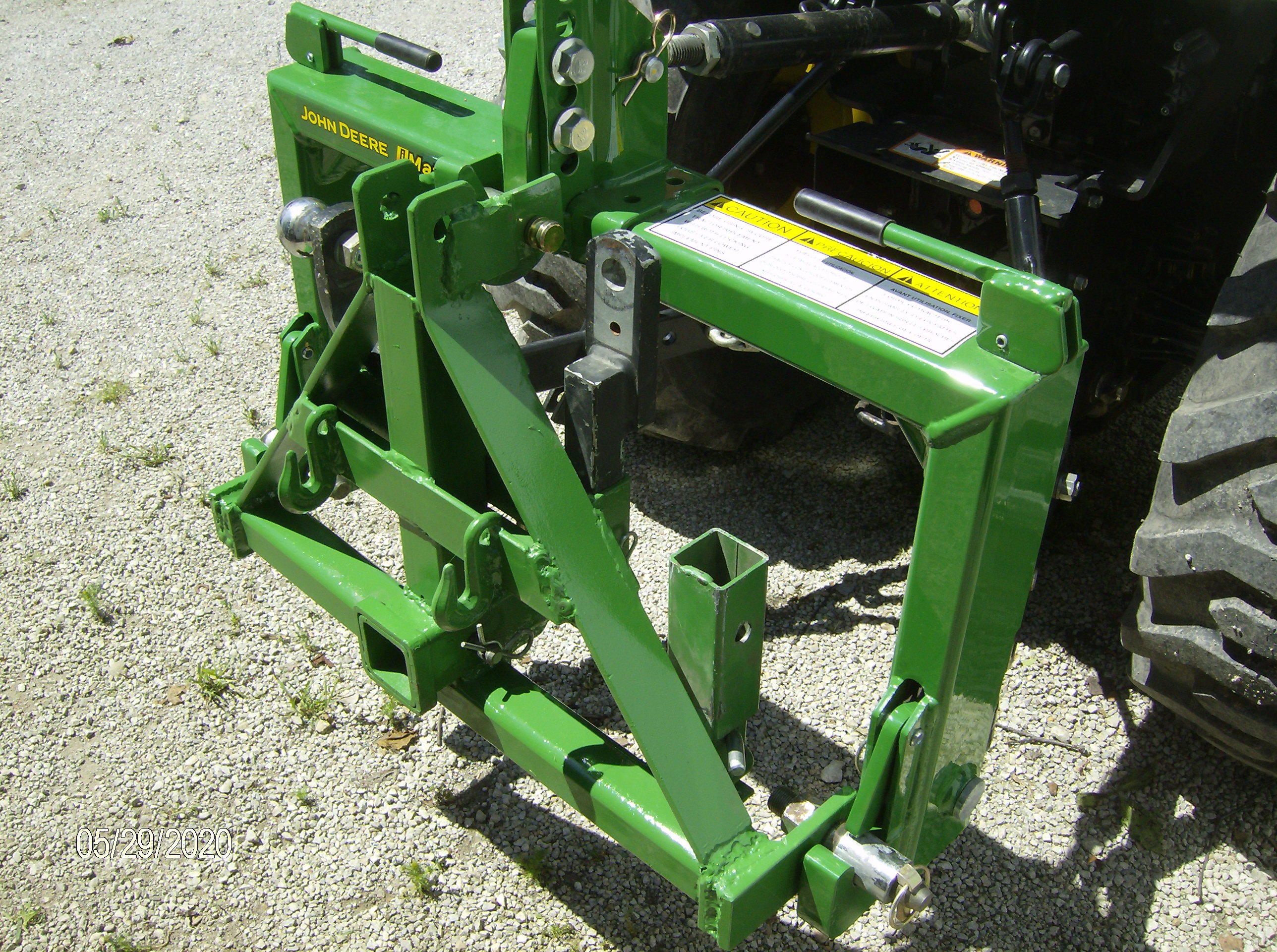

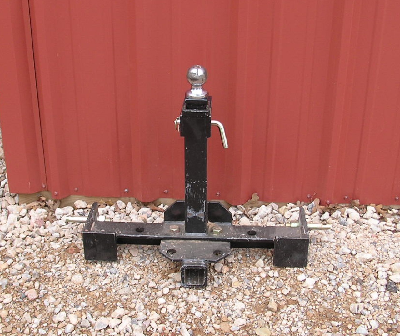

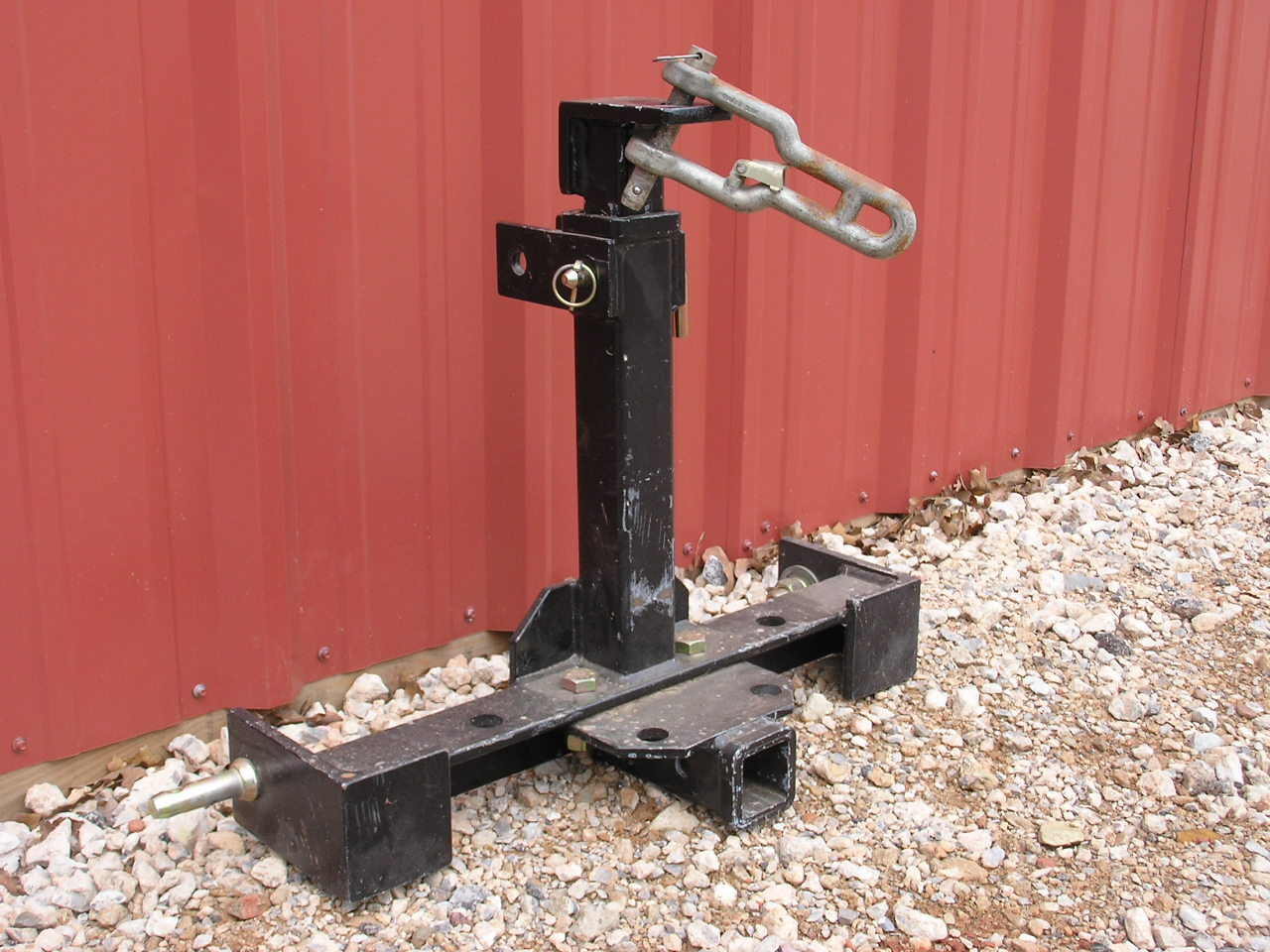

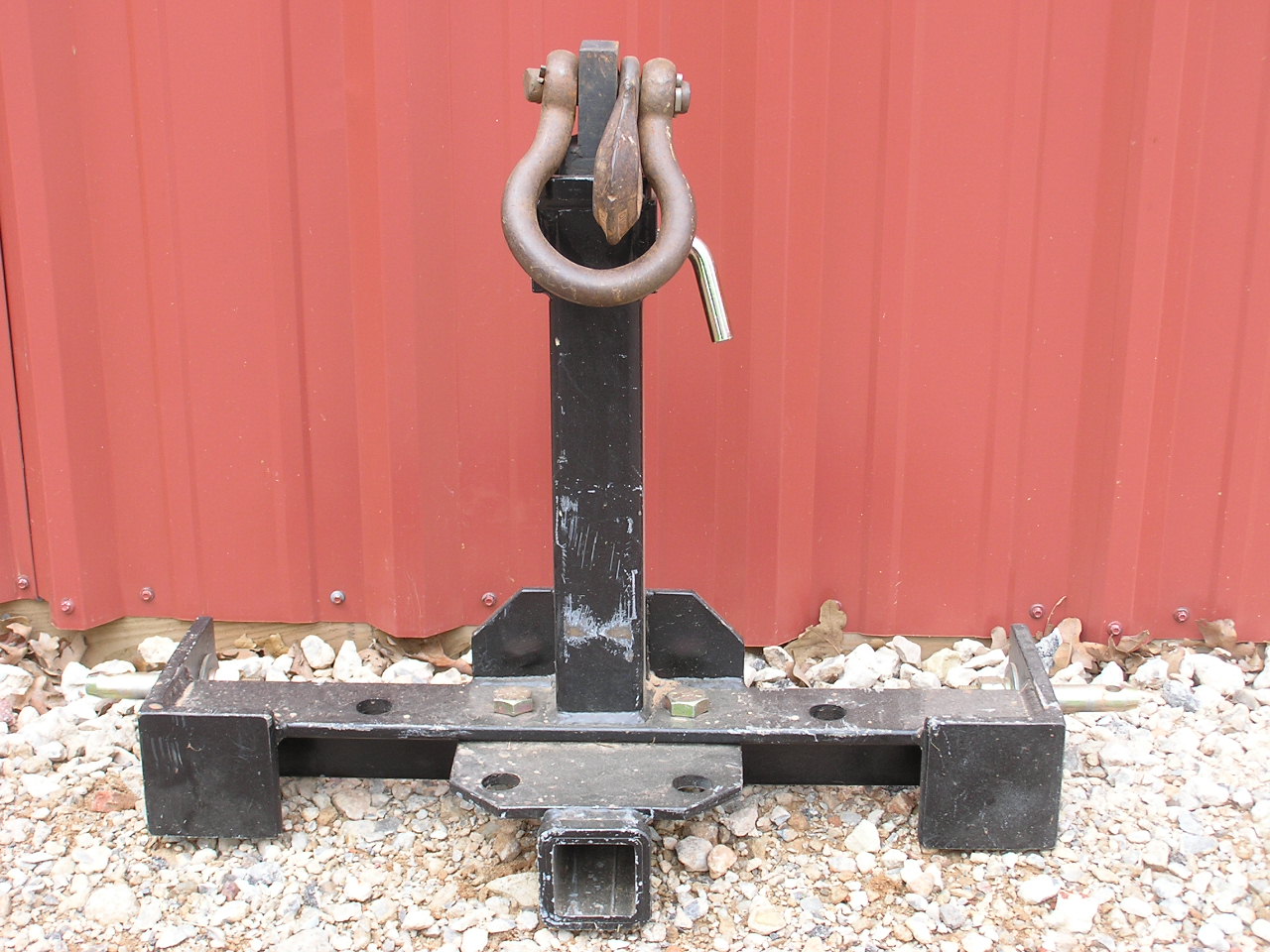

I built my own multi-use hitch, had to remodel it a bit to fit the quick hitch: HPIM2960.JPG HPIM2961.JPG

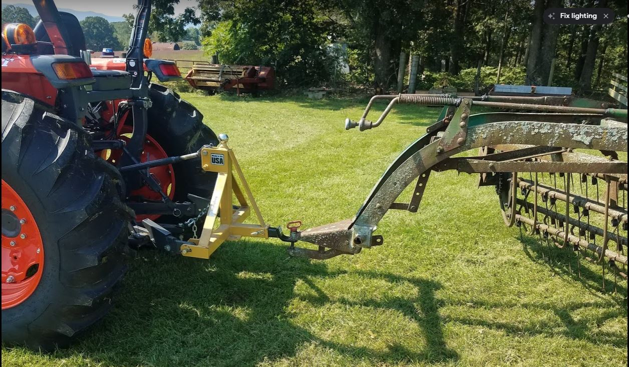

Just realized that I didn't show any pictures of it moving a trailer:

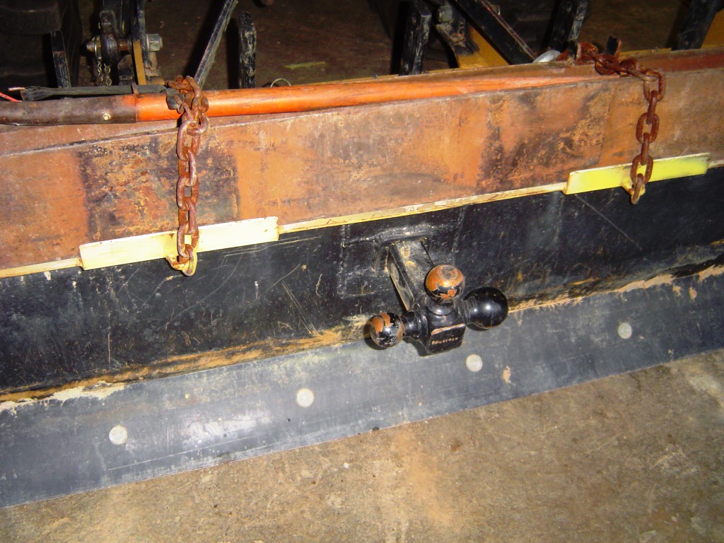

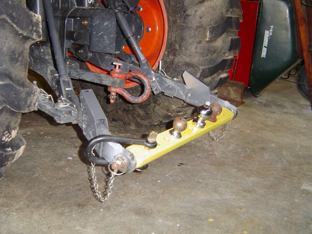

Here's what I use. The shackle keeps the drawbar from turning. I also welded a receiver into my box blade for moving trailers around.

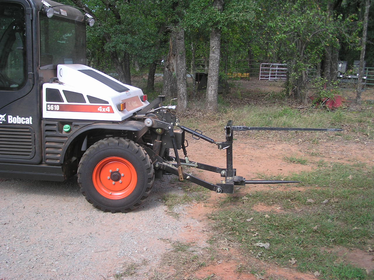

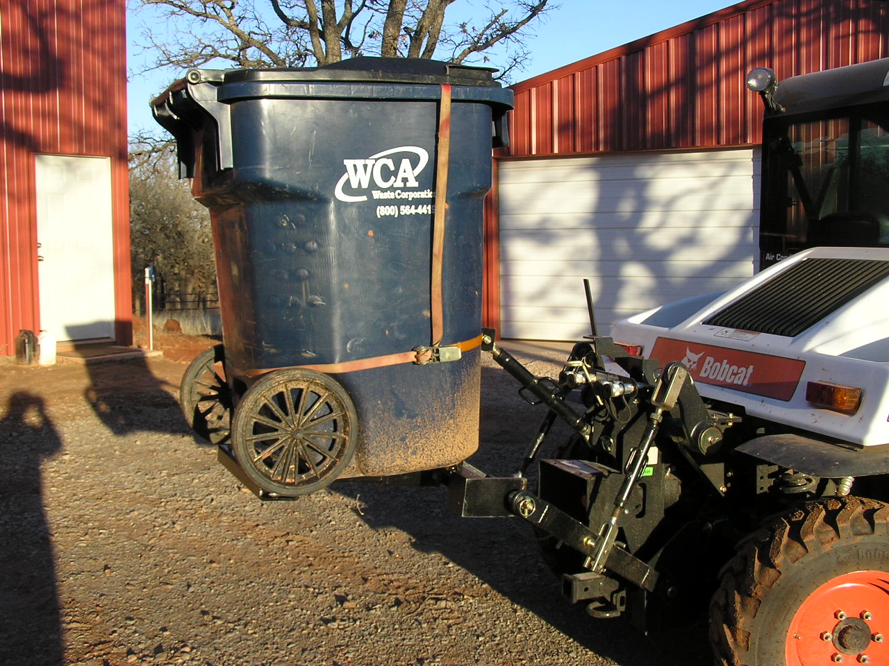

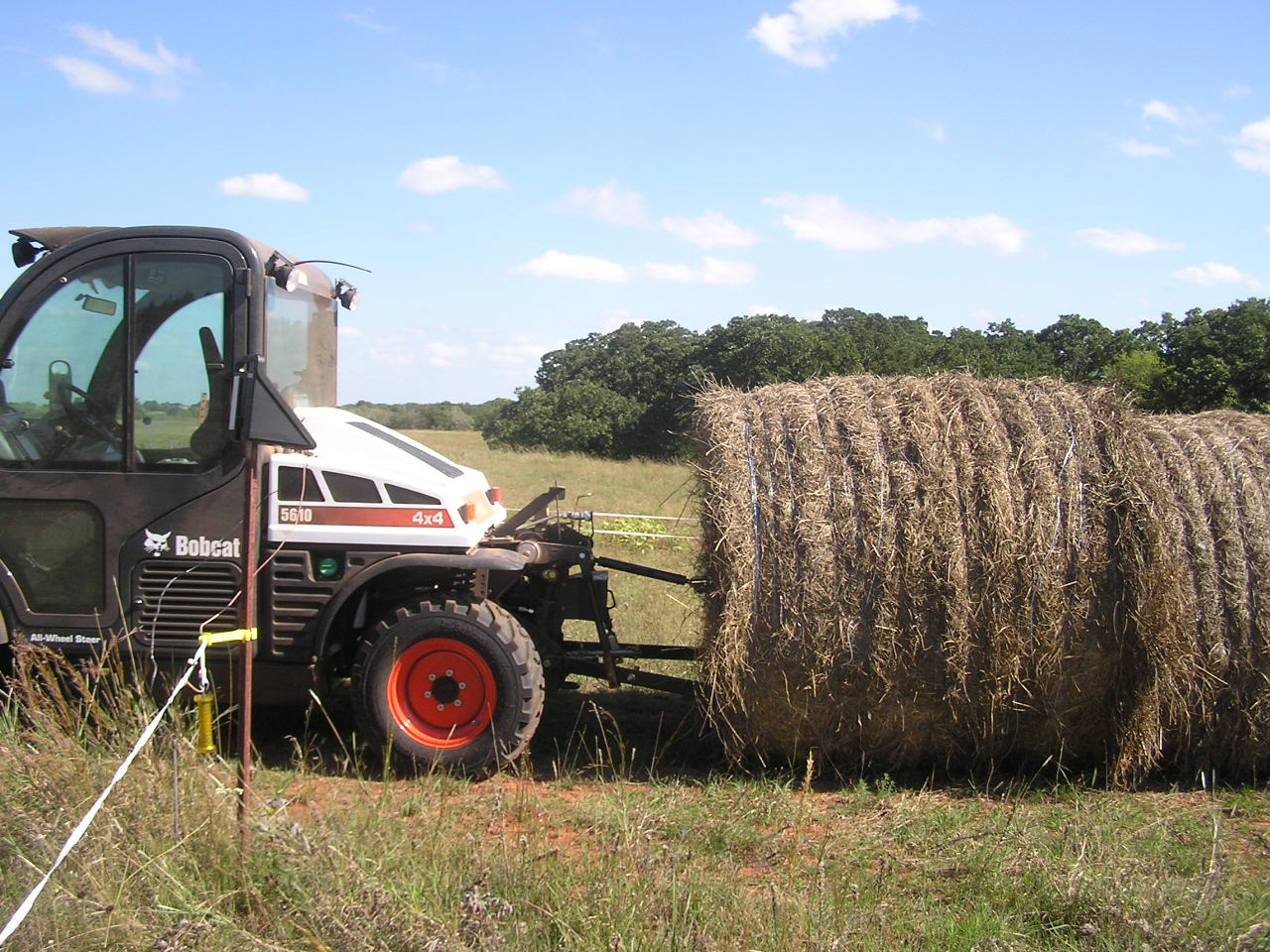

Yep. The Omni Hitch has a few clever design elements that make it more of a multi tool

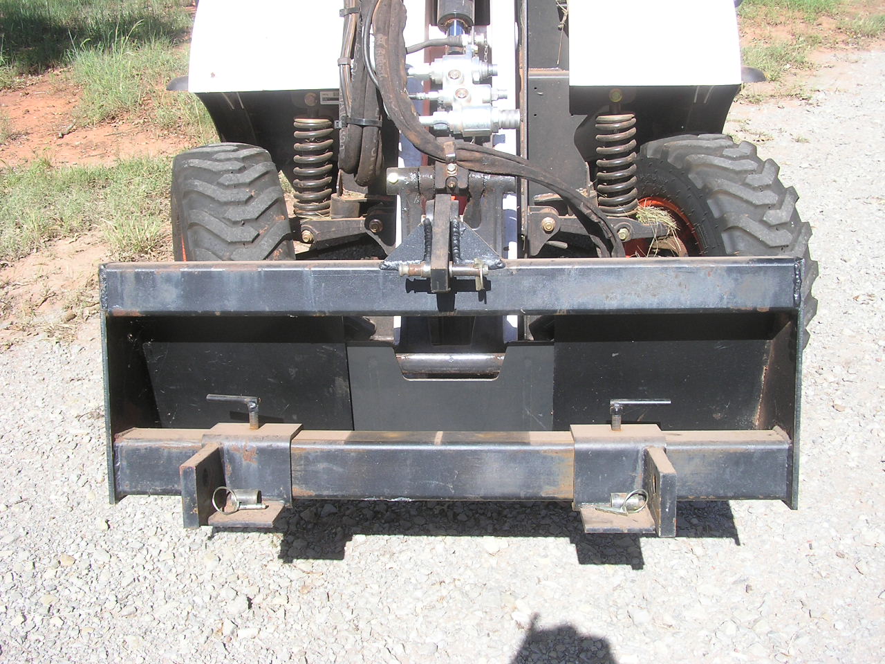

I use it a lot on the front with a SSQA to 3 point adapter:

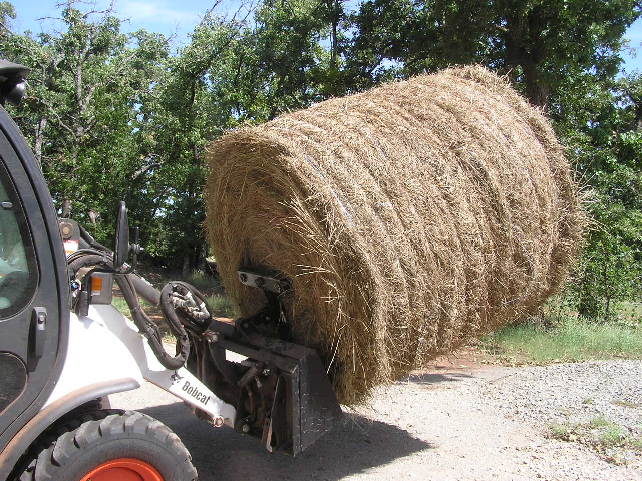

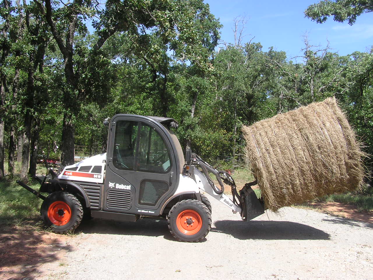

The bale spear in the Omni Transformer Hitch:

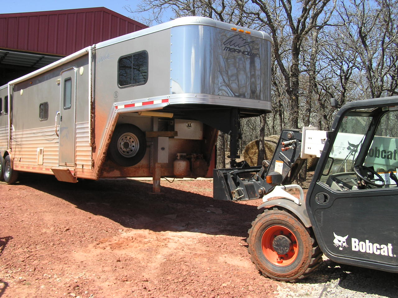

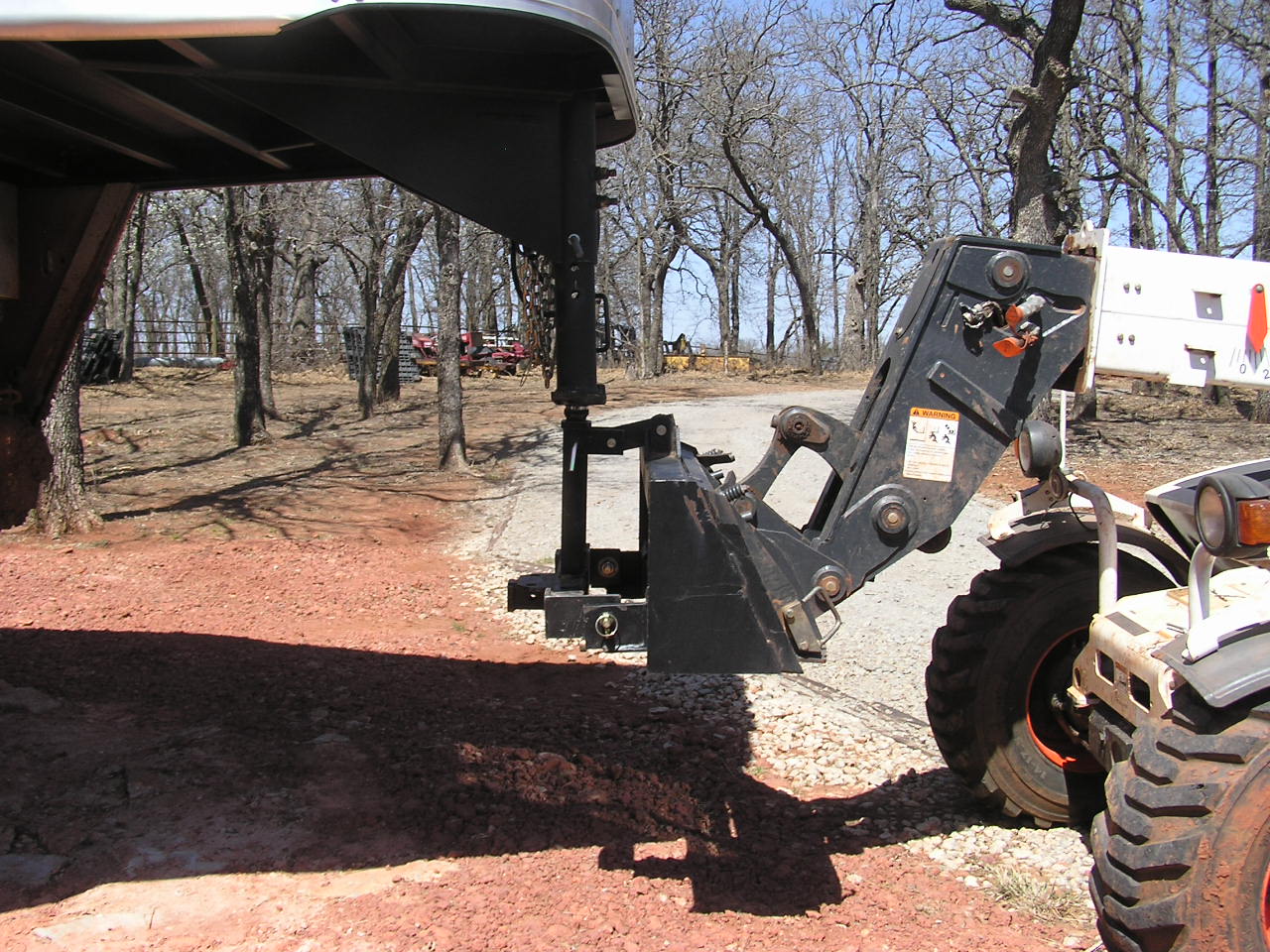

On the V417, this trailer weighs over 10,000 pounds, with just over 3,500 pounds on the hitch:

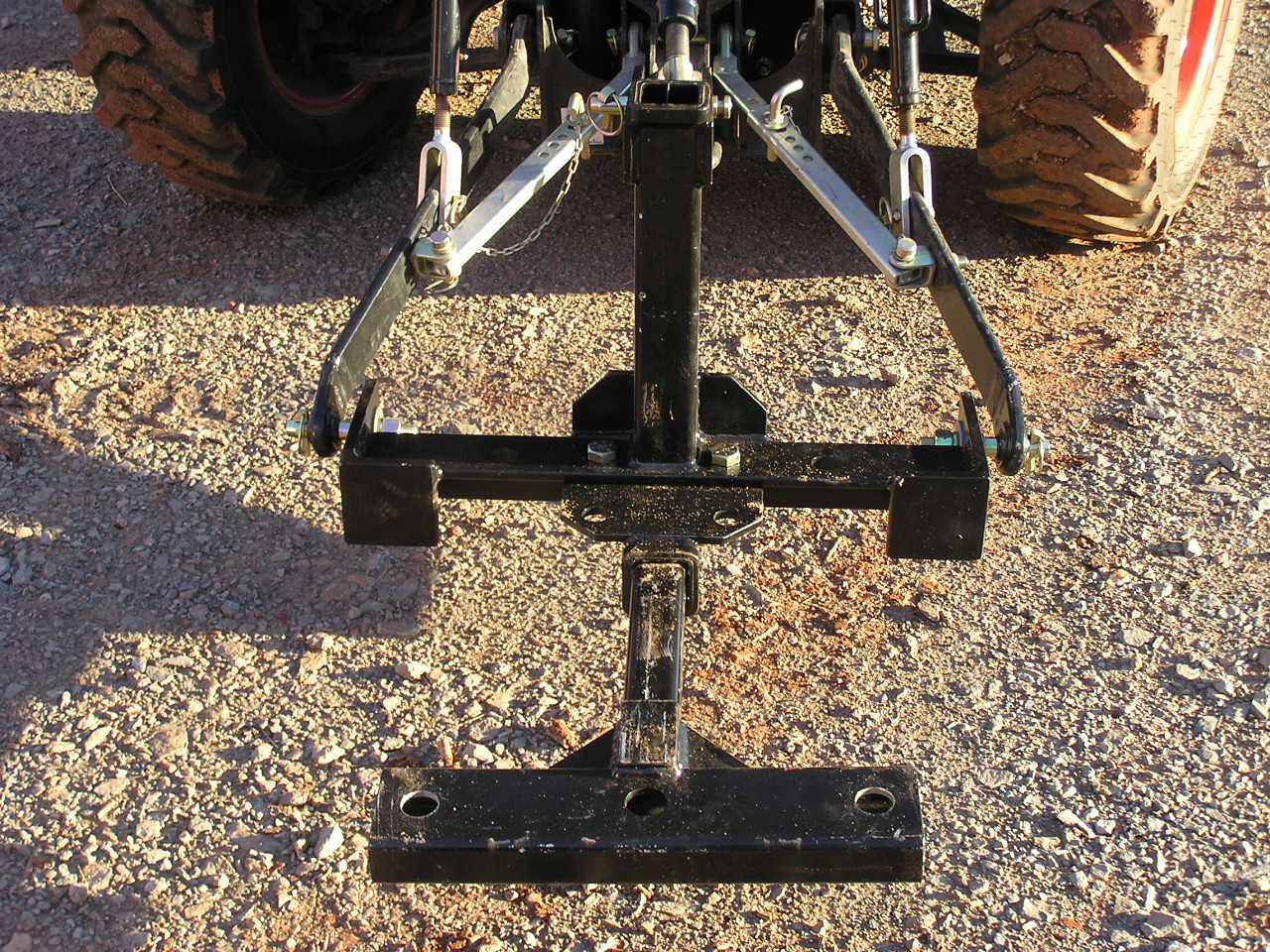

I thought the trailer movers were over priced so I built this one for less than $50 and a couple of hours of work.

Thatç—´ a pretty good trick. Lifting 3500 lbs with a 1500 lb rated loader.
No trick, different machine.
The Toolcat will lift just over 3000 pounds according to my crane scale.
Bobcat's skid steer ROC is half the tipping weight. The Toolcat maxes out before the rear axle comes off the ground.
The V417 is rated at 4400 pounds. I have lifted over 6000 pounds with it blue TU.gif
