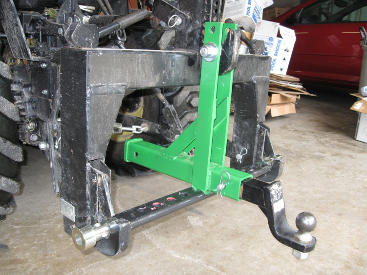

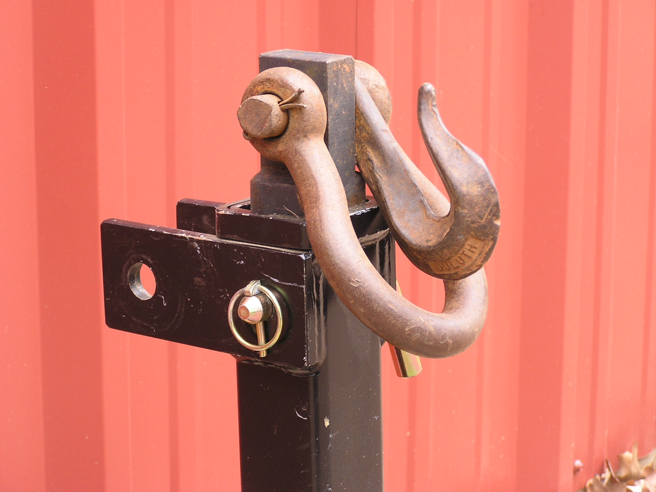

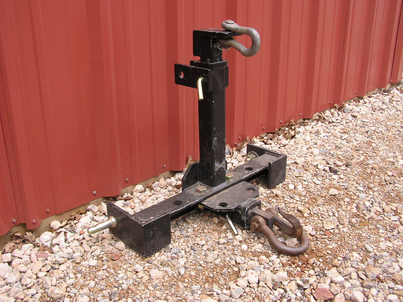

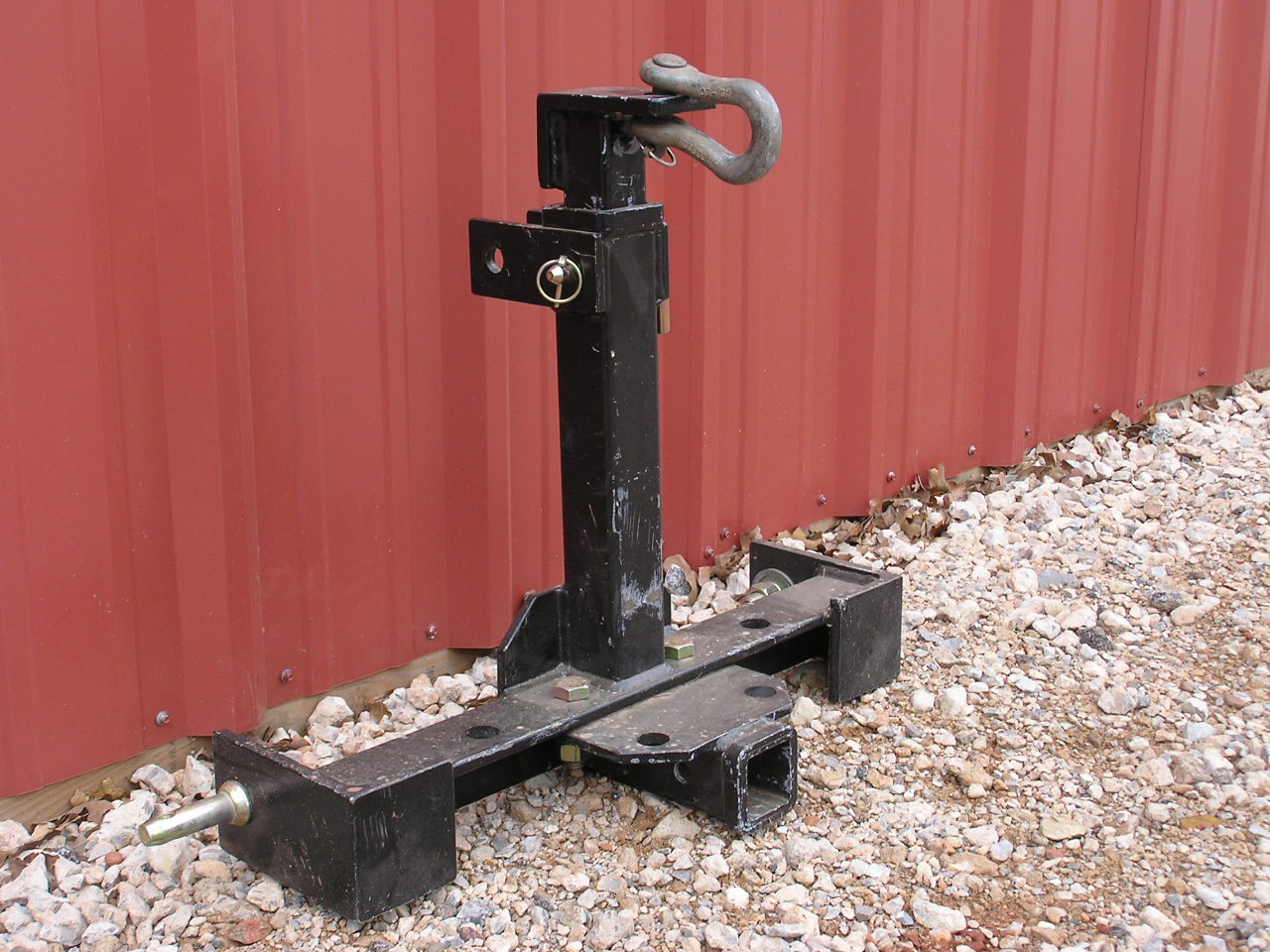

I built my own multi-use hitch, had to remodel it a bit to fit the quick hitch: HPIM2960.JPG HPIM2961.JPG

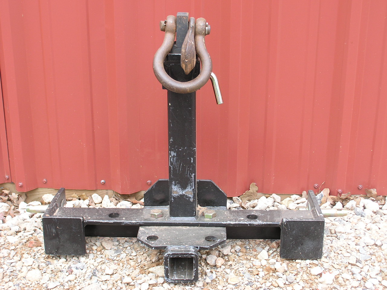

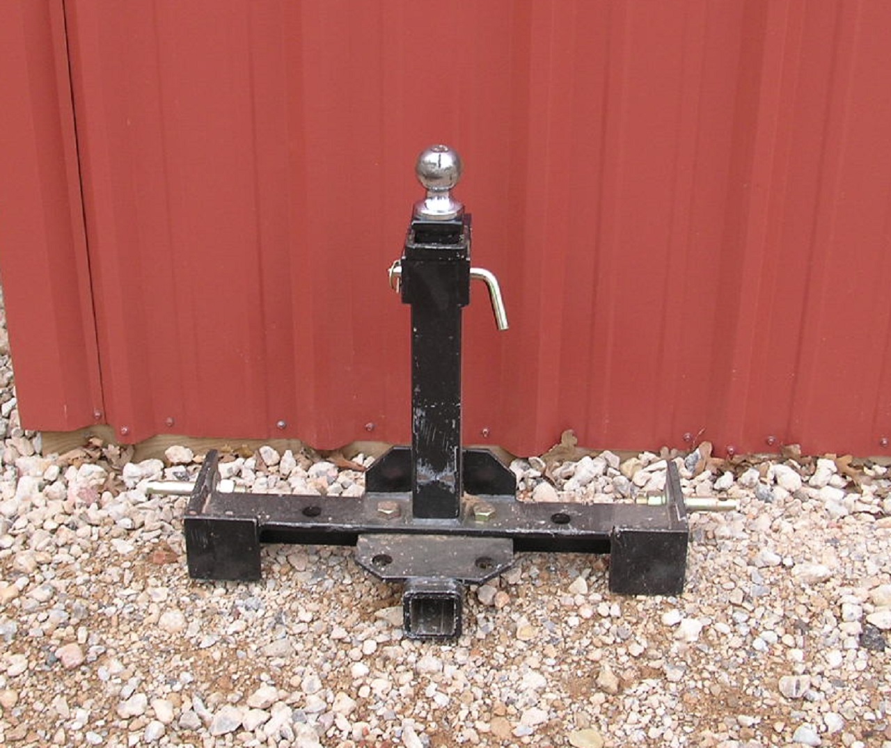

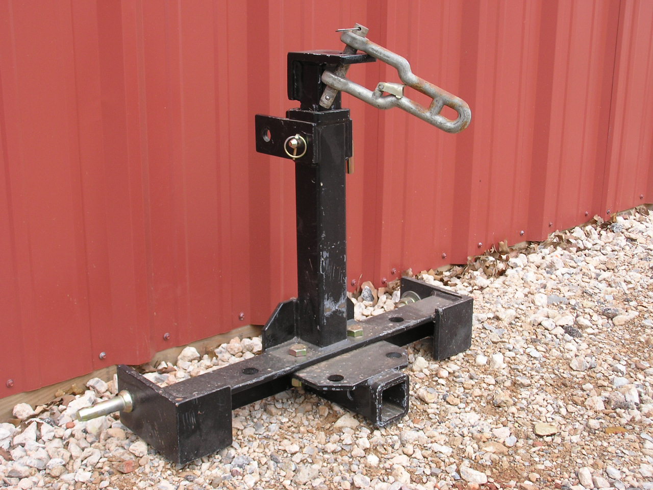

Here's what I use. The shackle keeps the drawbar from turning. I also welded a receiver into my box blade for moving trailers around.

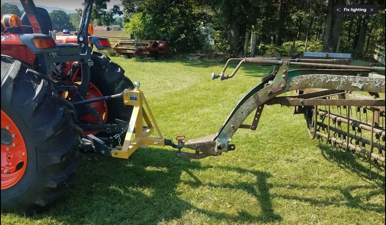

I use it a lot on the front with a SSQA to 3 point adapter:

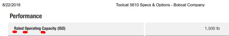

Thatç—´ a pretty good trick. Lifting 3500 lbs with a 1500 lb rated loader.
No trick, different machine.
The Toolcat will lift just over 3000 pounds according to my crane scale.
Bobcat's skid steer ROC is half the tipping weight. The Toolcat maxes out before the rear axle comes off the ground.
The V417 is rated at 4400 pounds. I have lifted over 6000 pounds with it blue TU.gif
