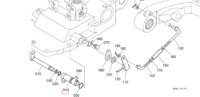

I having a problem with my 3 point hydraulics. It is an intermittent problem. What ever implement I have hooked on to my M7060 Kubota sometimes when I raise it all the way or part of the way the hydraulic s jerk for a second . Does not raise up or lower the implement . Sometimes it is in quick successions and sometimes slow successions. As if I tried raising the implement and then quickly returned it back to its original height. Sometimes I either lower or raise the adjustment lever just a hair and it quits doing the hiccup thing. It's been doing it for about a year. The tractor is just 3 years old. I change filters and all oils as per Kubota maintenance schedules. Still under warranty but I'm hoping to hear from someone who has experienced the same and what remedied the problem.

Have you lubricated feed back rod pivot points? Have you attempted to relocate position of draft control lever?

Feed back rod pivot points ??? No sir which one is that ? And no have not repositioned draft control. I will try that tomorrow. Thank you Tx Jim.
/ 3 point hiccups wth ? #4
Feedback linkage shown below.

Hello Txjim, well I relocated the draft lever in several positions but I would still get the occasional hiccups. Now if you don't mind how do I open the thumbnail pictures ? I keep clicking on the icon but nothing happens.
