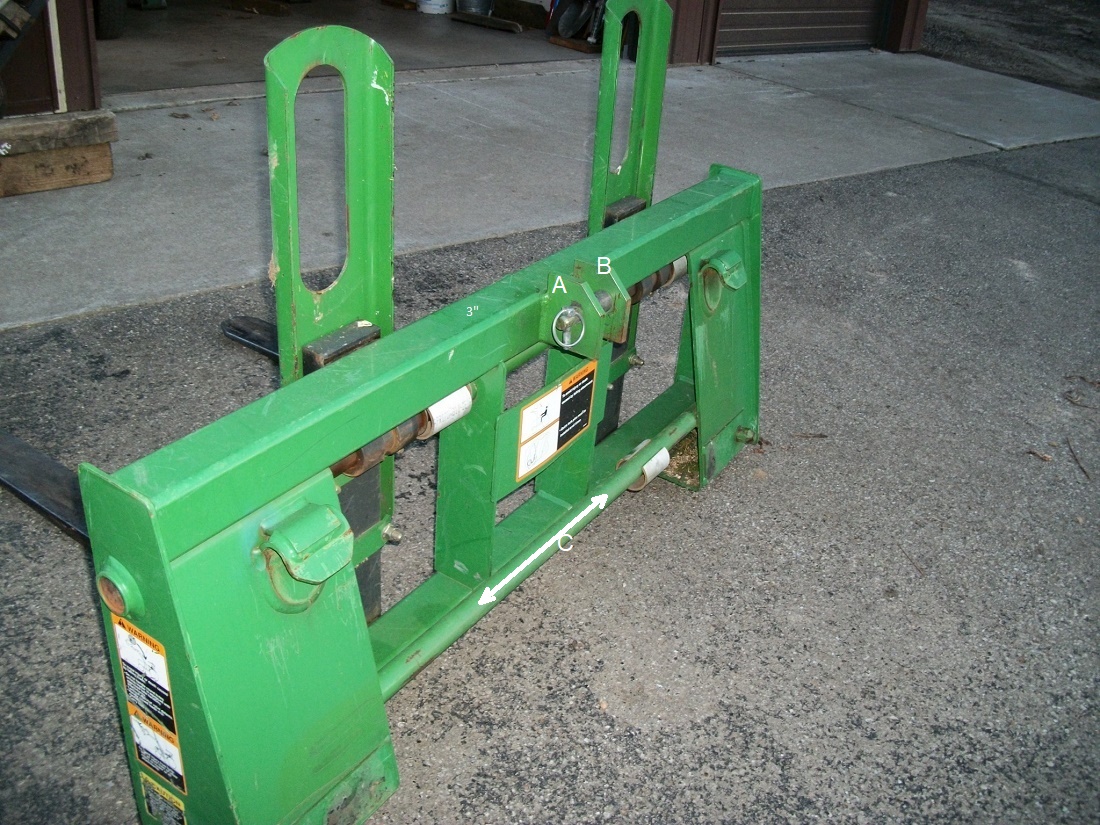

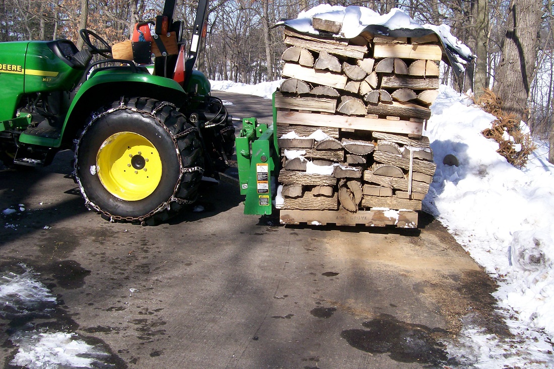

I have the Deere forks that are adjustable, and adjust them fairly often. Wide if carrying logs.. in between to match with pallet differences, and close together if digging out rocks or roots. Many different uses for forks. I made my FEL forks to fit my JD iMatch quick hitch and added the hyd. top link. I move pallets of firewood in the winter with the 3 pt forks when my Western blade is on the front of the Deere (FEL off).
The JD forks were modified for the 3pt iMatch hitch with the addition of two top plates (A and B) for the top hook and a solid bar (C) across the bottom for the lower hooks to catch. I've picked up and moved double pallets of firewood (figure 40% of a full cord around 1800 lbs). The hyd top arm is essential for this to work well, and work well it does.
