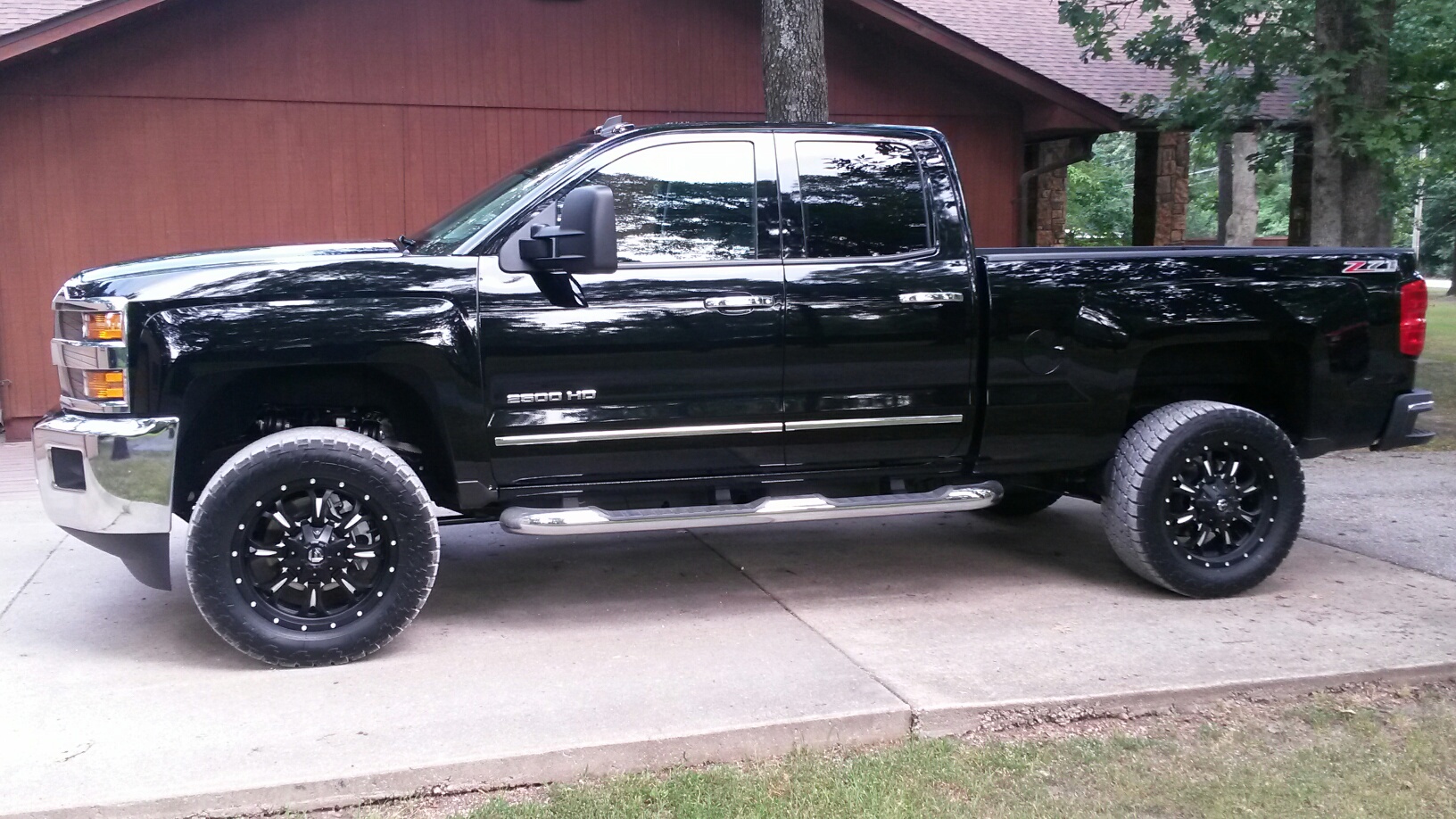

fordmantpw - that's an interesting link. I'd be curious to know how many miles were on those trucks when tested. I've been able to get into the 14's on my 2500 HD but it ain't easy. Those guys made it sound like they just hit the A/C and went for a joyride. I also didn't see what type of fuel they ran, "real" or "corn?"

KiotiKowboy, don't you have larger tires on your truck? That makes a big difference.

Yes ... but .... in reality, they're not THAT much larger. I swapped out the factory tires/wheels and went with 19" Fuel Krank wheels and 33" all-terrain tires. The original tires were 31.9"

Well, that is 3.4% difference in circumference, so you are actually getting 3.4% better fuel economy than what you think (unless you had the speedo calibrated) since you are traveling 3.4% further than your odometer reads. At 14 MPG, that's a .5 MPG difference. A tremendous amount! :laughing:
That doesn't take into account the extra energy it takes to turn the larger, heavier, wheels and tires. That's probably good for another .5 MPG or so.
That sure is a sharp truck! :thumbsup:

I considered having the speedometer recalculated - more about not getting a nice ticket than anything else. Turns out, at least according to the dealer, the recalc is a programming change that has to be backed out for many warranty repair issues. I decided if I keep my speed below 80 on the gauge, it should be safe enough to avoid a hassle. At lesser speeds, the difference in MPH is not significant enough to care.
And - thanks :)

In reality, most speedos display 2-3 MPG fast from the factory anyway (although the odometer is spot on), so your speedo is probably about spot-on. Check it with a GPS and I'd bet it's within 1 MPH at 70. Your odo will still be 3.4% slow though, so when you sell your truck with 100k miles, it will actually have 103k. :)
