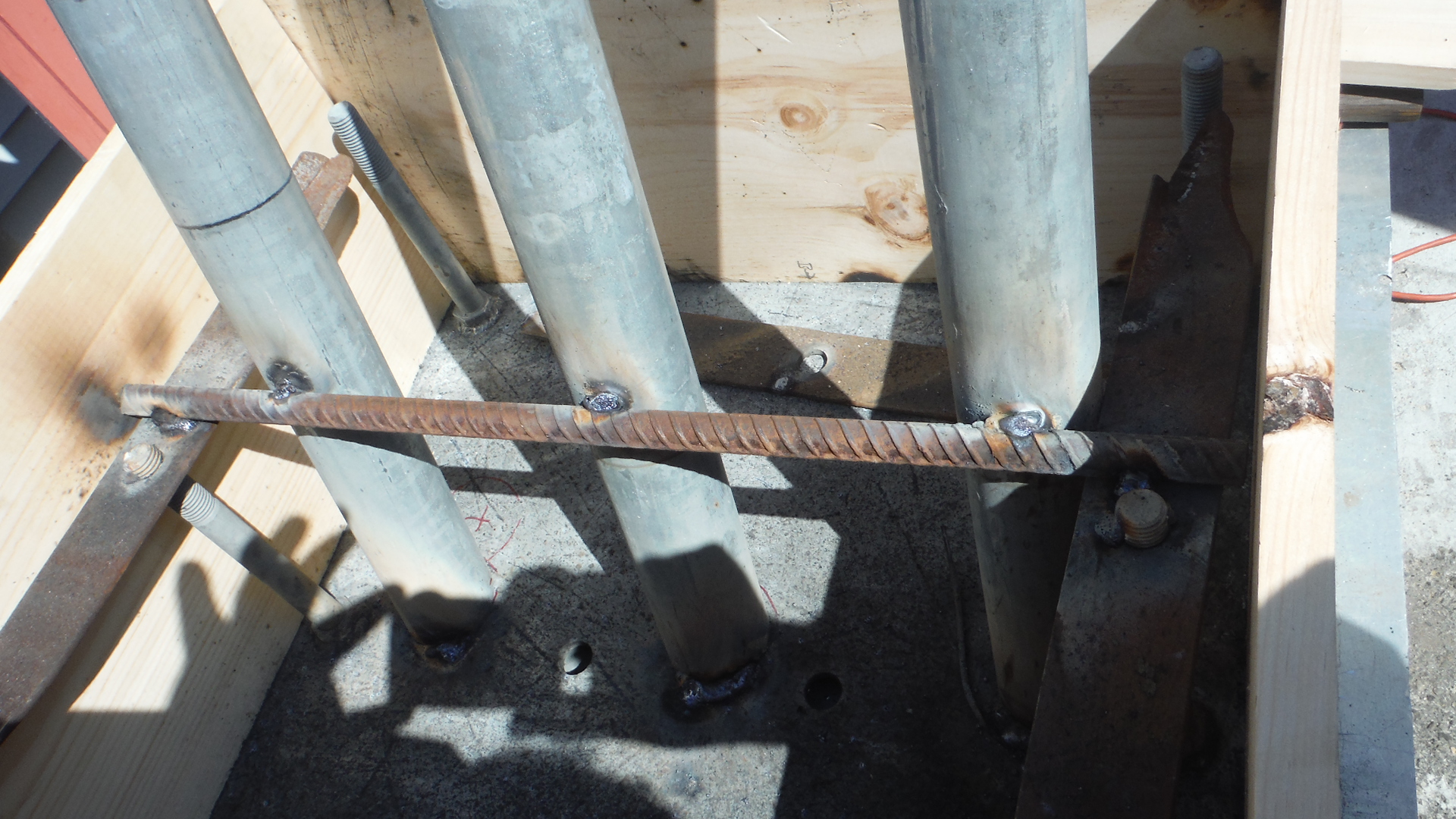

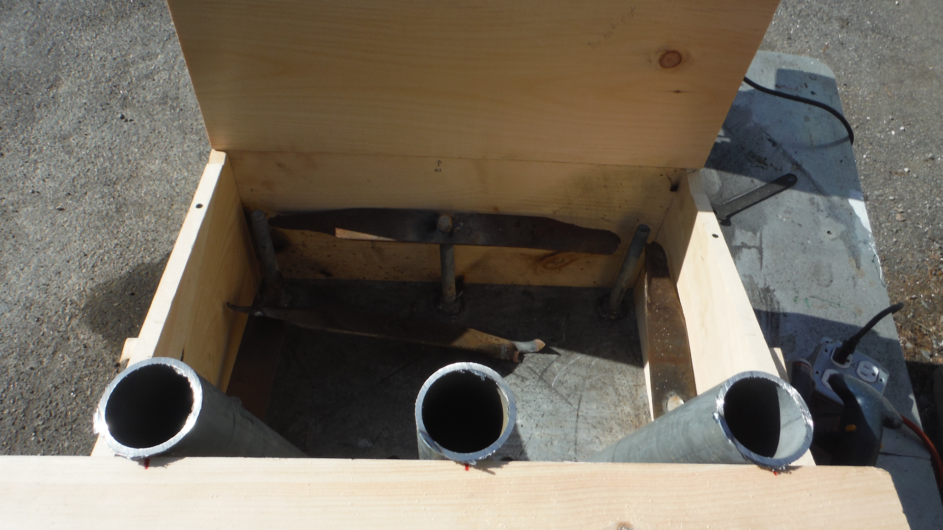

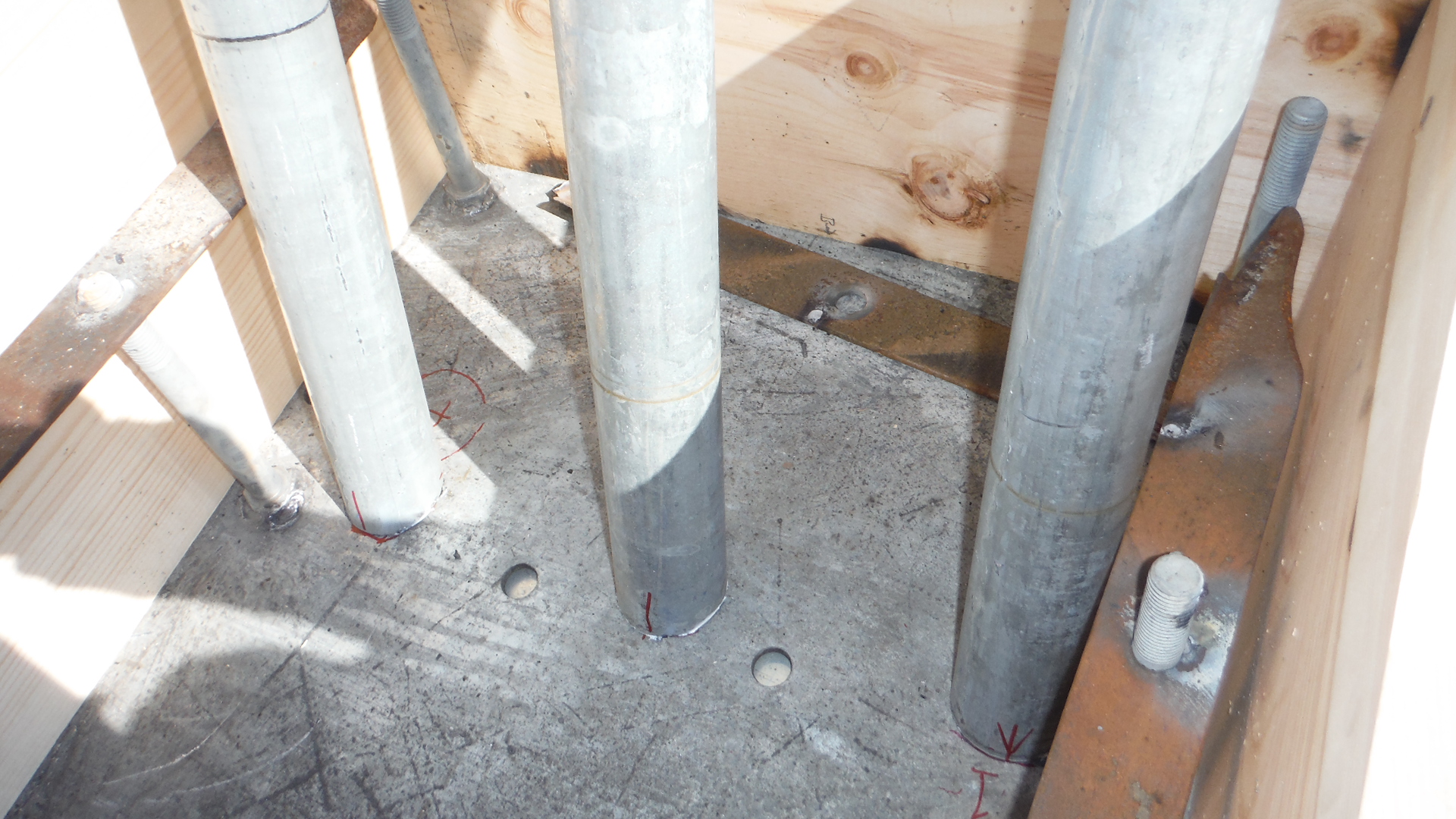

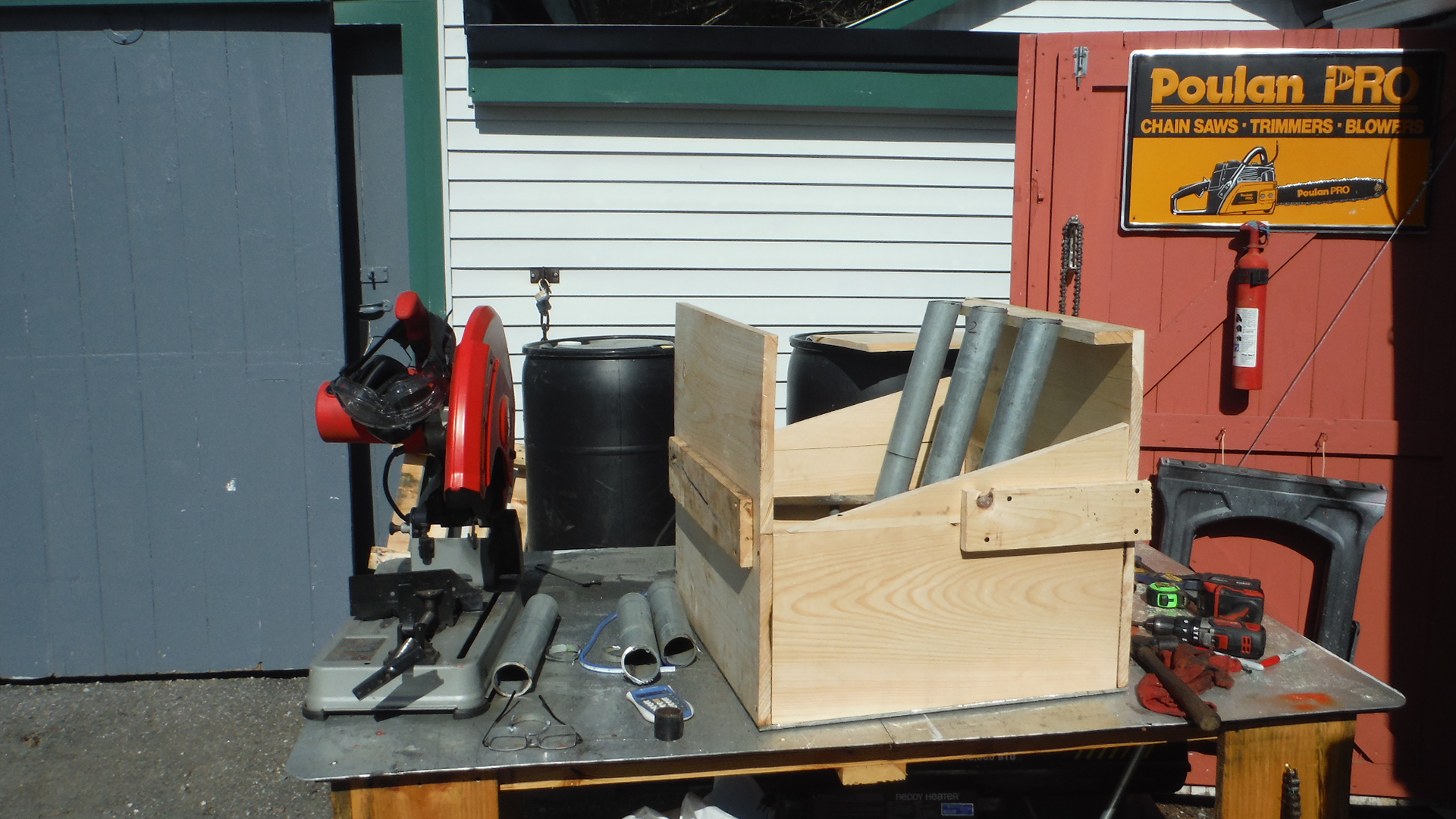

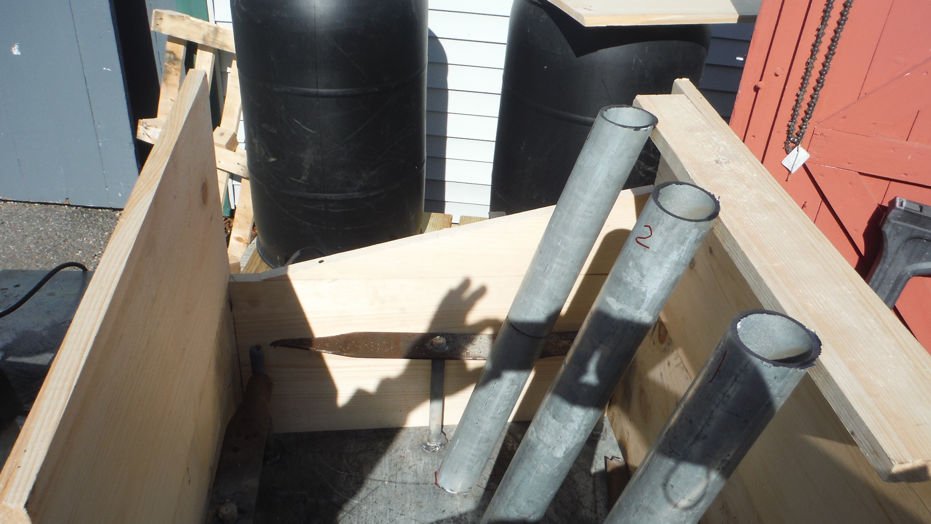

It is 8 cubic feet 2'x2'x2' within an 1/8 " I am very sure of my measurements ha ha. Like I said earlier it is the weight of the mix + water + the steel involved . The steel is a guess but a very good one I think. The steel plate in the bottom of the unit with 1/8 " holes drilled every 4" around it's perimeter to attach the 1 x 12 boards to this plate alone probably weighs 35-40 pounds.
Then I have a category 1 draw bar in-letted into the wooden box for the lower lift arms to attach to. Then the upright steel for the top link is 2" channel iron 18" tall with steel plate connecting the 2 channel iron sections, two of these back to back with room in between for the top link to fit. This gadget alone probably weighs 20 pounds not counting the Draw bar . And maybe a pound of 7018 rod for good measure ha ha. The metal inside the box is 1/4" galvanized 1" 1/2" steel pipe cut to maybe 30" long each there are 3 of these. Plus misc 1/2 re-bar and other scrap steel for reinforcement .
Oh yes she will be stout!

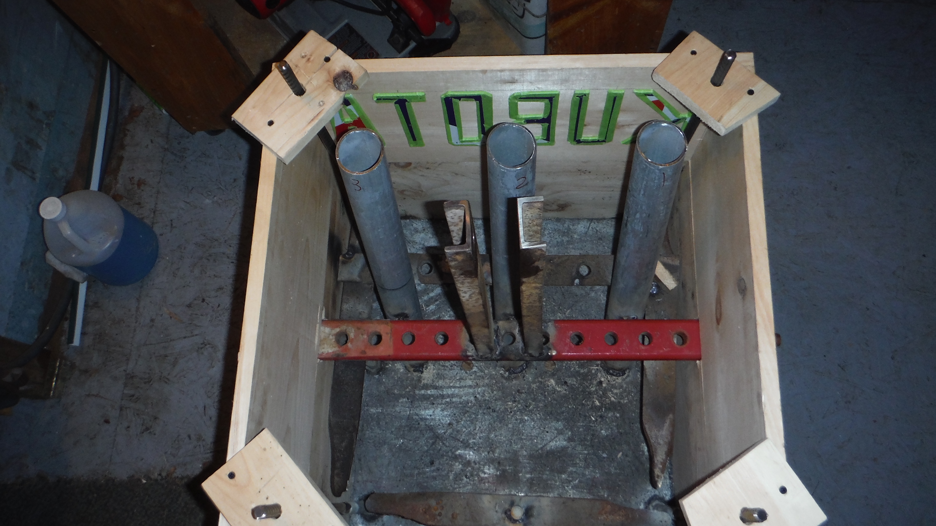

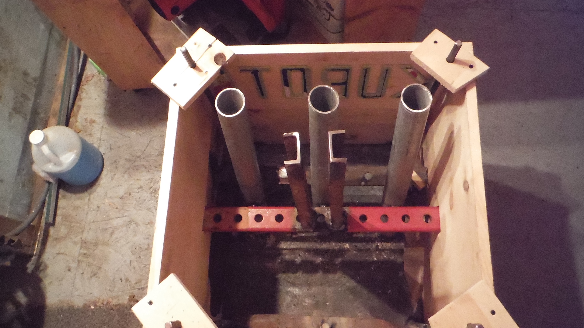

I am going to try to up load some pictures of the box
DSCF0488.JPGDSCF0492.JPGDSCF0497.JPGDSCF0498.JPG[[/ATTACH]DSCF0500.JPGDSCF0501.JPG[[/ATTACH].DSCF0486.JPG
/ 2x2x2 concrete weight box
#28
Here are a few more now I just have to buy some Concrete mix !
I have no idea on how to make these easier to view? I was hoping you could just click on the first picture the scroll down through looking at the rest of them. As it is now I guess? you have to view one then go back click the next view that then go back,,,,,,
Sorry but I don't know how to make this work more smoothly for you all. If you do know how to make it work better please fix it up if you want to. I hope this will be of use to someone who want's to build a box themselves. Jeff

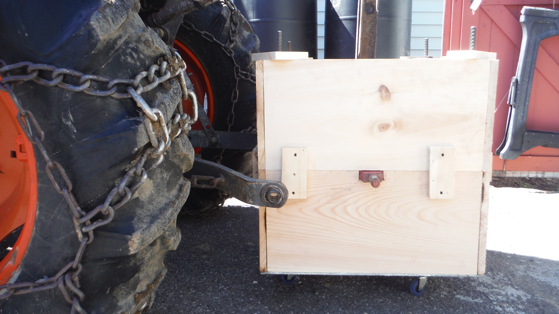

Looking at the picture on the right in your post.
I have a concern from looking at the top view picture. It seems the red drawbar is too far from the front of the box for it to work. Are you sure the edge of the box won't hit the 3 point links? The 3 pt links come from a narrow part of the read of the tractor and spread out to the lifting pins on the drawbar. The corner may hit the 3pt links.
The reason I ask is I did that and had to grind and chisel some out of the front corner of the box.

Ya that may be an issue I will have to make a dry run at it for sure good catch! It is 38* and rain today but if it ever warms up I will take the Farmi Winch off and try the box. It makes me glad I decided to post a photo of it. Otherwise I would not have thought about that. I just copied the width & height of the Farmi connections. Now I am itching to see what I will have to change to make it right.

Up-date
You both were right the thing was about 10" from hooking up. Not even close. I just went out and tried it I took a photo of it the way I had it set up you can see it would never have hooked up. Then I moved the draw bar forward to a point that it would hook up easily and positioned the bar there in the box. I thought I took pictures after the draw bar move but I guess I did not. After I get it finished up I will then and post it.DSCF0511.JPG
/ 2x2x2 concrete weight box #34
What are the weight ratings for those casters? I made a little cart for mine with four 300# approx ratings and my 7-800# box is a bear to push around. Unless it is on smooth concrete, forget it. But even if it can move a smidgen it might help hooking it up.
#35
The casters,... well those my friend are harbor freight specials ha ha. The box with the steel weighs enough that I don't want to horse it around by man power alone , so I have it sitting on a small platform with four small casters just for moving it around. I will be just dropping it on the ground someplace when not in use I will not have a smooth enough place to use castors. If I had a concrete floor in a shop maybe I could then but I have no such luxury.
