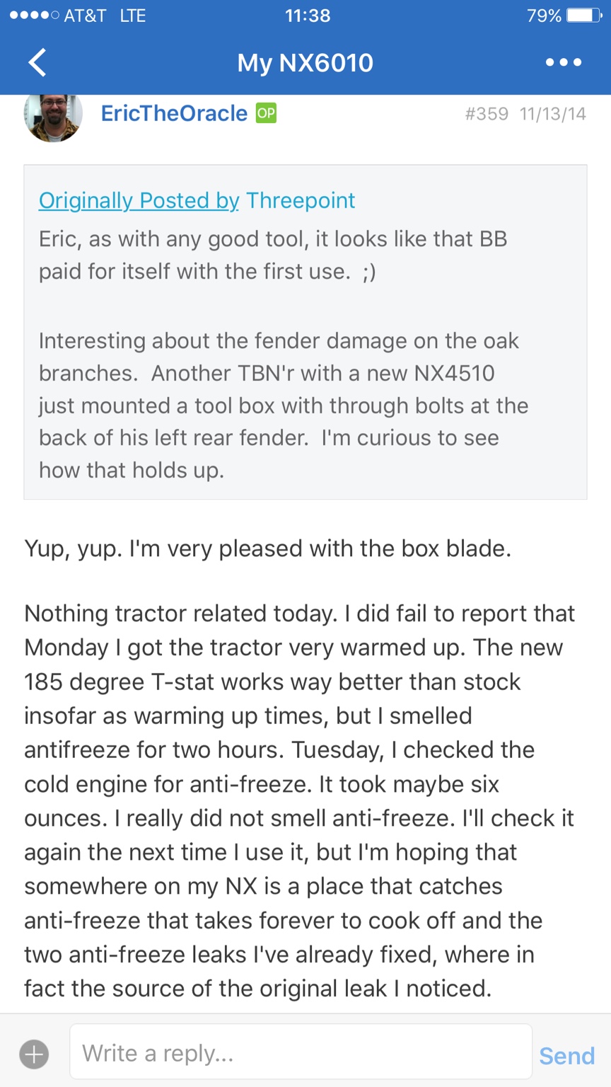

Did it extend his regen times, or the time between his regens? I haven't seen his videos about low or no cab heat, just his slipping out of gear ones.
I too worry that the reason the temp is set so low is an emissions related reason. However, we don't know since Mahindra corporate isn't the best communicator.
Sorry about that. It extended his time between regens. I think it was early on in his post about his tractor. I can't find in his thread where he talks about the regens , it's 65 pages long. But here is his comment on putting in a 185 deg F thermostat

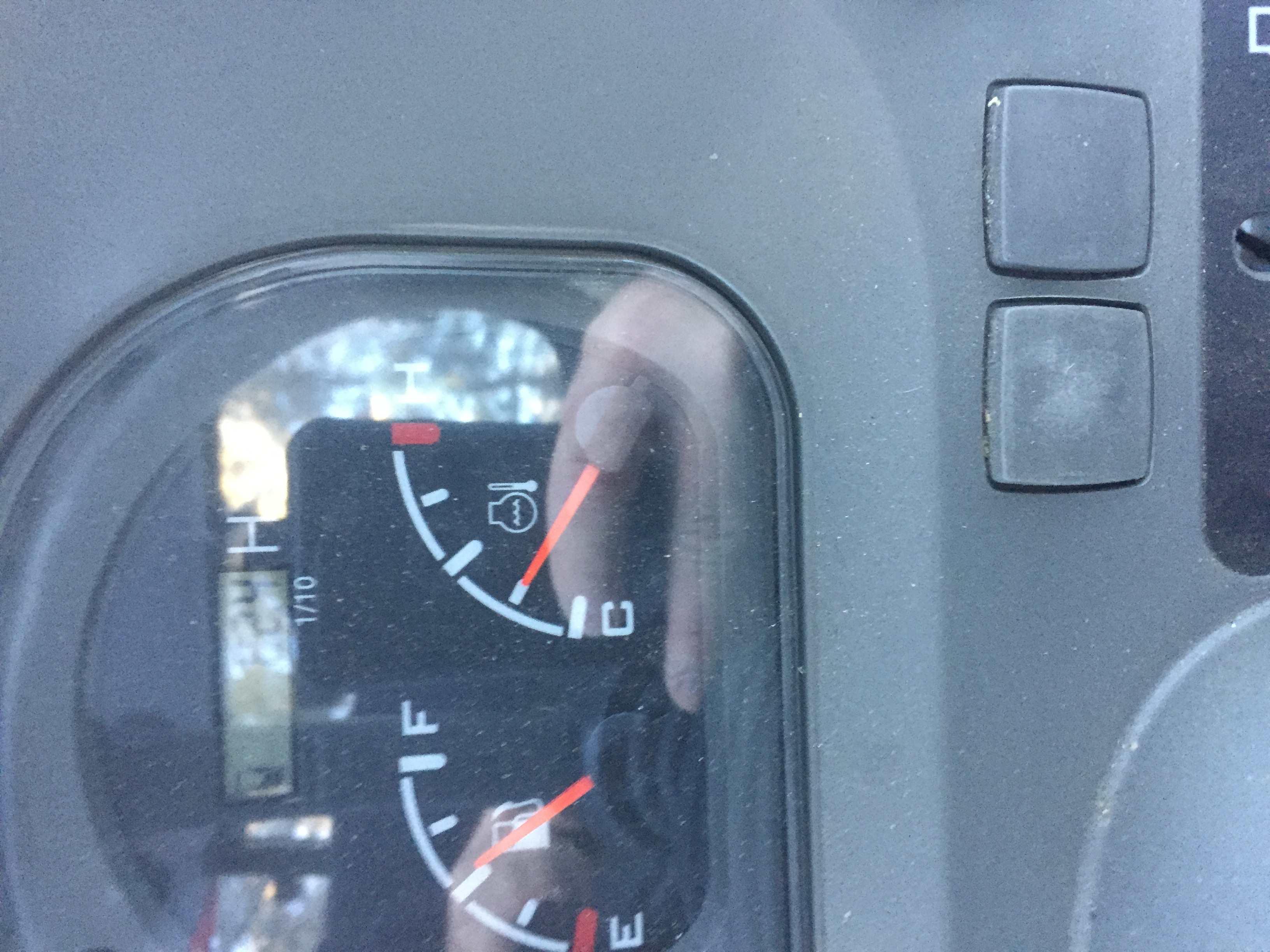

2555. 18* outside. Full rpm with pto running for about 20 mins. I don't know why the phone flips the pic?

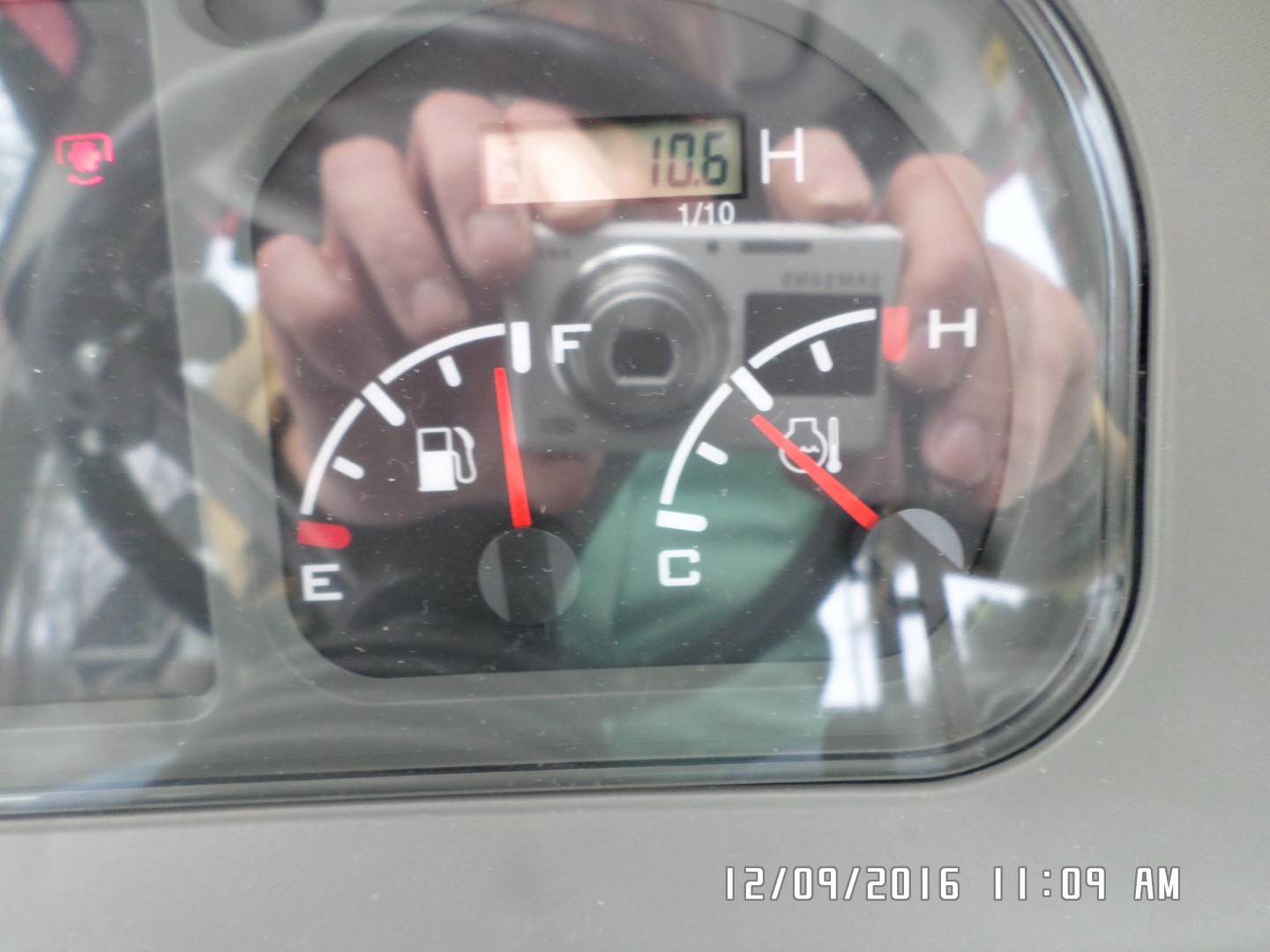

Oky doaky... had mine out blowing snow today, about 20 degrees outside. Temp gauge went up to 1/4 like your picture when I was warming it up, soon as I started working went up to just below 1/2 way and stopped, probably thermostat set point. When I got done, and was idling cleaning up before returning it to barn, it went back down to 1/4... good 'nuf fer me... [ note, I have a 12" holed sheet of plastic installed front of the radiator ] Tried to catch a picture with the super bright orange LED emergency flashers lite up, but couldn't do it.......
