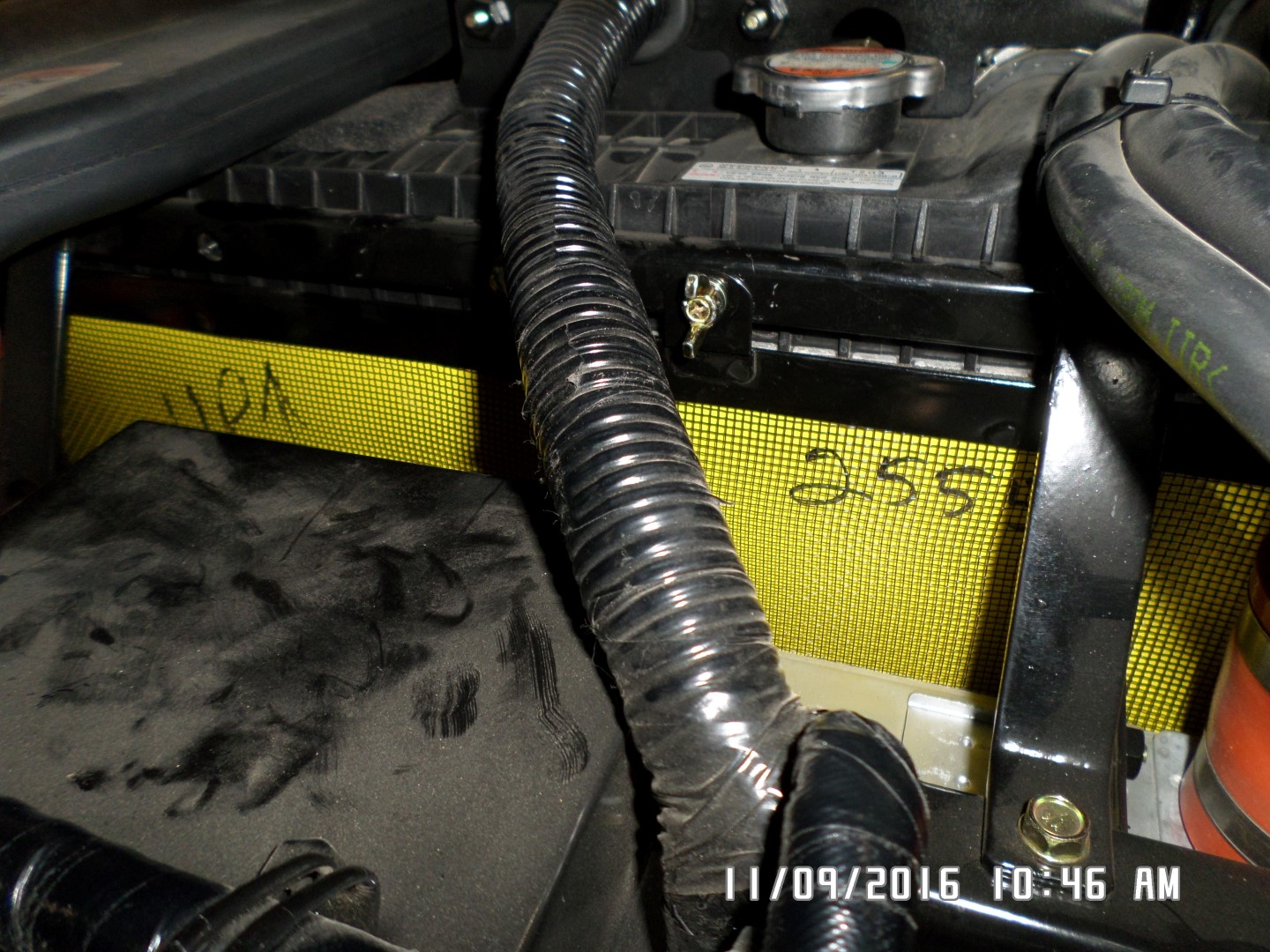

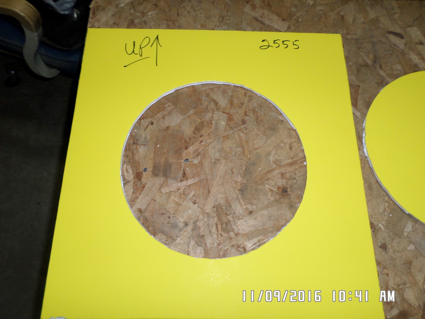

Used some foam sign board from the Wally, little over three dollars with Michigan tax. ' My ' dimensions were 18 3/4" wide by 19 3/8" to inside the foam the screen sets against right up against the aluminum radiator core. I put a 12" hole centered 9" up from the bottom, which centers it on the fan. The stock radiator area is about 363 square inches, and this cuts the area down to about 113 square inches. The foam should be soft enough that it will not harm the aluminum core structure. Anywhilst, I give it a try if and when we get some snow...

I think your hole is going to be to large. I made a 7 inch hole and I'm seeing about 2/3rds of the results I wanted.
/ 2555 running cold #29
Might be, can't tell until I get some snow to work it. If your 7" hole is forward of the screen, the fan can suck a lot of air around in behind the screen... plus crud... Putting it against the radiator corralled by the foam [ factory installed to help seal the screen ] pretty much keeps air only being able to go thru the center hole, and keeps the screen in play to stop bigger leaves/chaft/etc. It's all theory at this point... We just have to keep at it and find a solution. :)
