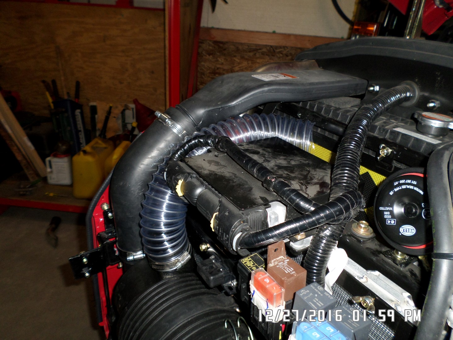

Mine is a 2016. I run a piece of Wally sign board witha 9" hole cut in it which is centered on the fan. Since this cuts the HUGE amount of air being pulled thru the radiator, it also limits some of the snow that is being sucked into the battery/air cleaner compartment. I also mod'd my air cleaner with a piece of 2-1/2" sawdust vacuum tube which terminates up near the top of the radiator. This gives it a snow free area to suck air, and the air cleaner does not fill with snow like it originally did when snowblowing. I had to relocate the horn to be able to run the air intake hose upward, but that was no problem. I am GOLDEN now... snow fears me... :)
