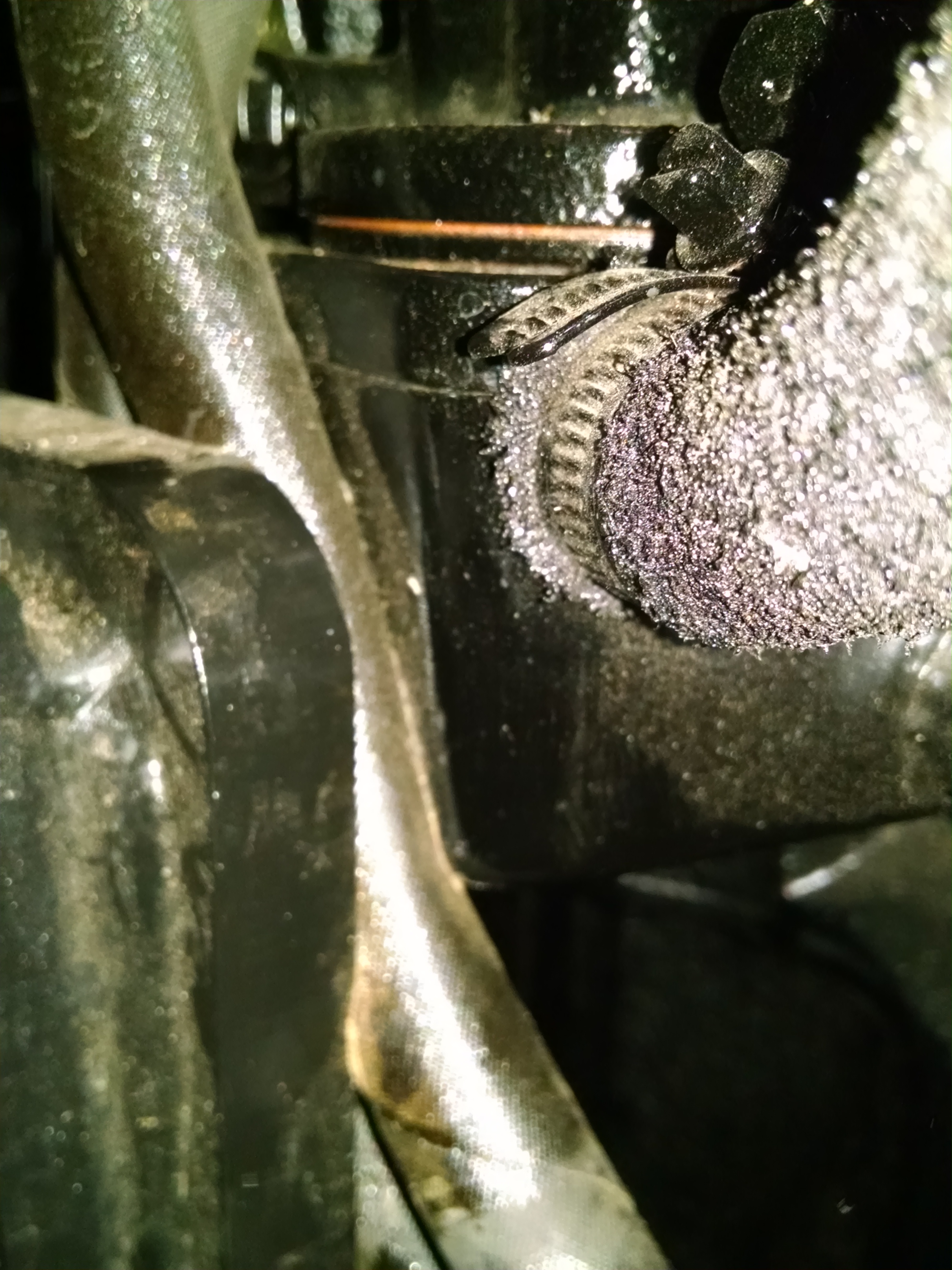

5/8 BOLT
CUT TO 1 INCH LONG
Drill 5/16 HOLE insert into hose, clamp down
3/8 OR 7/16 (Not sure on which bolt, make sure it fits snuggly into interior of hose
Cut to 1 inch length
¼ INCH HOLE DRILLED THROUGH , use hose clamp to securely hold restrictor into hose
/ 2555/2565 EGR system issues. #29
HERE IS PIC OF THE LINE RESTRICTOR SHOULD BE INSTALLED On Outside Hose going into *Engine oil Cooler* Pm if you have any questions on this improvement :thumbsup:

The restrictor mentioned is not for the 2555/2565 model tractor.I just confirmed that with my DSR. Your probably working on a 3500 series tractor that has a bypass @ the gooseneck. These tractors are/were having temp/heat issues.The issue with the 2555/2565 is there is enough air being drawn in and blown over the engine in cold weather to prevent the engine from getting hot enough to open the thermostat. Mahindra has no cowl change in process but there is a dealer experimenting with a bra to restrict the air flow.:thumbsup:

the coolant restrictor can be used in a 2555 that is under temp, although not a huge improvement will be made by this. I have a picture of the air restrict bra ...that may help. the programming update solved the rich running conditions slash egr problems for us. :thumbsup:
