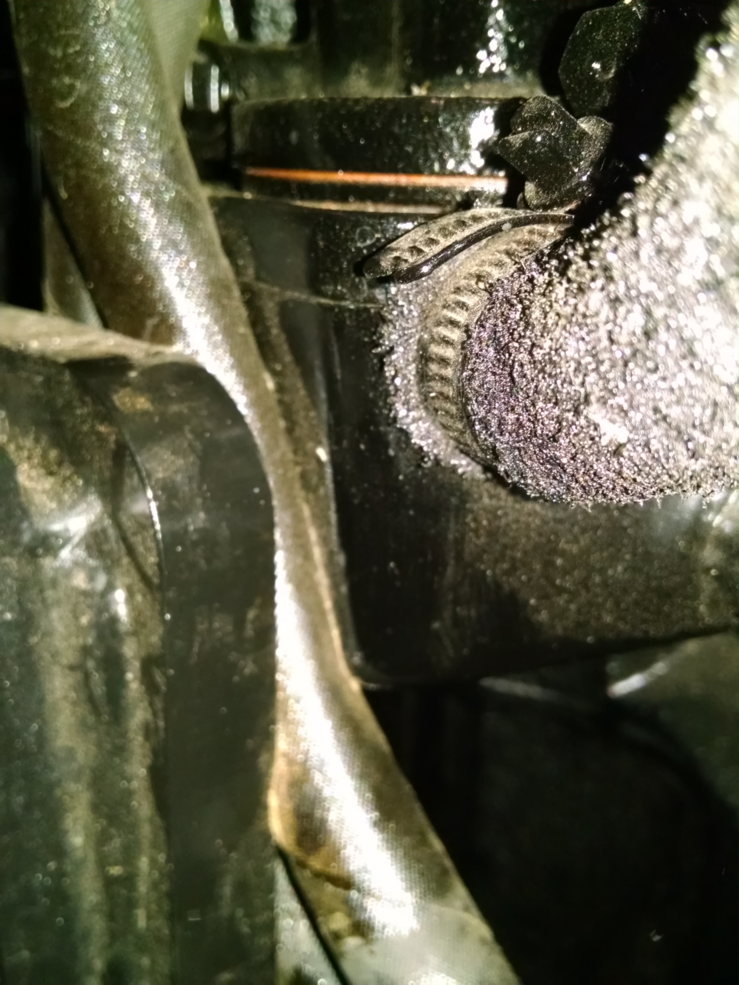

Are you sure its wet and unburned fuel. The first time I pulled the EGR valve I thought it was wet with fuel too. Further inspection revealed it was just shiny like gloss black paint.It fooled me!:confused3:

<img src="http://www.tractorbynet.com/forums/attachment.php?attachmentid=464458"/> THIS IS THE EGR COOLER
I'm no mechanic, but I stayed at a Motel 6 last night and those pics don't look good. But hey it's just my opinion. Wonder why there is that much unburned fuel there. Can't be good for the exhaust system. Hopefully they figure it out.

jabonee can you look at the pictures above and give me your expert opinion. were a dealer any new ideas?
I'm no expert. This is a learning curve for me too since I have a customer with a 2555 and is having EGR issues. The EGR cooler problem is easily checked. Perform a cooling system pressure test. It should hold rock steady for hours. As far as I know that issue has been resolved by the manufacturer. The EGR valve wet with fuel/sooting up is another unresolved issue. The one I pulled out looked wet too me also but closer examination revealed it was just shiny black deposits best described as gloss black paint. The Beta software is still a question. The unit I have just came back with another 20 hours on it after I replaced the EGR valve with the same complaint. MIL light on. Of course when I got It at the shop the light was out. That tells me that the tractor is idling too long.:confused2:
