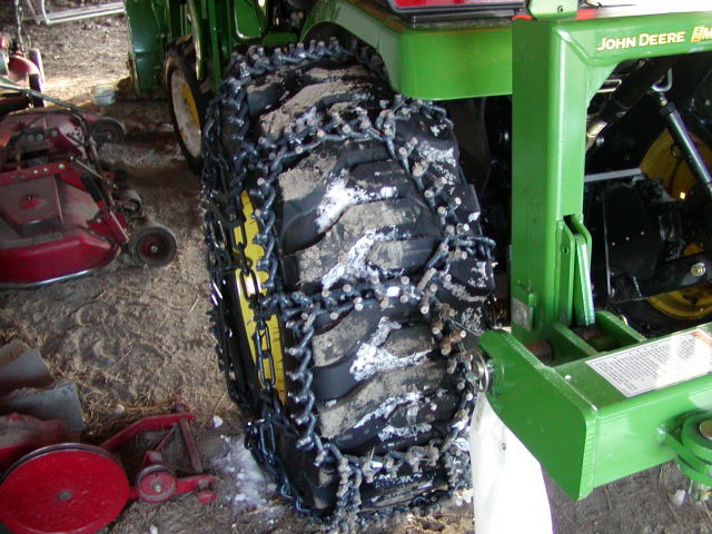

With these chains on just the rear, they stick like glue even on Ice. However, I learned that we don't get enough ice to justify dealing with the very heavy chains. So, I would let mine go for half price (original cost was $500) if one came to Montana to get them.

Those are tire chains look quite nice and appear to be the same type I had on my Kubota. I did buy chains yesterday - front and rear. The dealer removed the front wheel spacers and told me they won't work with my rim/tire size.
I bought some small 2 link garden tractor chains for the front that don't come down too far on the sidewall. They look like they'll be fine. I got some very robust chains for the rear.
