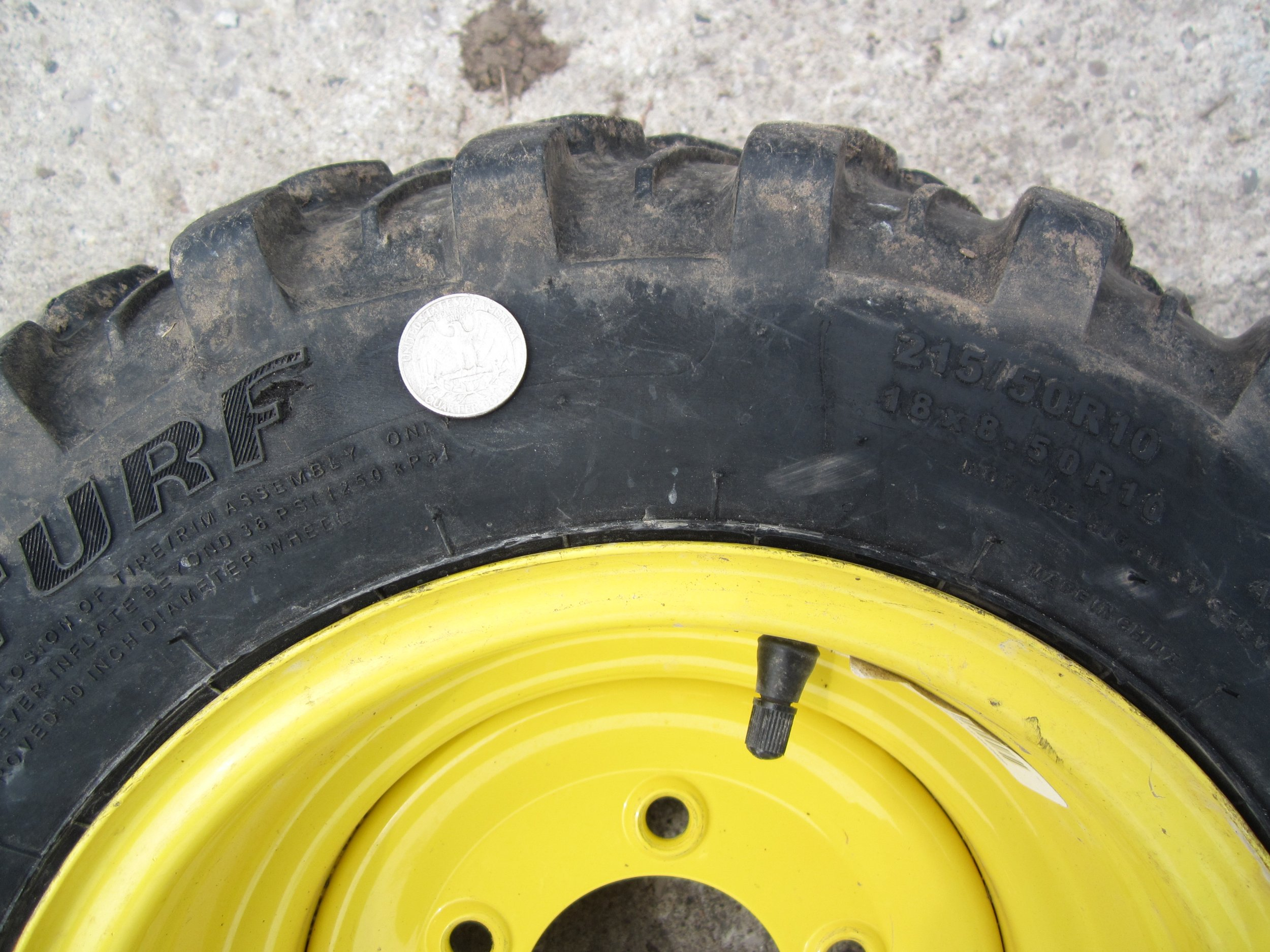

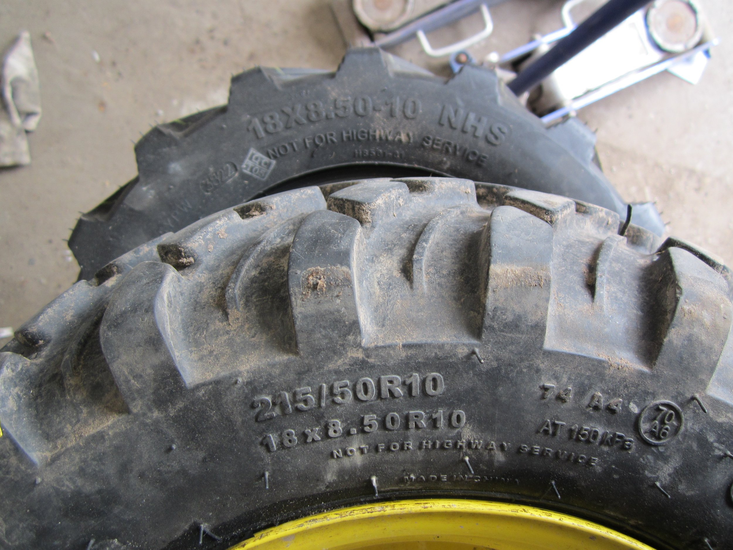

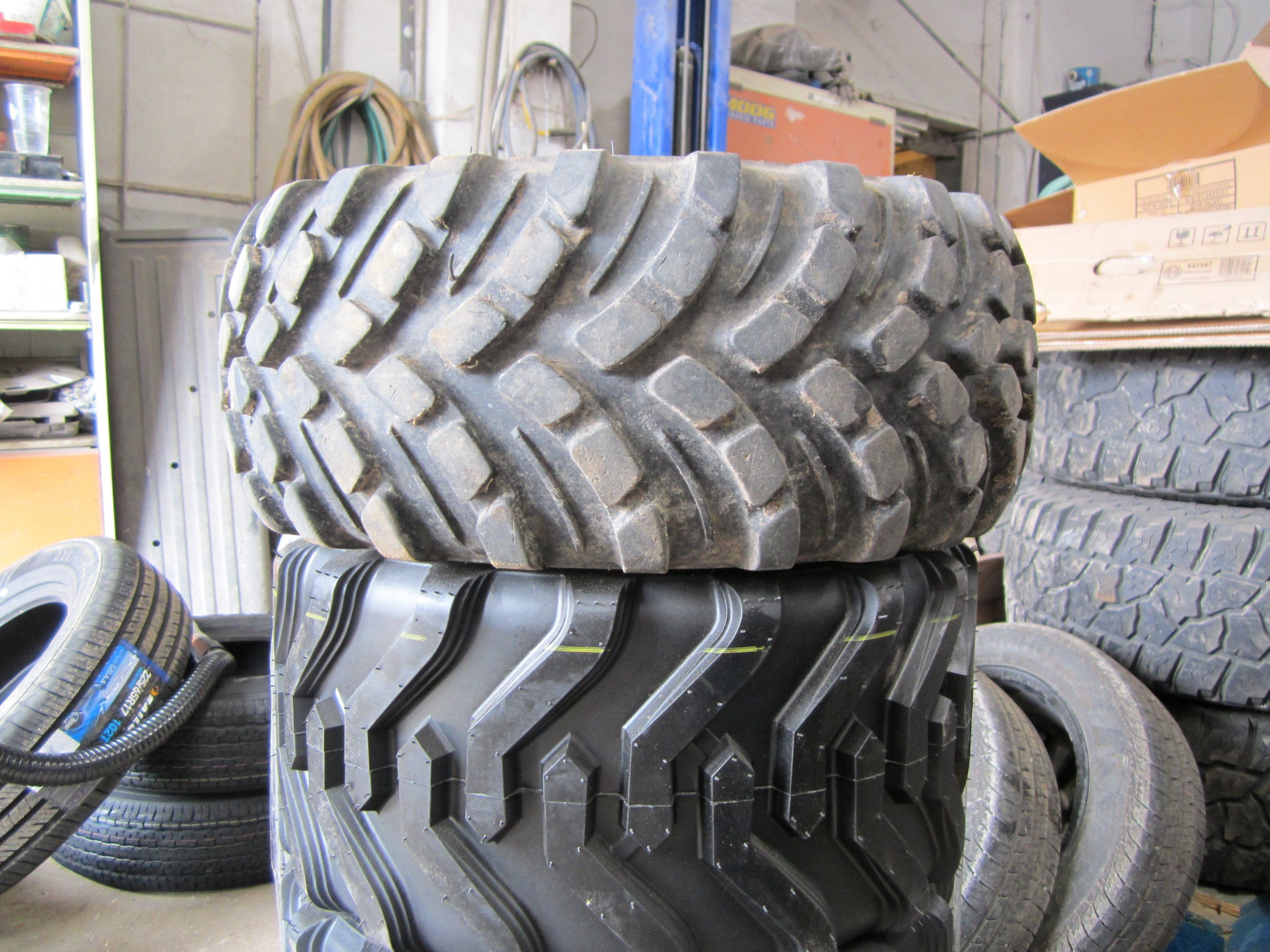

Well... The plot thickens...
My local tire dealer ordered replacement 6 ply, 18x8.50-10 tires for me. It didn't work, they're wrong:
Same nomenclature....
We agreed that my tire is inflated, and the new one's not, but the diameter is not going to increase 3" when that 6 ply is inflated on my rim!
So he patched my leaking tire on the inside for a temporary repair. In the mean time, the other front tire is on its way out....
So I guess I'll go tire shopping with a measuring tape!
