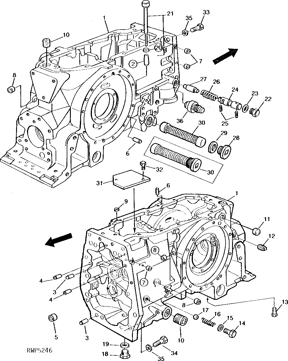

If your loader has an ind hyd control valve it should be a closed center valve and attached to tractor similar to photo. How long since hyd filter was changed & sump screen(parts key 30) checked/cleaned? Has hyd stand-by pressure been checked? It should be 2250-2350 psi.
